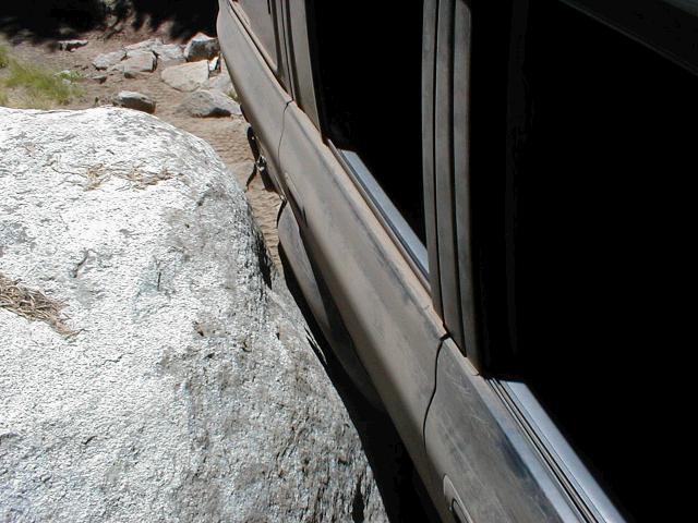

Thanks for the 411 on the trail. Anyone have shots of the real tight sections? I would like to see what a square peg looks like in a round hole.
Jim:
Thanks for the 411 on the trail. Anyone have shots of the real tight sections? I would like see what square peg looks like in a round hole.
Tare, there are literally places where I couldn't open the door to get out to take pictures. I called it jail.

Funny... I was spotting him and telling him piece of cake, still room to spare. :skull:
NOTE: if the spotter has a camera in his face he's more interested in taking pictures than protecting your body panels.:flipoff2:

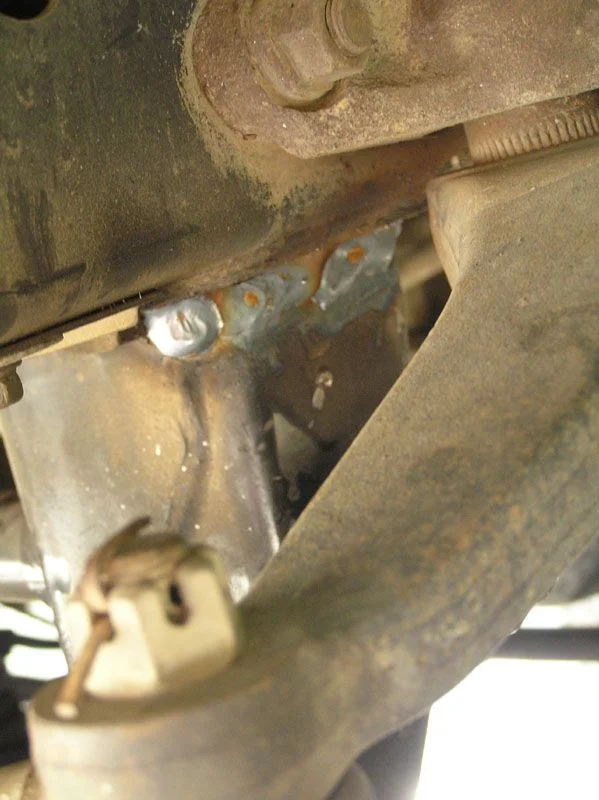

Well, I went out and checked....and DAMNIT you people seem to make more work for me than I am willing to admit. Let's just say this weld in the pic will soon be appearing in a similar place on my truck. The stock weld is cracked and will fail soon. I am welding it up next week (not driving it).

If you wheel your 80 hard, keep an eye on the front upper panhard bracket weld. Luke redid the welds on mine. As far as the sector shaft, I would change prophylactally.
