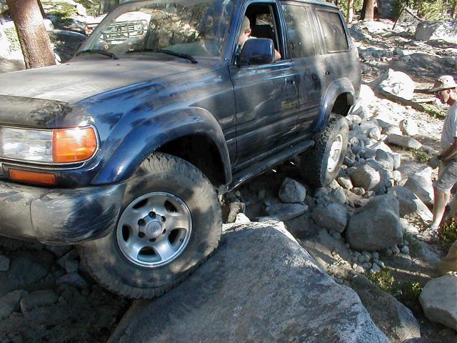

"Not so Big" Jeff gettin it on the Dusy in 2004:
Check out those "hard core" BFG ATs...
