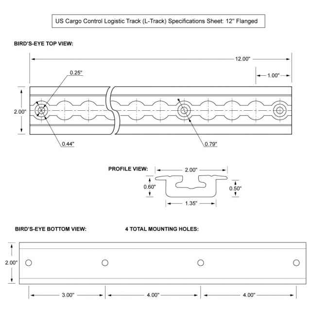

The tracks and tie downs are from US Cargo control. They come in black. The end caps are my design.
