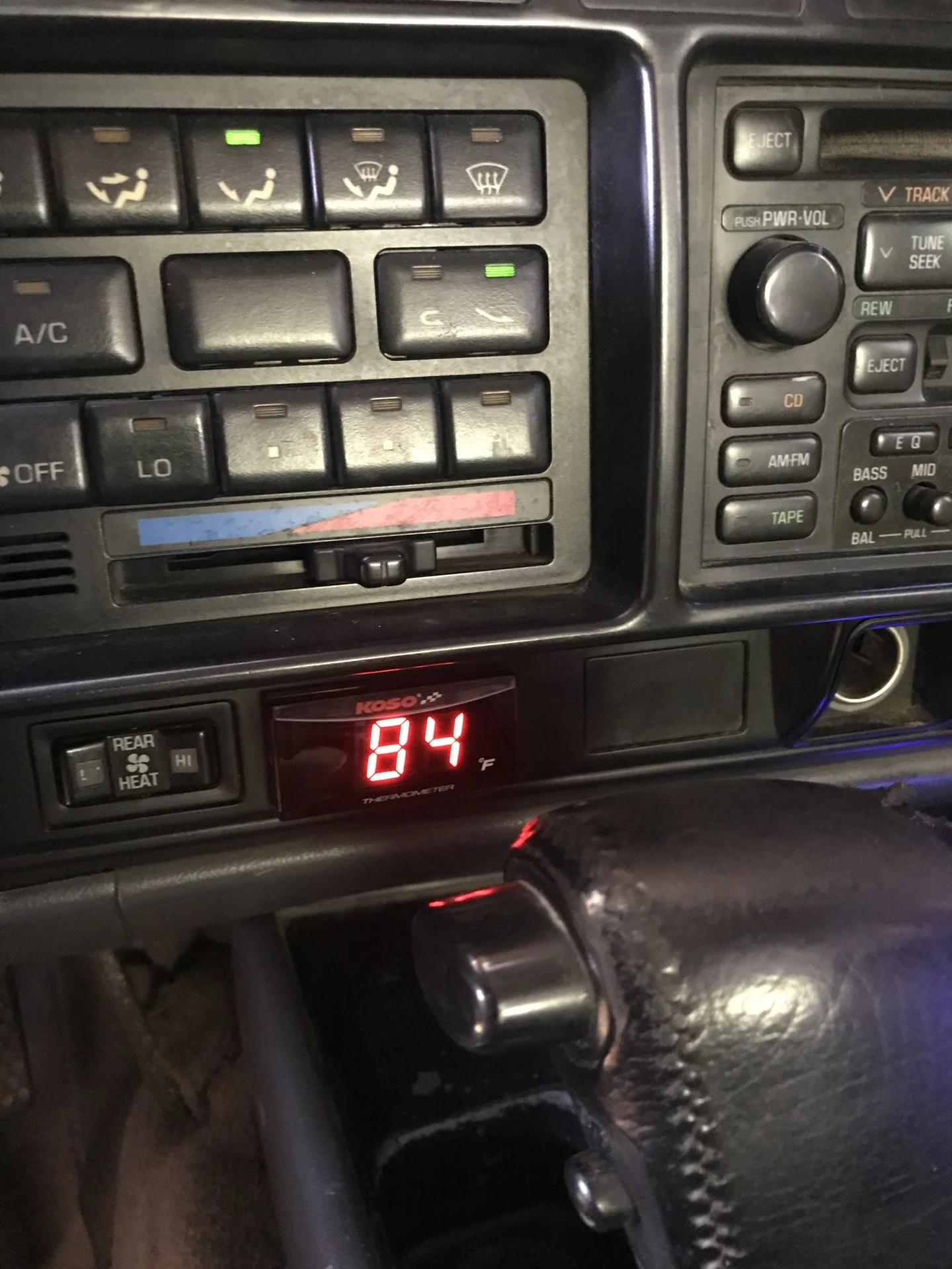

I installed a Koso water temp gauge a few months back when i installed my new factory radiator. Today i decided to do a little test. So i watched my factory gauge as the water temp started to warm up.
At a temp of 135 degrees showing on my Koso water temp gauge, my factory water temp gauge had moved to the center of it's travel.
As i drove around i watched the factory gauge for movement. The reading on my Koso gauge ranged from 189 degrees while running down the freeway, to 207 degrees while waiting on a train at a railroad crossing. Outside temp today was 115 degrees in the shade.
From the time my factory gauge moved to the center of it's travel there was a 72 degree temperature swing on my Koso gauge. At no time did the needle on my factory gauge move at all. It stayed in the exact same place it was sitting when the water temp was reading 135 degrees on my Koso gauge.
So the moral to this story, if you're relying on your factory gauge to warn you when your water temp is getting hot, you may be in for a very rude awakening.
By the time that factory gauge moves to the red zone your engine may already be cooked! You'd be much better off spending 45 dollars to get a real water temp gauge, that actuality works, then ever trusting that factory gauge.

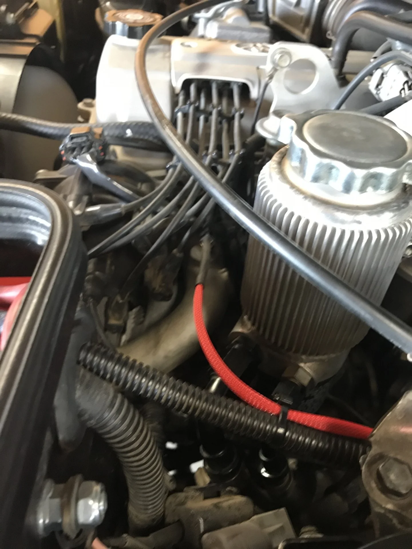

I’m Running the Koso, is seems to read a lower temperature the expected. But I live on the cost we’re it’s cool. I drove it into town and it never got over 192 with the Ac on and about 95 degrees out.
I ran it to to coolant out let pipe on the head
That should be the hottest place just before going into the radiator.
I well be able to check it out more on the trail next week at the Rubicon.
That’s the only time I have had it getting hot, on the trail with the Ac on, Vehicle not moving.
I have be using the Toyocom reader, but use the tablet for navigating as well.
Initial testing showed a large difference between Toyocom and the koso.
again well know more after next week.
If you’re running one of the Koso where did you hook it up and does it seem to read accurately ?
