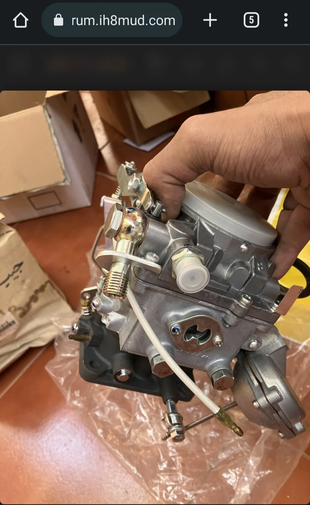

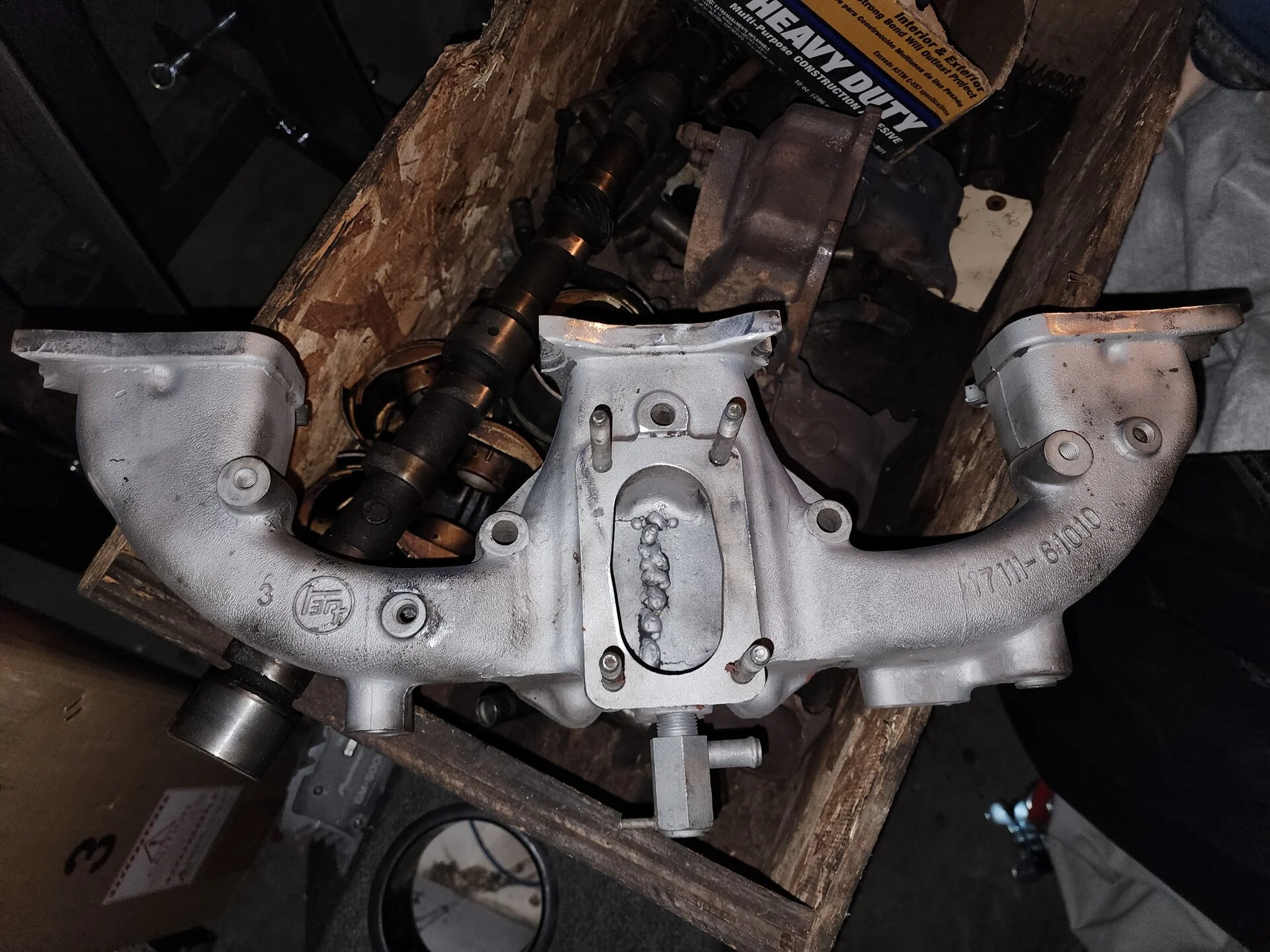

I just rebuilt a 1976 2F and the machine shop showed me my intake had been welded with a tasty weld bead right in sight (no leaks) but with an expensive fresh rebuild I want my Cruiser to breath and avoid any ashtma issues. Also, my exhaust heat riser flapper (technical term) leaks and I am looking for a new set. For my build I have a brand new foreign spec 2F carburetor (likely for an fj60 2F) and am looking for stock intake/exhuast.
Can I buy any 2F intake to mount my new carb on?
Thanks in advance Mudder Brudders!

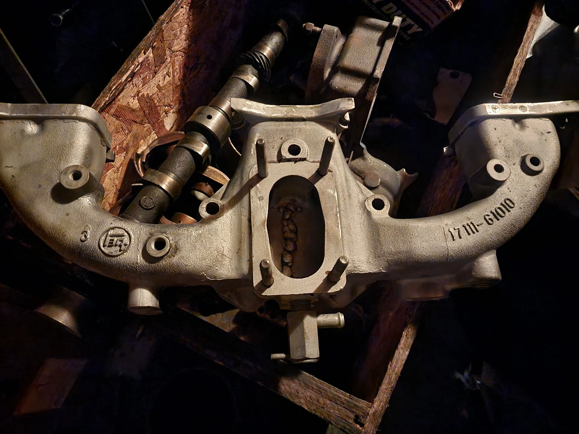

Engine before build.

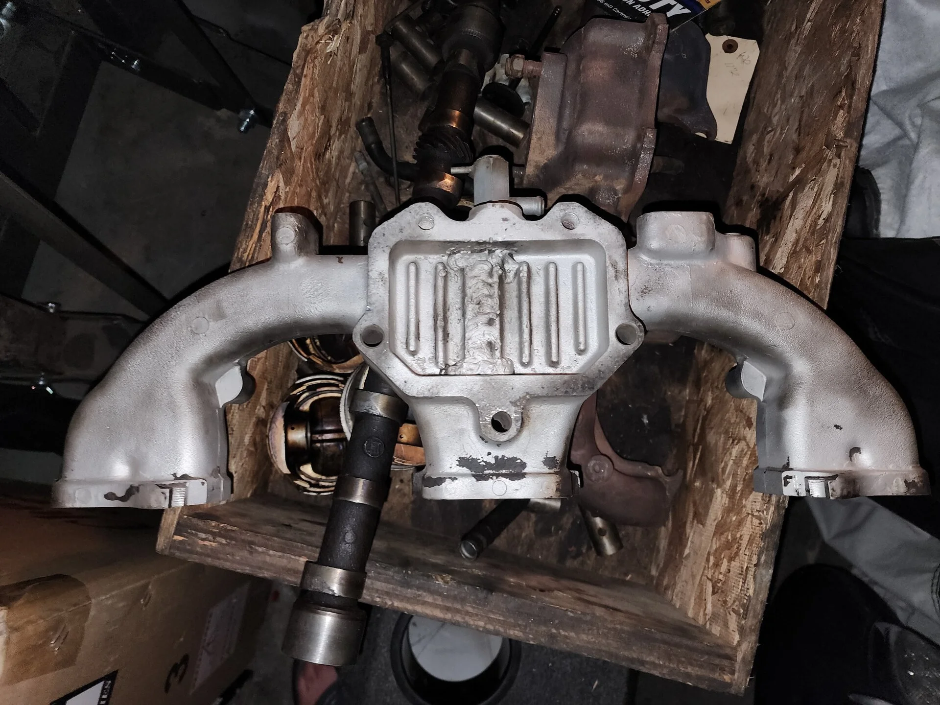

Current state of my intake. Doesn't leak but that weld bead looks really. After rebuilding an engine I would hope to have "relatively" unrestricted air flow.... Yes I understand these are tractor motors and not hot rods but still...
After all of the money I spent on rebuilding the engine I'm tapped out and hoping to find an inexpensive option to work with what you all have seen here. The engine is a '76 and I had to sell my first born to afford new domed pistons for it. Currently, I can find a rebuilt combo for $1200 but I'd have to save for another dang year to come up with that money to finish build. One other thing to note is that I will be running a factory PTO and from my research (not personal knowledge) headers won't work with anything but the stock exhuast. Anybody know different? Any tips or people with good cheap intake/exhaust combos for sale would be much appreciated on this. Thanks gents!
