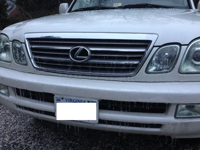

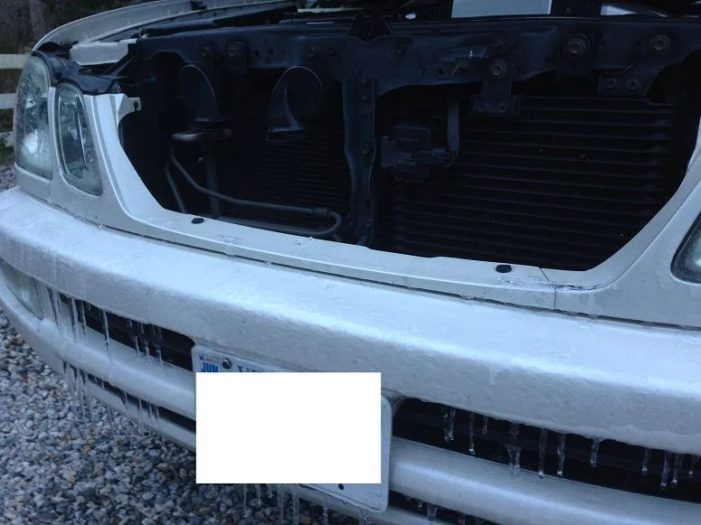

Thanks. It does look like there is a slight step it the lx also. Either way I think the lines will complement both. As you can see I'm only talking about a 1/8-1/4"
Notice the straight edge.

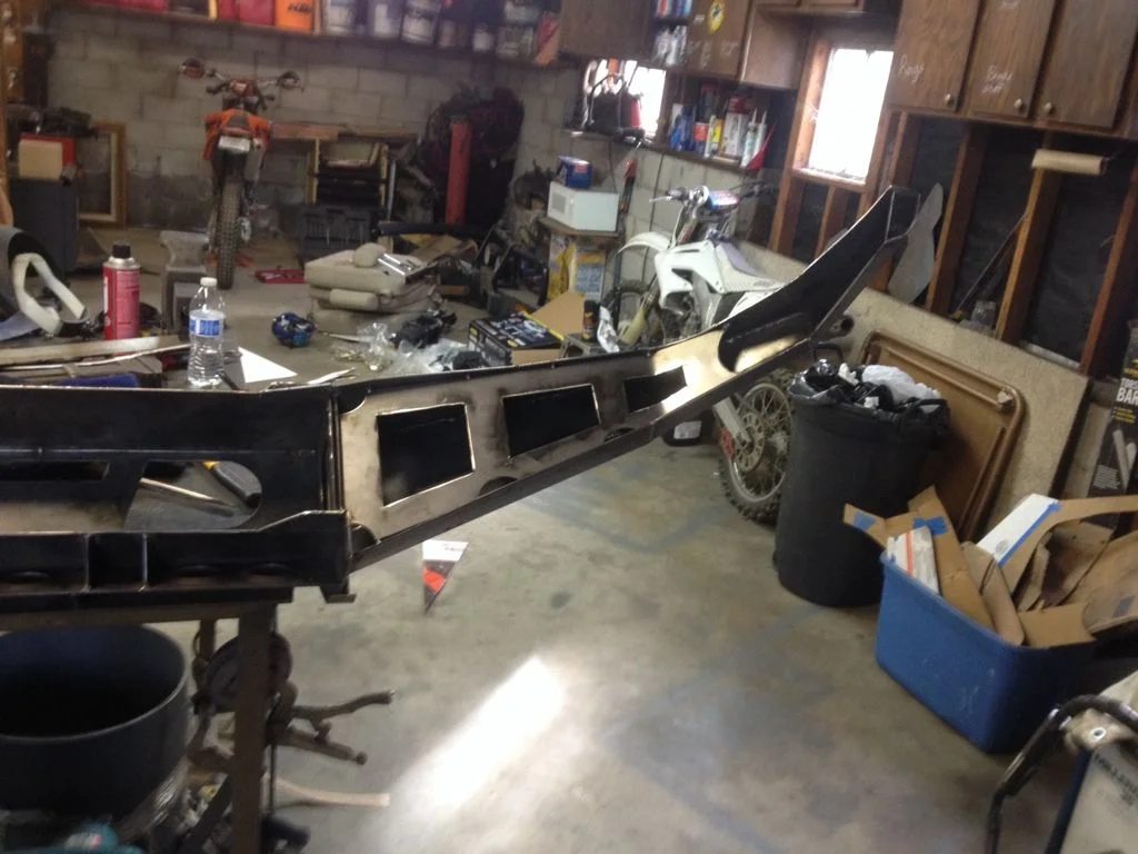

Nahhh! I"ll stay! Question: I remember you said something about using 10 gauge (close to 1/8) in place of 7 (3/16).
Was that for the whole thing or just parts of it? Reason for it? Do you think building the wings out of the thinner steel will be able to still withstand the trail abuse? They already have a pretty small total diameter towards the ends and I may be wrong but it would suck to land on a rock and see the wing all bent up! BTW they look great like that, don't make them bigger.

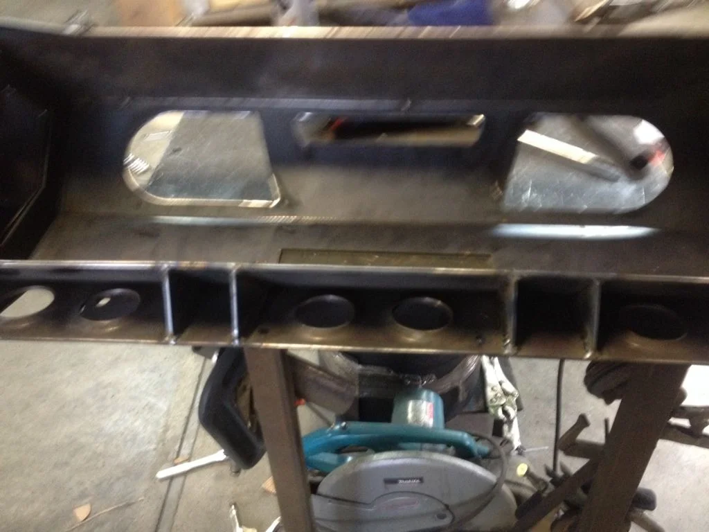

Yes they are all 10ga. The main reason is weight! And also some guys do not have the ability to weld thicker than 1/8". These rigs are already heavy enough as it is. There will be a combination of gussets and supports in several areas to assure they will withstand serious trail abuse. I have put a lot of thought and testing to come up with a design that is light weight and very stout. I should make good progress tomorrow and will get some pics of the various gussets.

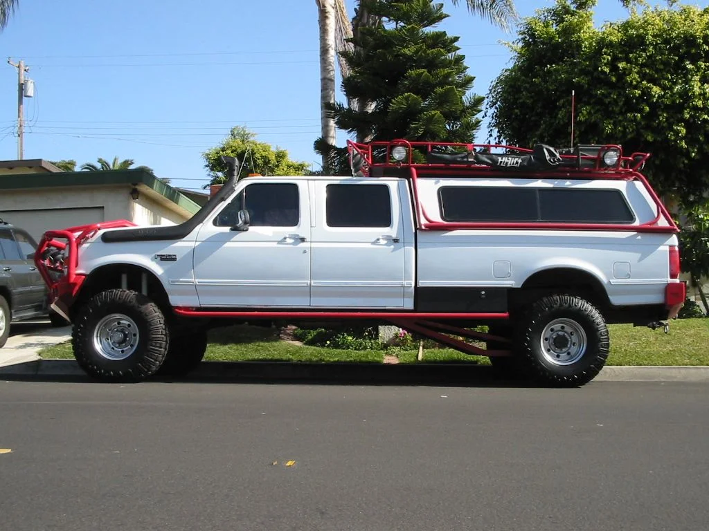

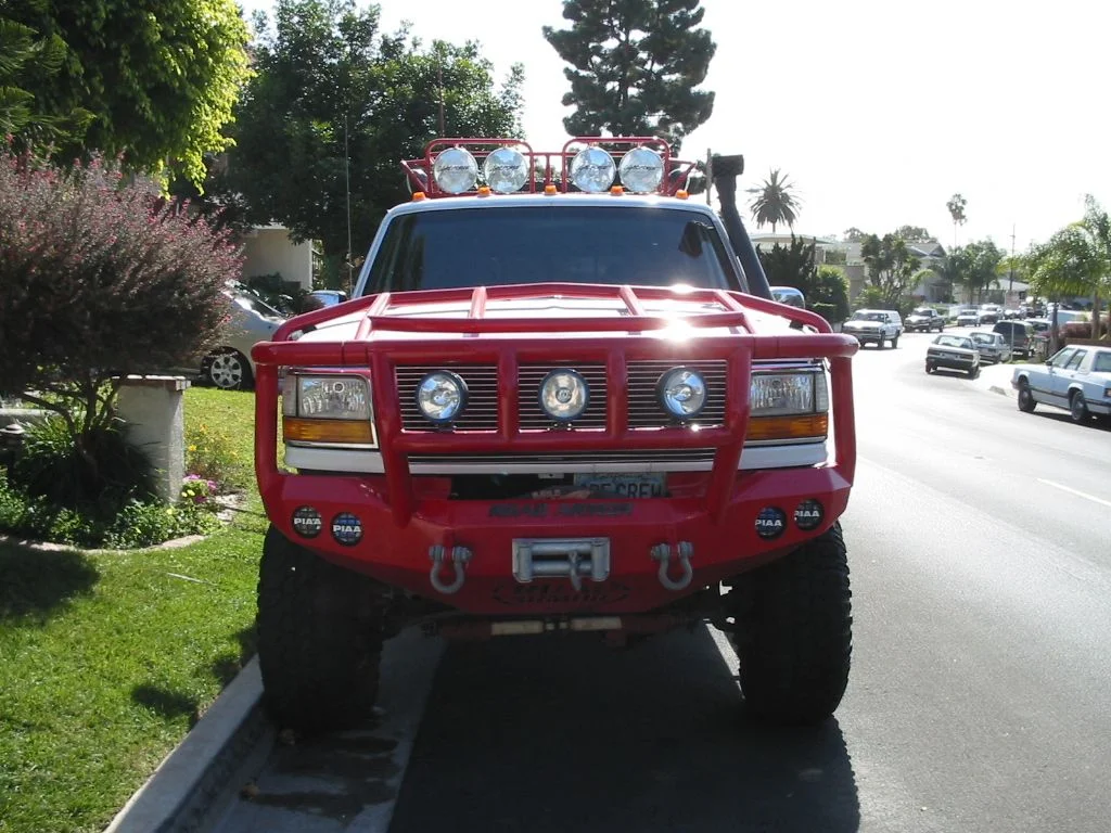

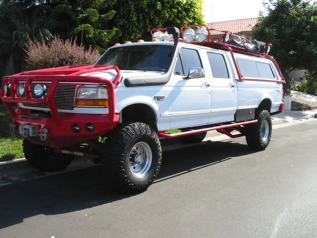

I have the JD Squared Model 32 and I love it! I did an entire over the (camper) shell rack for my last F350 Crewcab expo vehicle.

Here are a few pics of wing gussets and winch gussets

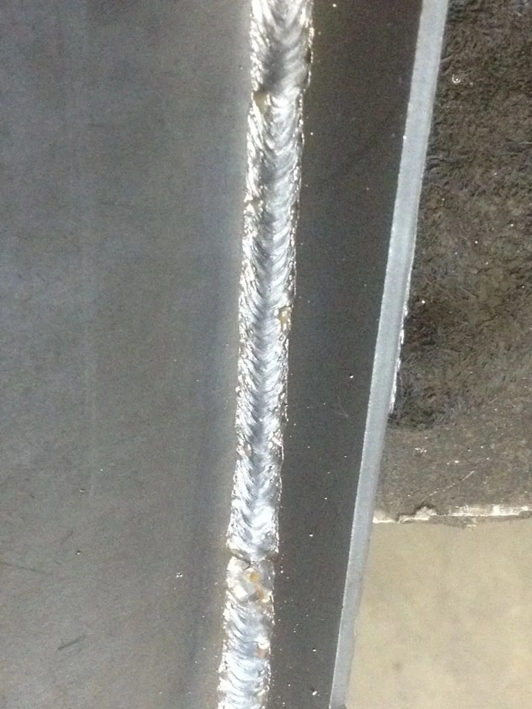

Picked up the new welder last night and man is it smooth! Should be able to get you guys some nice welds now. The first weld I laid out of the box before cleanup.
