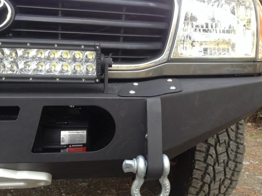

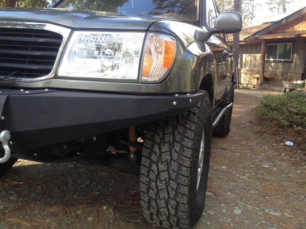

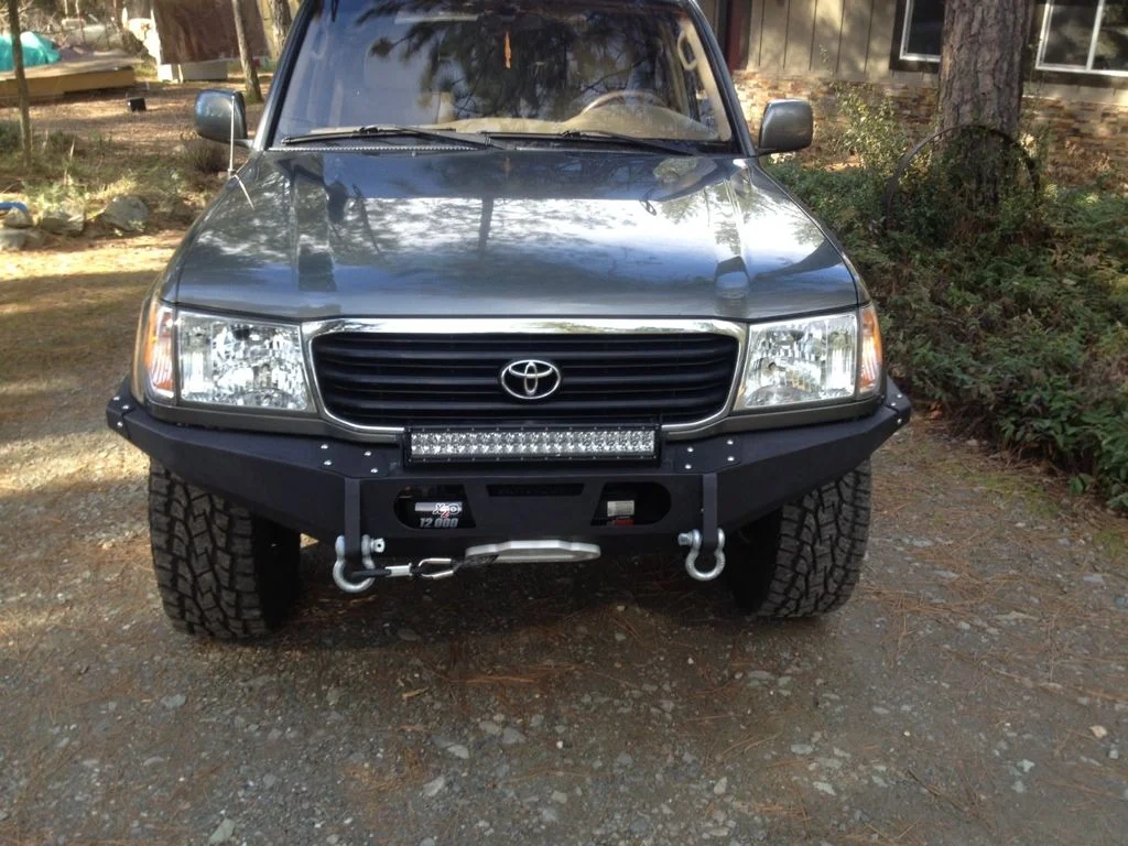

A couple pics after bath and some from behind so you can see the winch clearances. As you can see, there is room to spare.

Bumper is looking great! Post some pics when you test it on the 06 please.
Thanks for sharing all the progress pictures, it is a pleasure to watch the development of your project and our future bumpers.

Looks fantastic!

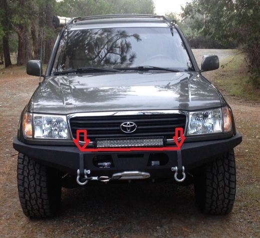

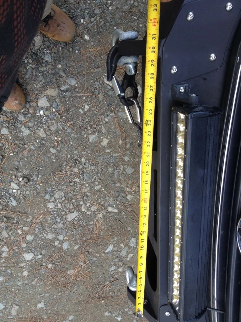

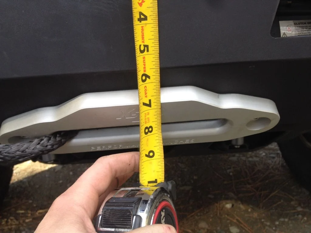

Can you get some measurements for the max length light bar at this location:
And the maximum square measurement you can get at this location?
And the length between these two points. Looks like a good place for me to mount my state required license tag.

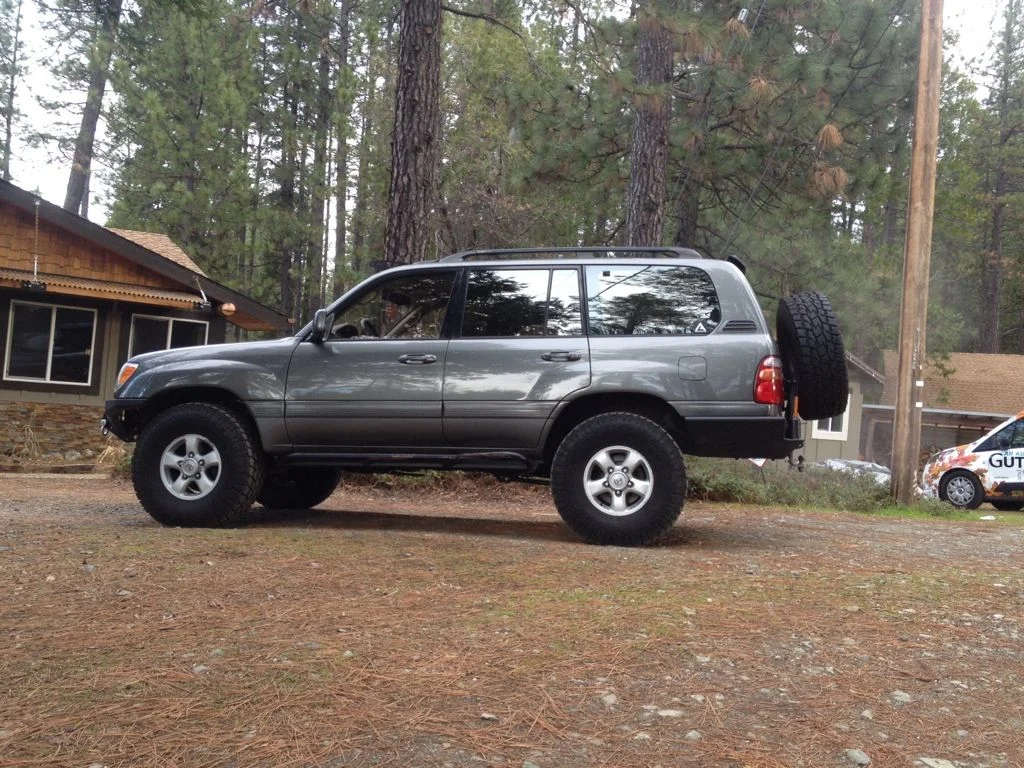

2) Please seriously consider making a rear bumper.
I concur. Do you plan on making a rear bumper?
If so, a couple of personal suggestions:
  1. Keep the spare tire carrier as close to the rear hatch as possible with out hitting.
  2. Keep the spare closest to being behind the drivers side, not the passenger side. I feel that the right rear quarter view is far more important than the view directly behind the driver. Yes I realize that may require a left hand swing-out or a lot of weight cantilevered on the end of a right hand swing-out.
  3. Do something for the Hi-Lift other than an angle mount on the back hidden behind the spare. I hate that look. Try horizontal along the bottom of the spare, just above the bumper, or vertical next to one of the "D" pillars.
  4. Have the swing-out be modular so a ladder, jerry cans, Hi-Lift, antenna, or what ever can be bolted on.
  5. And of course, a good departure angle with a 2" hitch receiver.
Just some of my personal thoughts.

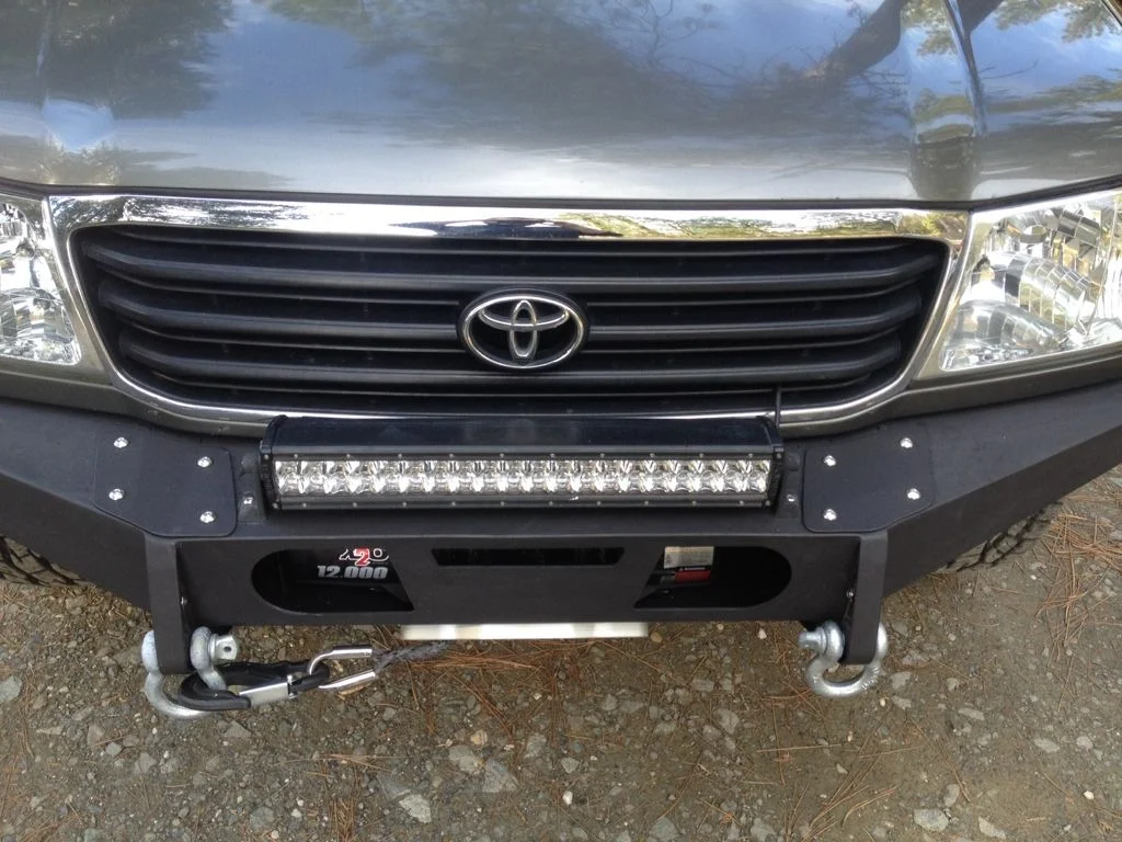

I've been meaning to ask, what brand/size winches will this bumper accommodate?
Are the large cut-outs in the front for running the winch? Or can it be accessed from above?
I may need to shrink the holes a bit to accommodate the license plate. There will be no winch access on the top since most guys these days run a light bar and top access would be covered. The bumper should accommodate any non integrated 12 k winch but you may need to build a bracket for the control box. Mine is a smittybilt 12k x2o and fit perfect with room to spare. The lager holes it the front of the bumper make it very easy to access the winch and the bolts for the grill guard and light bar. Something to consider for those who do not like the look. Here is some pics with a tape and the grill guard brackets.

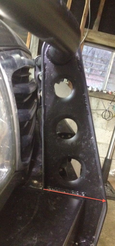

Thanks Nate for bringing your 06! I was not able to test fit but I got all the measurements I need. The only difference is the lower grill support does not allow the bumper to slide underneath the grill like mine does.
The only solution I can see with out cutting is to cut the top of the bumper to the exact shape of the grill and it be flush.

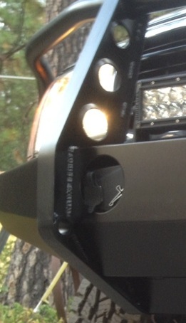

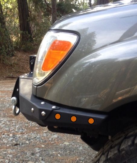

I'm most likely doing this with those cheap LEDs (or some better quality ones) but I think it would look pretty cool and help the turn signal that could be blocked by the guard tubing depending on the angle you look at it.
As for damage on the trail, figure I just buy some extras and have them on the shelf for when it happens! :meh:

Thanks Nate for bringing your 06! I was not able to test fit but I got all the measurements I need. The only difference is the lower grill support does not allow the bumper to slide underneath the grill like mine does. View attachment 1018738View attachment 1018740.

Yes I will have to change to accommodate those who want no grill guard. I may be able to somewhat keep that look so I'll keep you posted. Yeah, I think something like that would look good for the blinkers.
