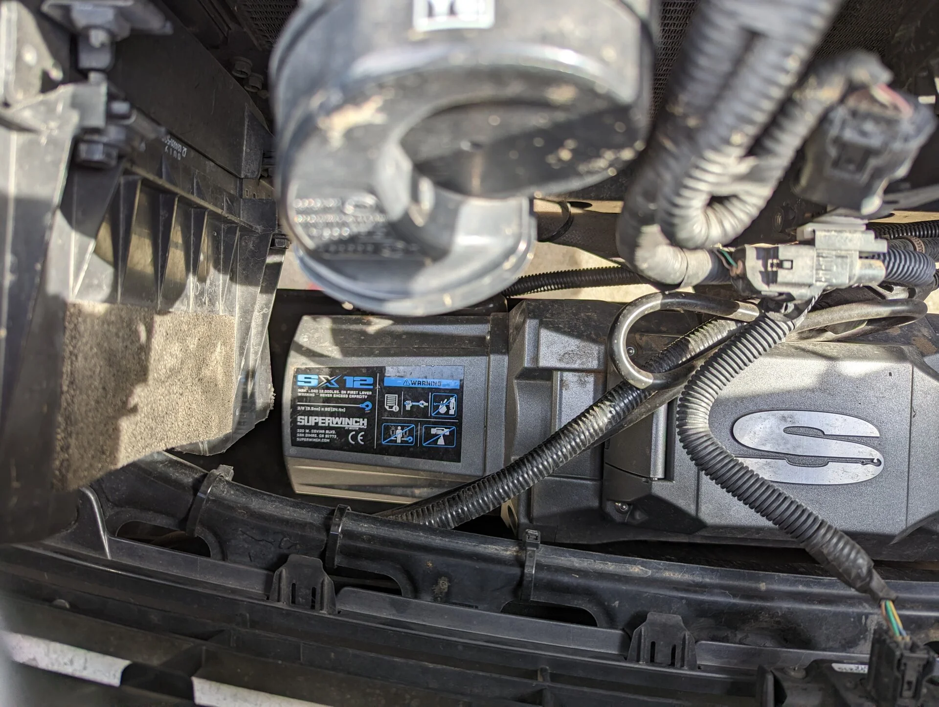

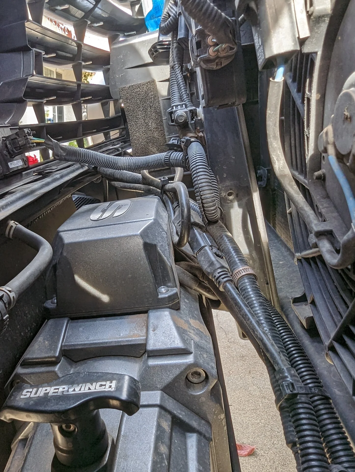

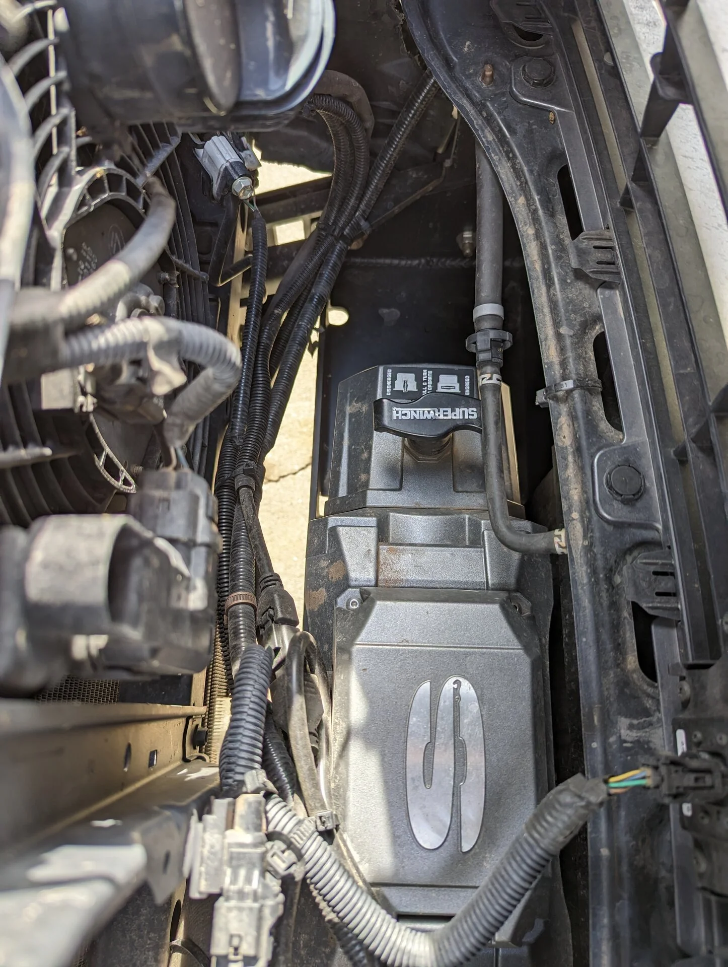

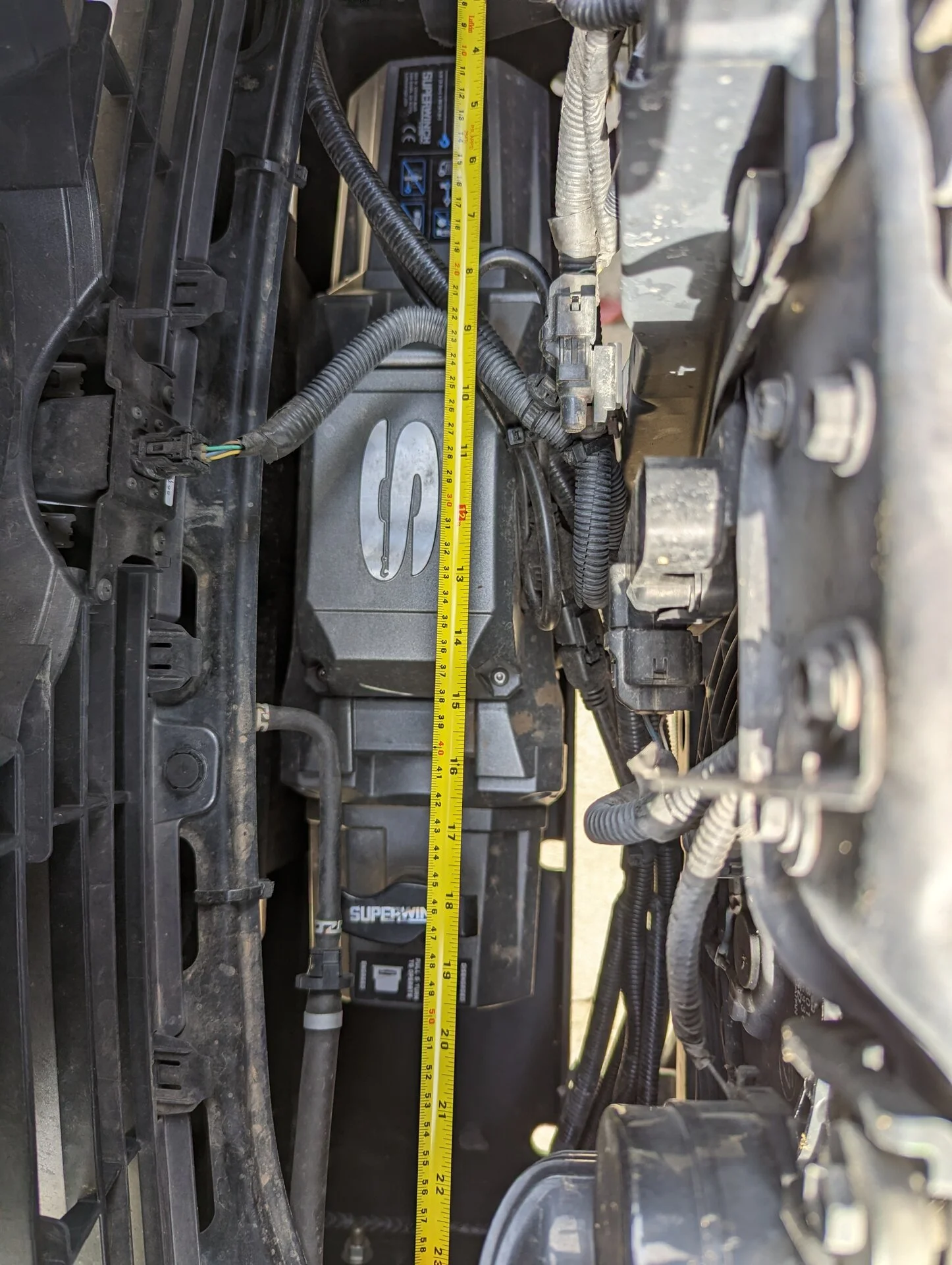

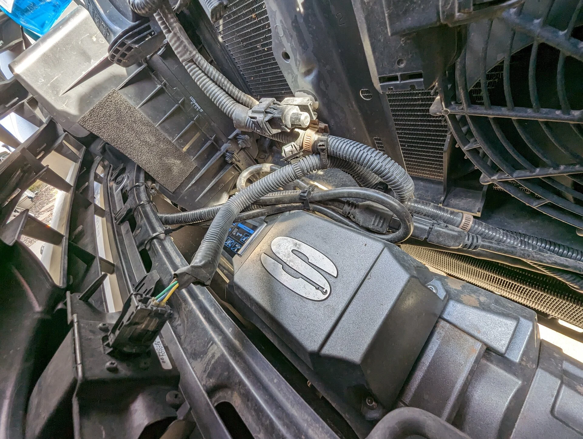

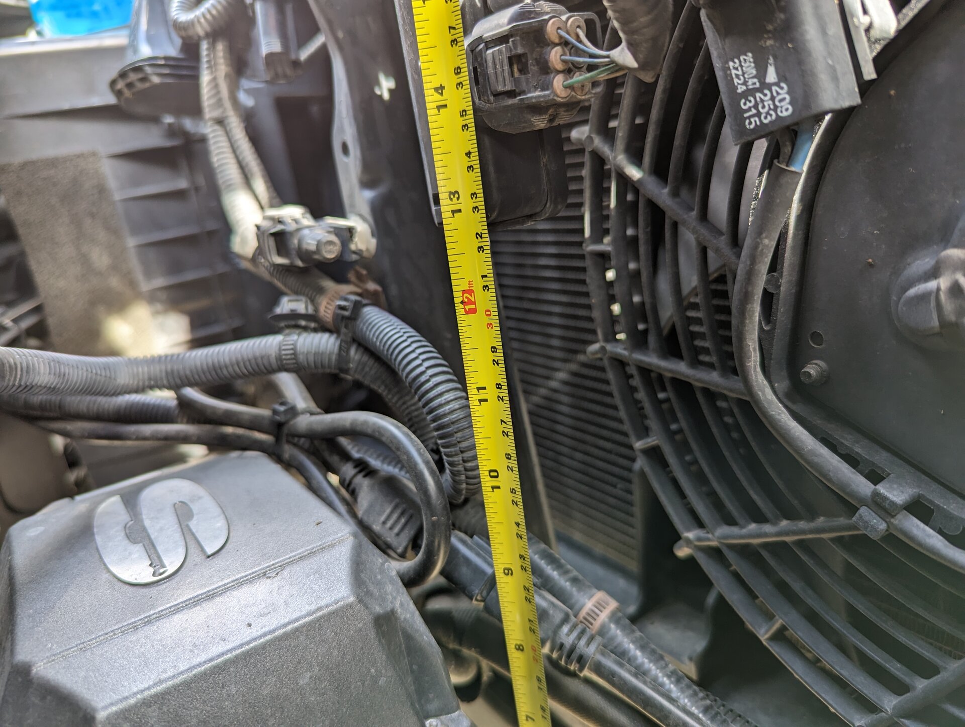

@teejnut Could you post a few photos of the winch/bumper mount? I'm going to be installing my Dissent front on my 2013 LX, and would be keen to see if I'll be able to squeeze the Warn EVO VR12000 winch control box in the top mount or whether I'll need to fab a mount.
Sure. Do you just want to see how much space there is for the winch?
Precisely. It looks like the superwinch is about the same dimensions as the Warn EVO VR 12000.
Kind of hard to take pics but here are some.
