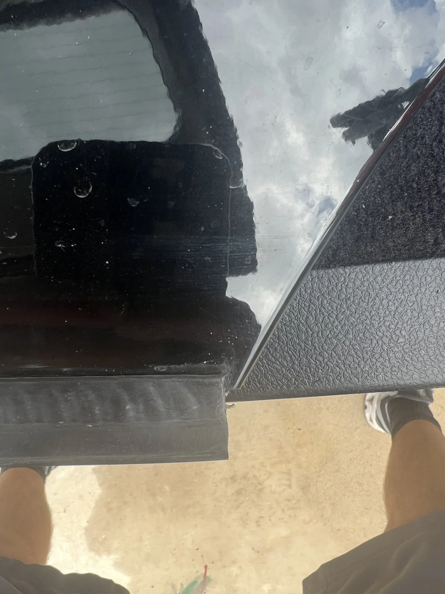

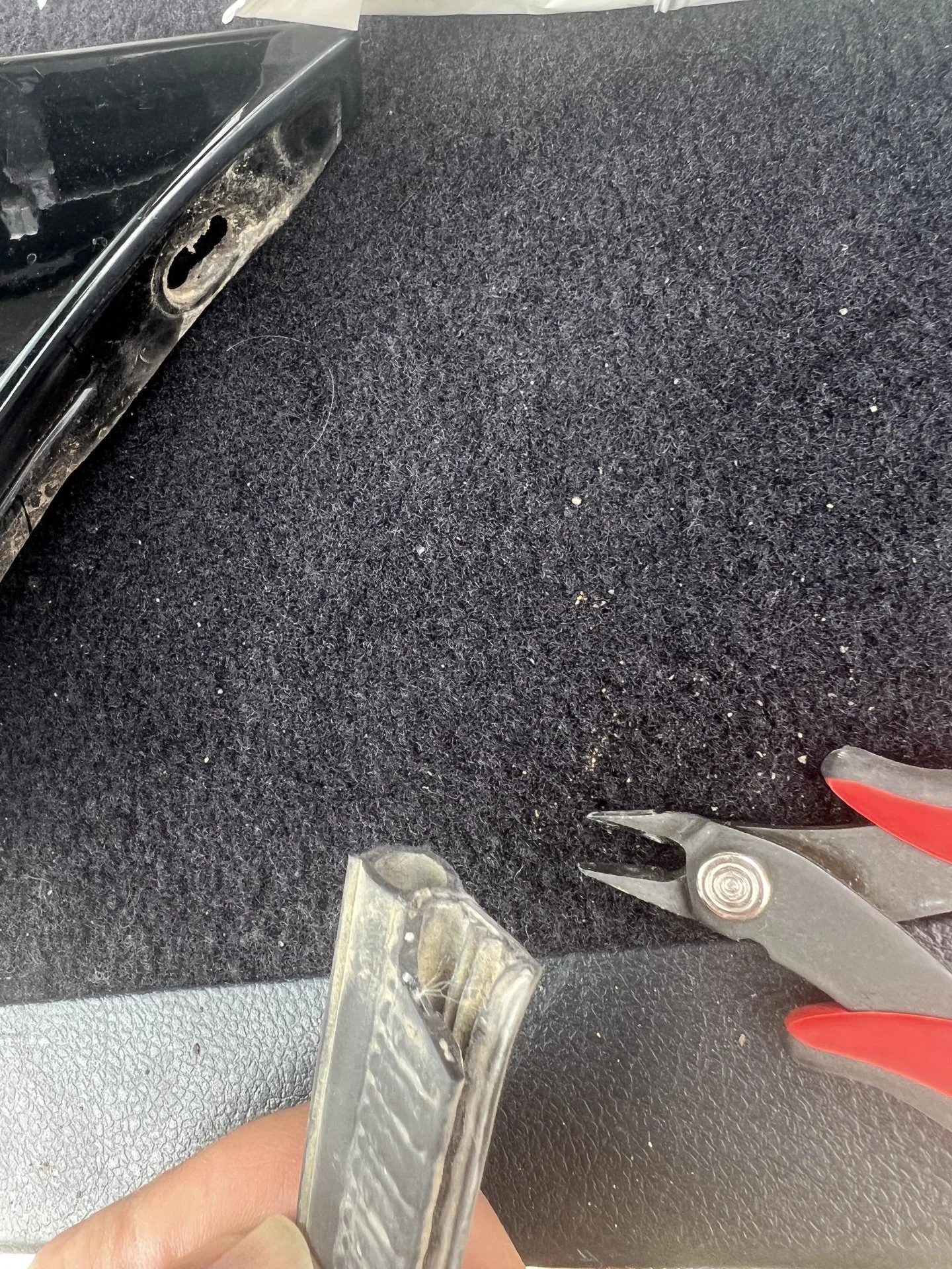

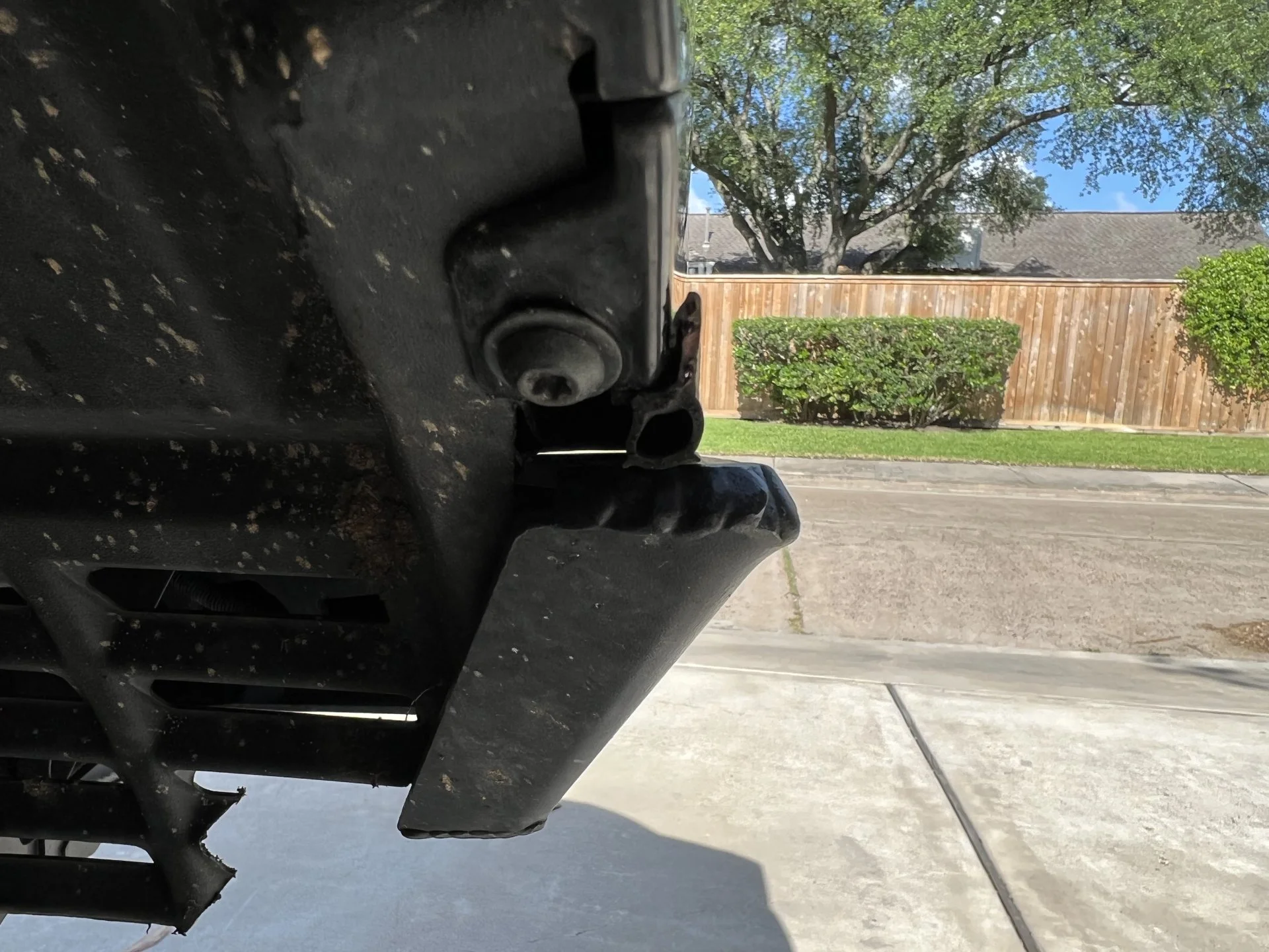

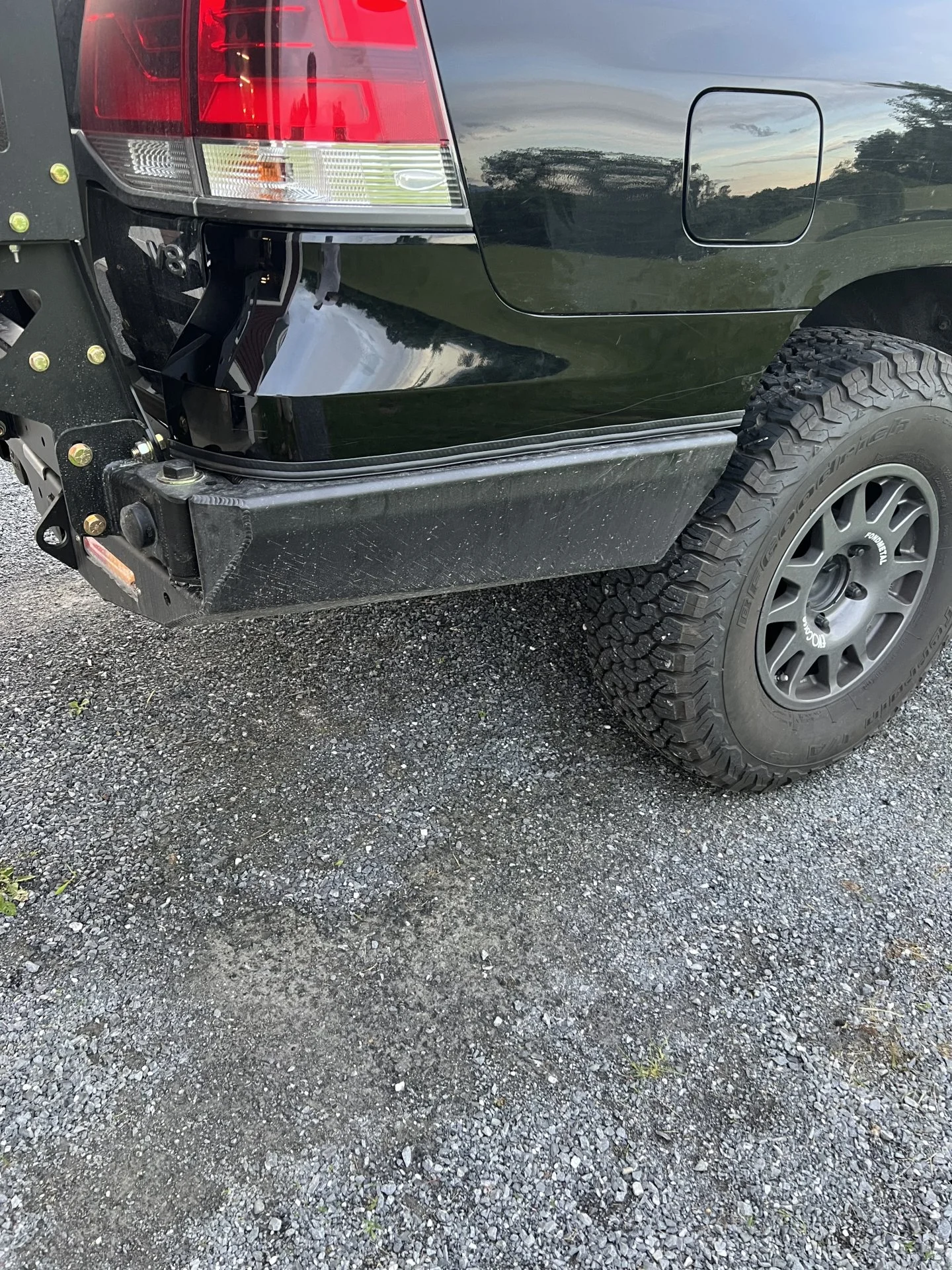

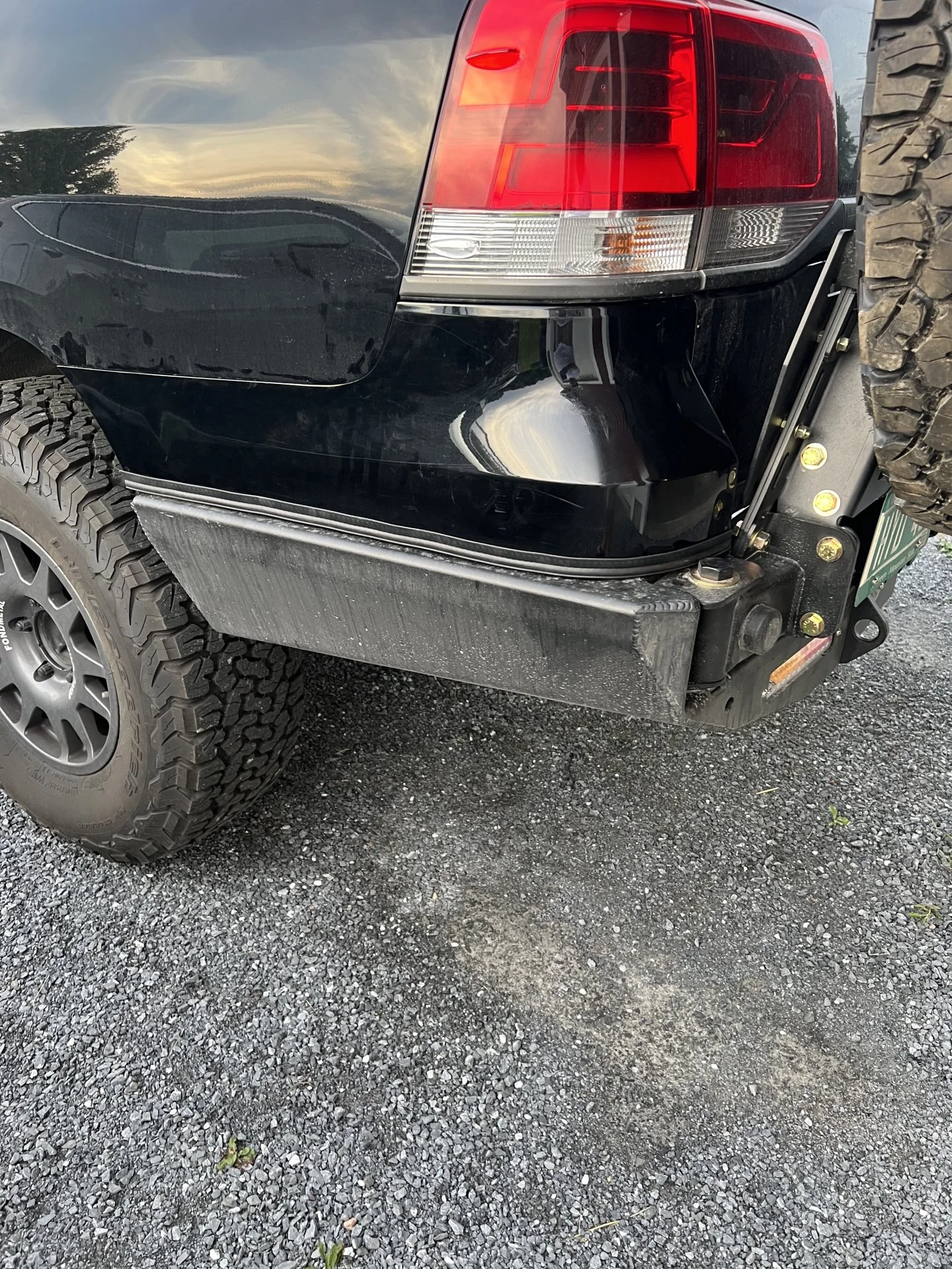

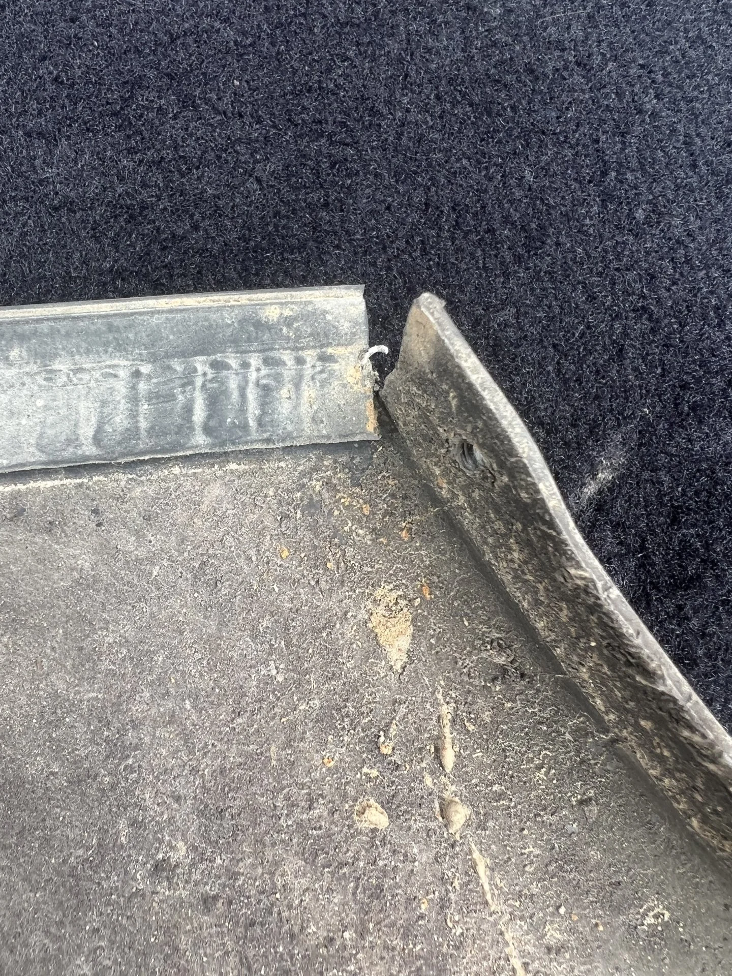

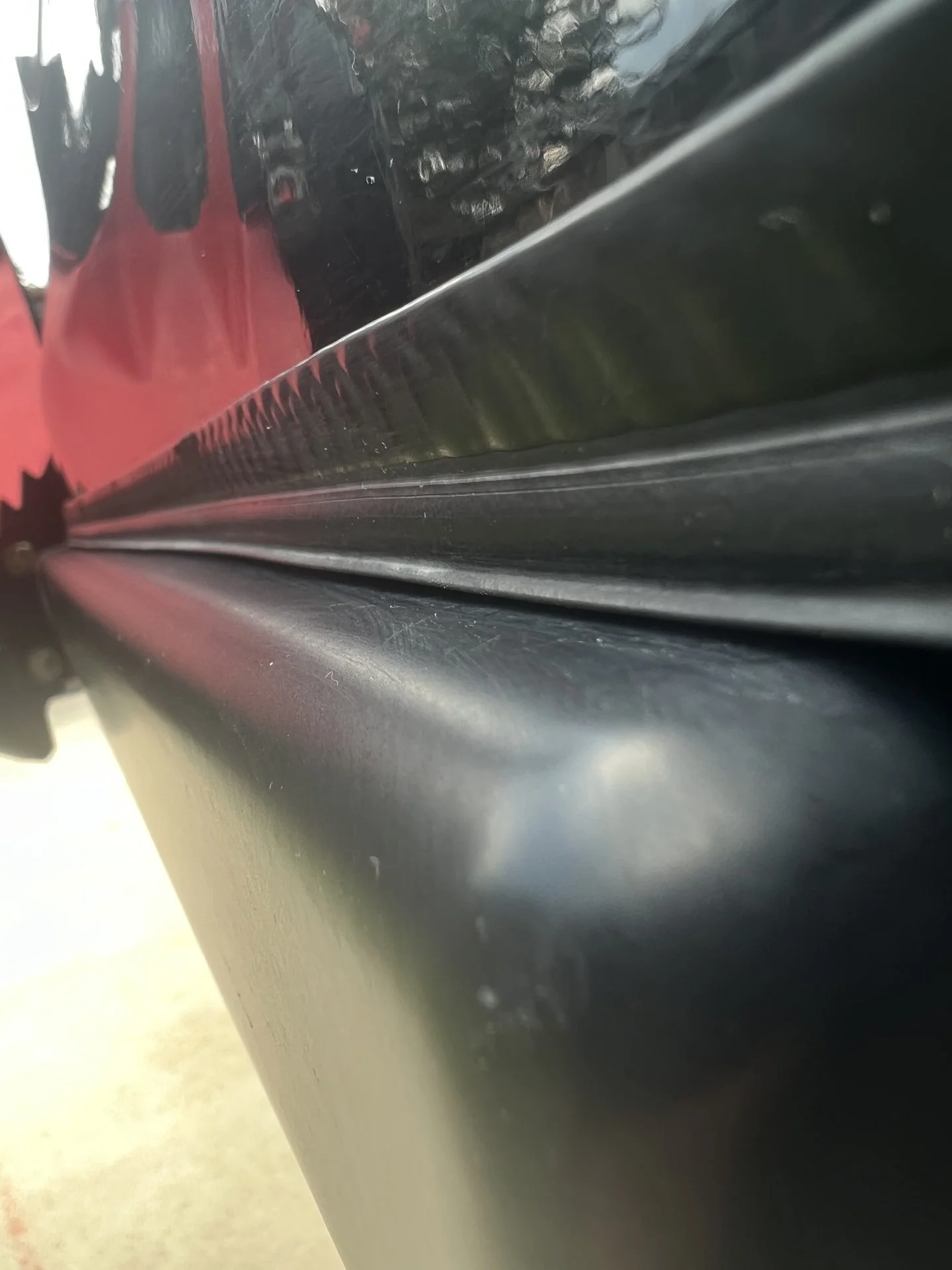

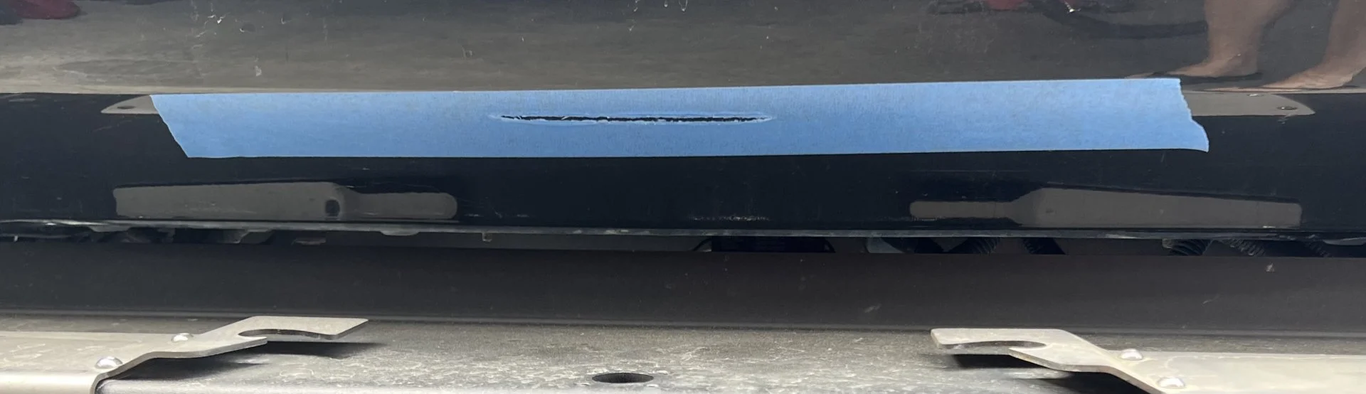

Some minor details on the bulb trim:
If you cut it square (straight), your trim will sit short due to the thickness of the plastic.
Spend a few extra minutes to notch the back side and then contour the final cut…
For your plastic cuts: Measure the bulb section of your trim and add 1/8” to that measurement. You want 1/16-1/8” gap from the trim to the bumper. The trim will wear through the powder coat if it is touching.
This is VERY helpful. Thank you!

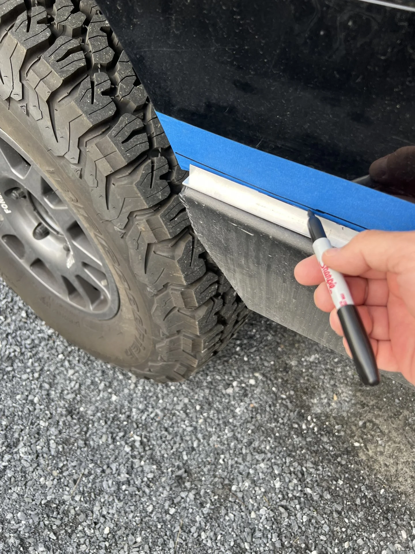

Curious to know your preferred cut tool? Angle grinder or Dremel or ???
But used painters tape to both draw on and keep from chipping?

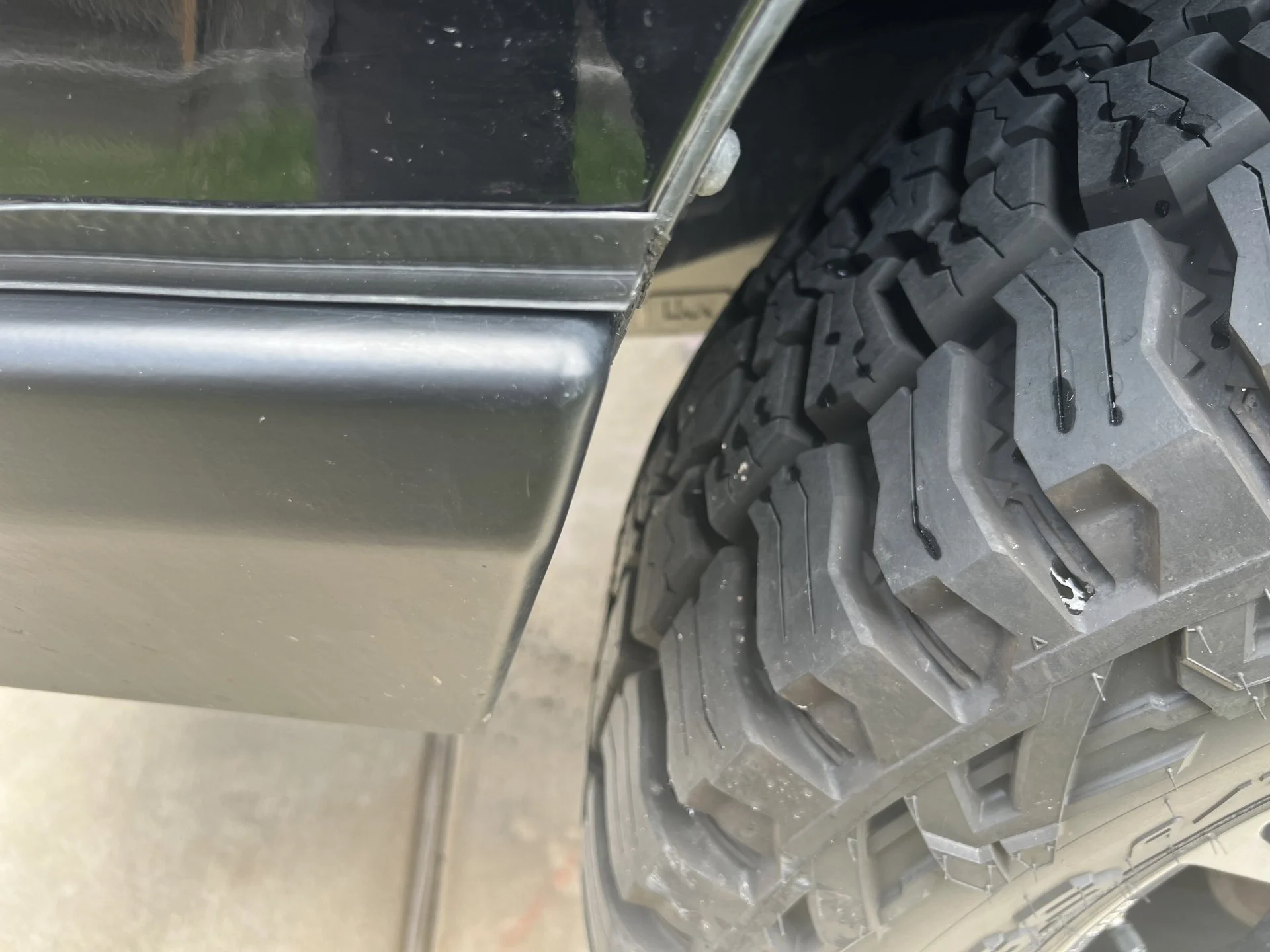

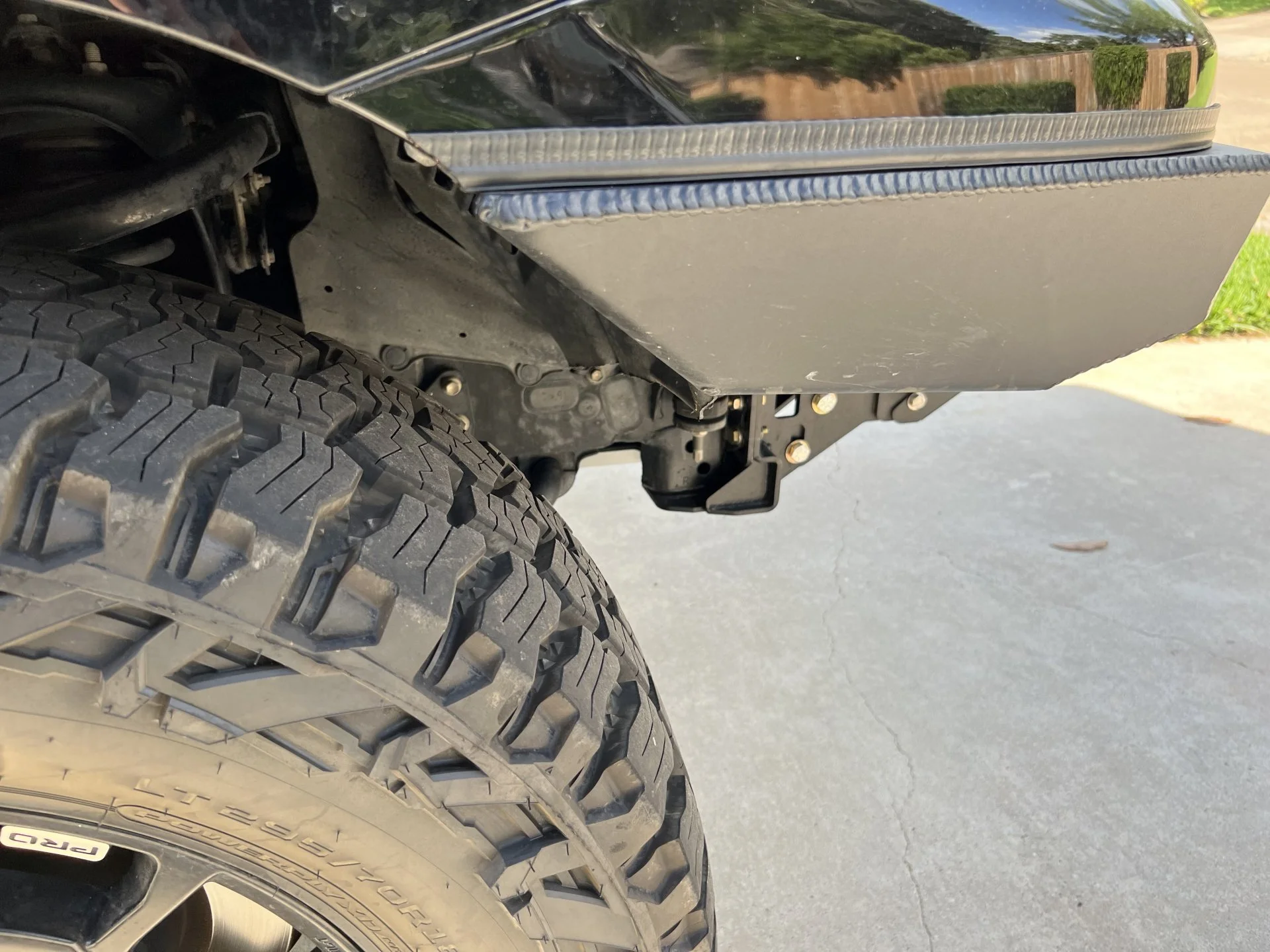

I used this technique and it turned out pretty well. The bulb measured 0.50 inches, so I used a 1/2" piece of scrap aluminum angle, marked the line with a sharpie, and "took the line" when I cut. It gave me ~0.60 of gap, so there isn't rubbing and I see an air gap. It might be not quite enough, but I can always cut more later.

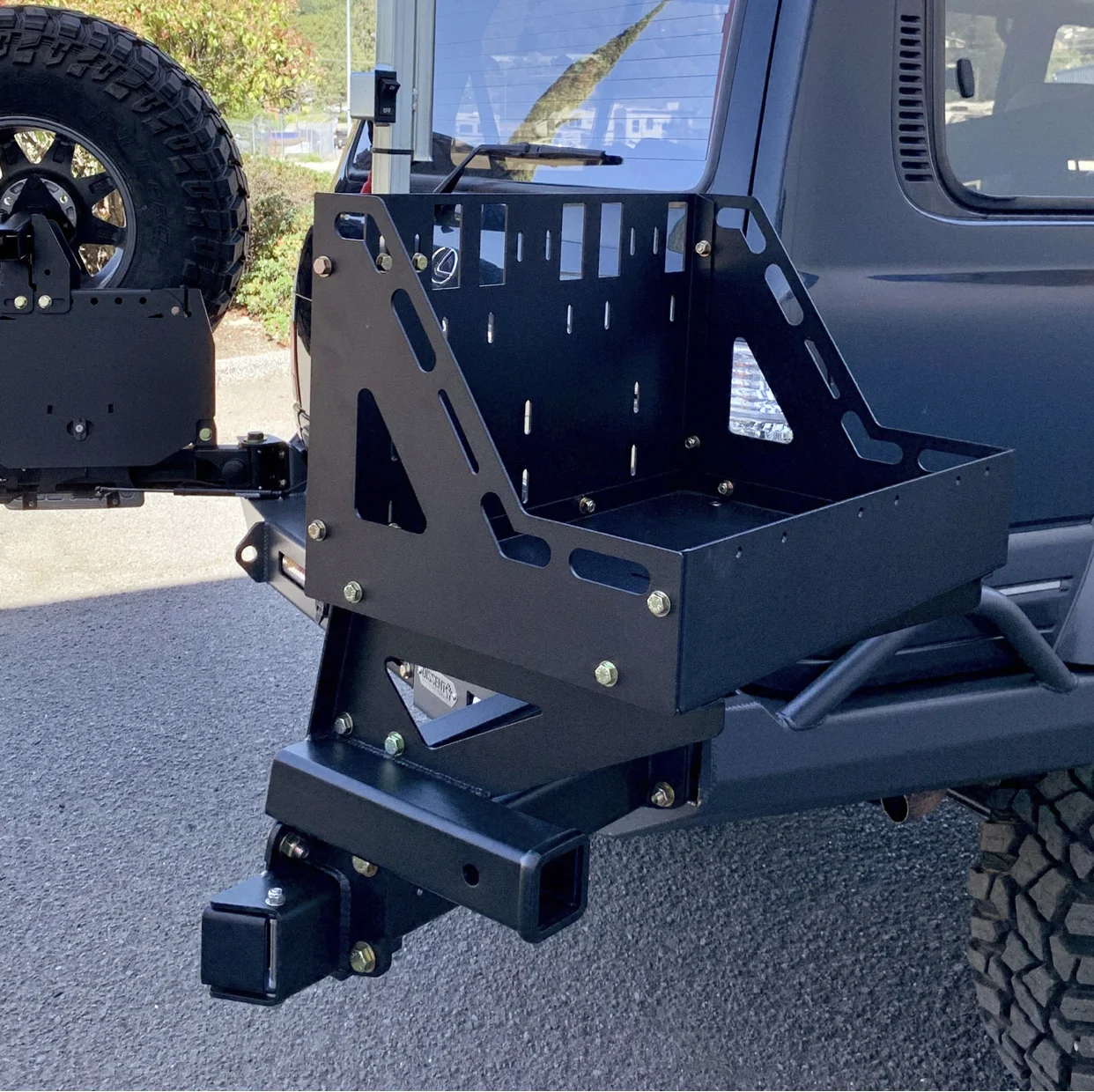

If anyone is trying to get a rear accessory swing out I would like to sell mine. It has never been installed or used.
Which swingout is it? Interested if it is one I don't have .
I think he means this one:
Or could be this one. Survey says......... @raincityrider
I have the jerry can rack now but having options for different occasions might be nice.😁
