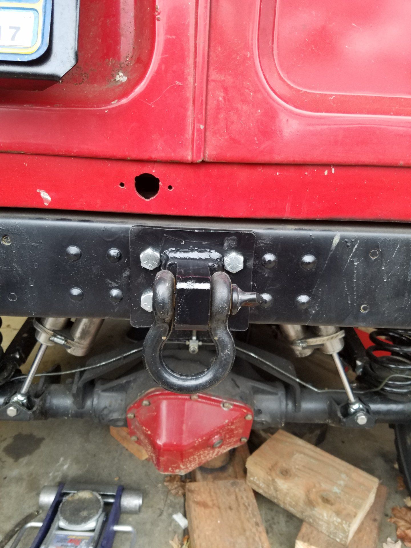

I took the spare tire carrier off and built a simple shackle mount for the rear.
When time allows, I'm going to build a poison spider style carrier for the rear.
When time allows, I'm going to build a poison spider style carrier for the rear. View attachment 1575439

I needed the shackle to winch it down, and then be able to provide pics of my epic cruiser on 42's.
Lol! Now it all makes sense...

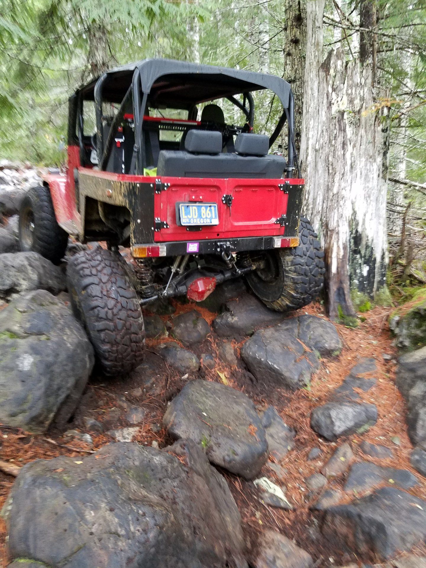

Looks so great. Did you appreciate the extra ground clearance? Did you have to redo the bump stops? Looks to fill out the wheel wells nicely.. I’d like to move up to 40s for that reason.
Front bump stops seem pretty dead on. The tires just rub fender at full stuff. The rears barely touch the inner part of the bumper, so some trimming is needed there. Sadly, that'll also require some work on relocating the taillights.
The ground clearance worked wonders in the boulders and hopefully will work in the snow in a couple of weeks as well.

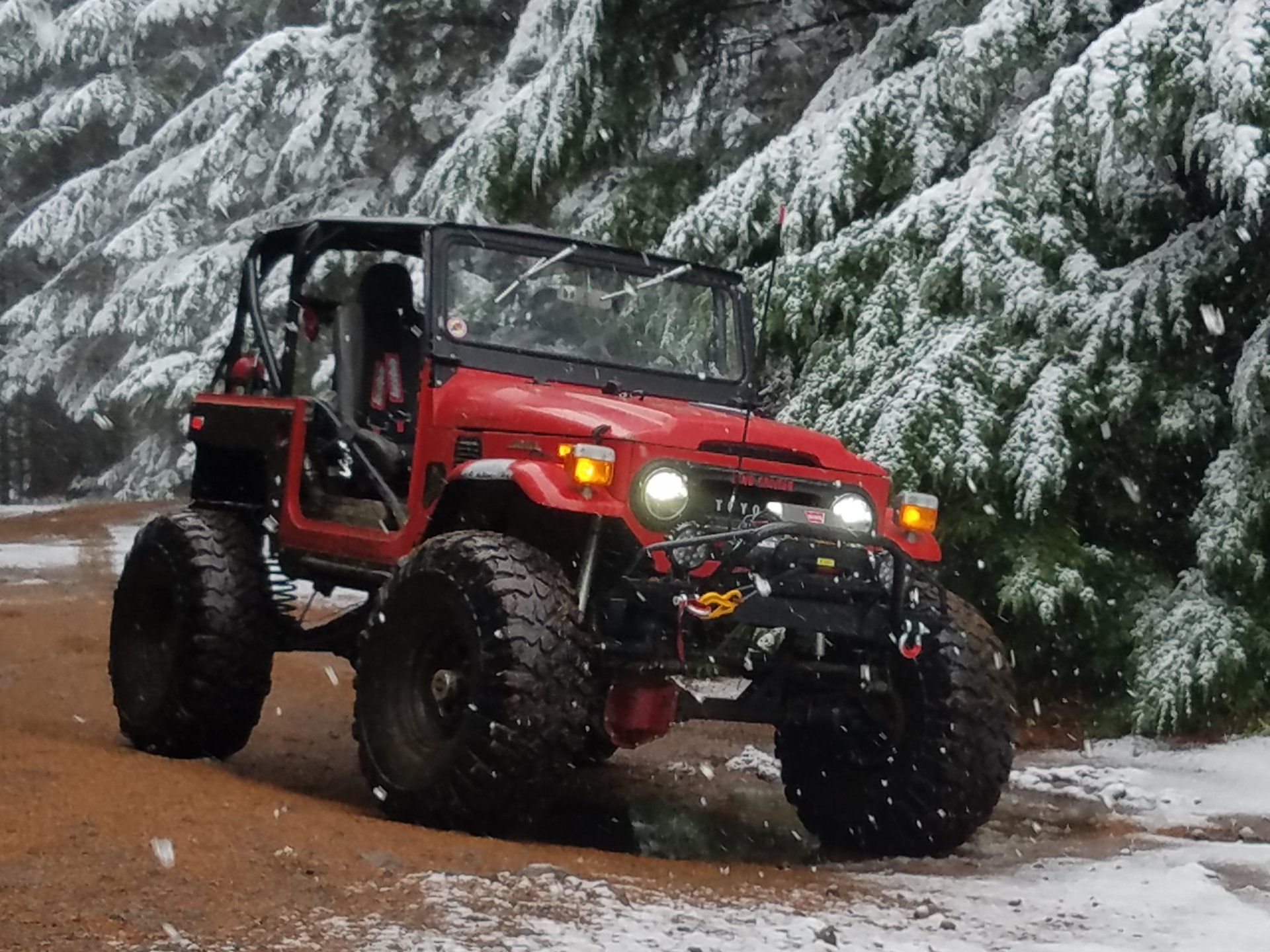

Got into some snow today!
I need to replace the front leaf packs as I bent a leaf on one side. Also needed is to get the windshield wipers working along with the heater!View attachment 1584986

What are your plans for the rubbing on the front fenders? Cut them? Raise them? Campbell hood?
I say you replace it with links :D
I'm going to leave them for the time being. Maybe after the new year I'll pick up a 1" die for my bender and make a set of tube fenders, but the rubbing is minimal (full stuff, only when going downhill).
