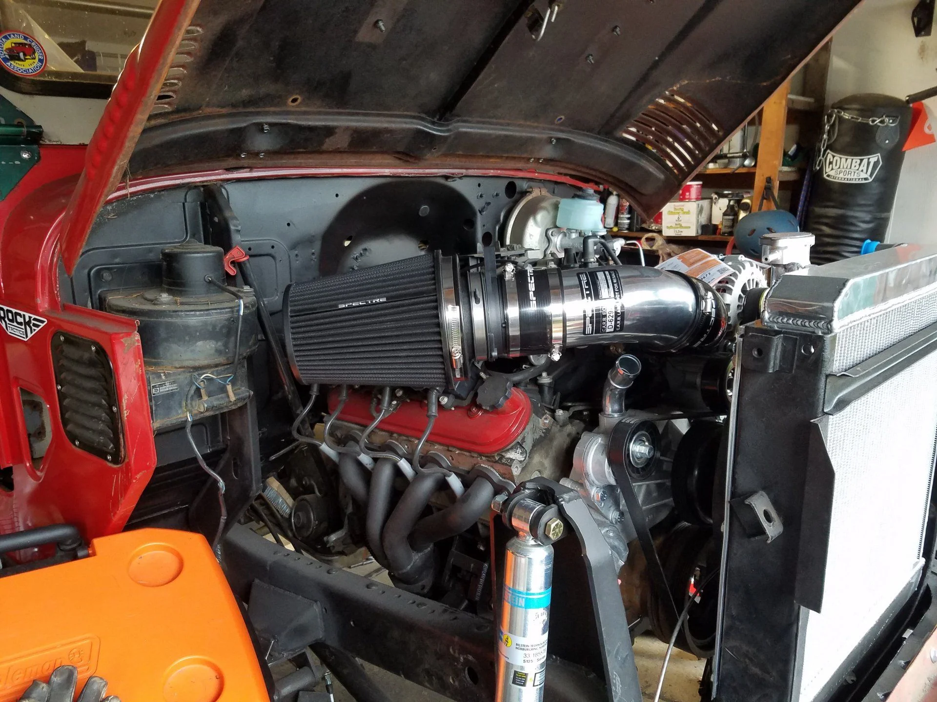

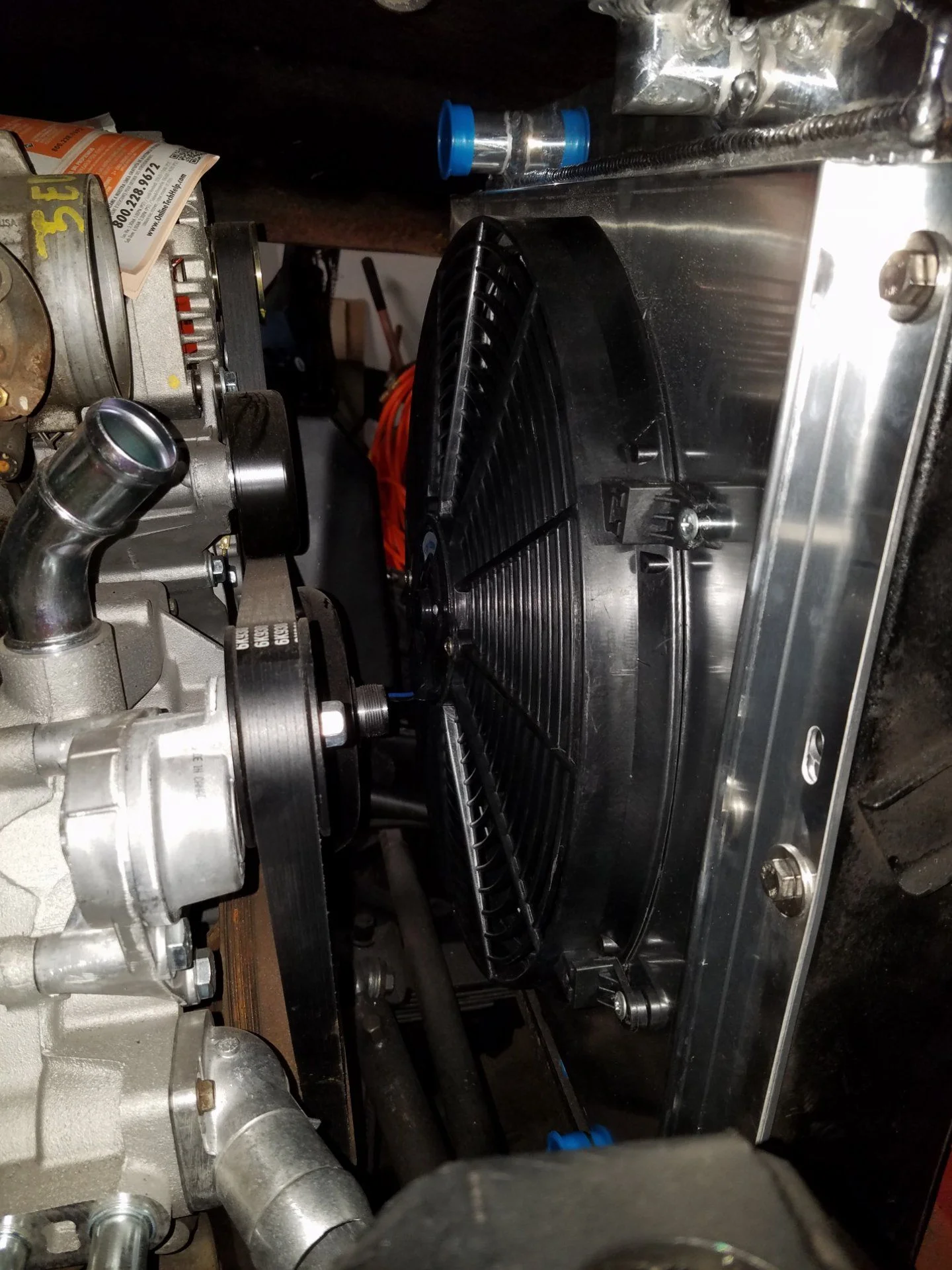

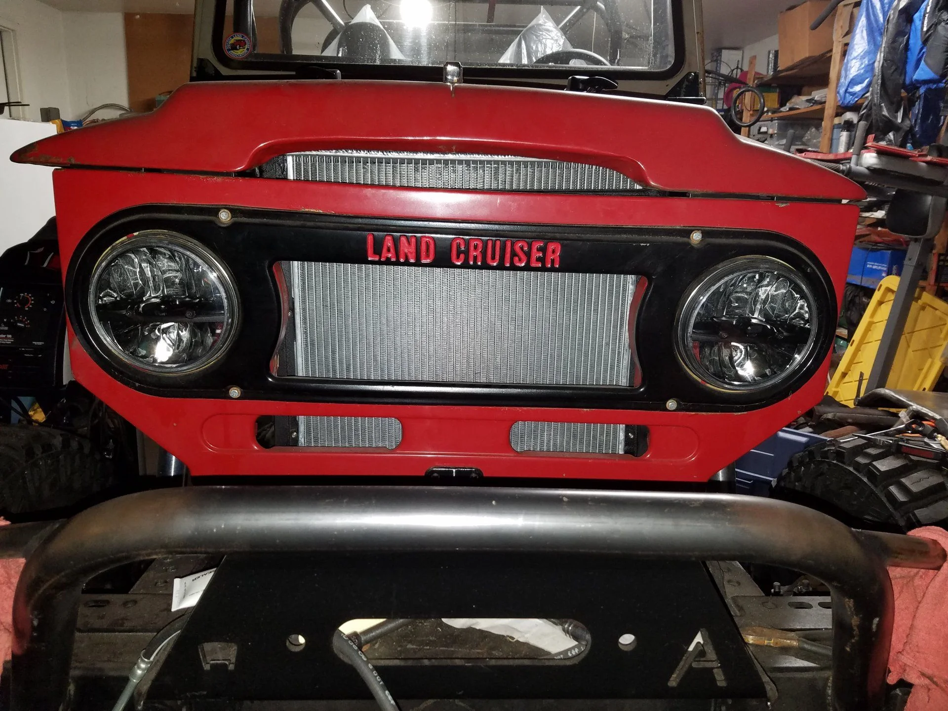

Radiator is installed and fits nicely.

Curious to know the radiator hose config you come up with! Part no. would be much appreciated.

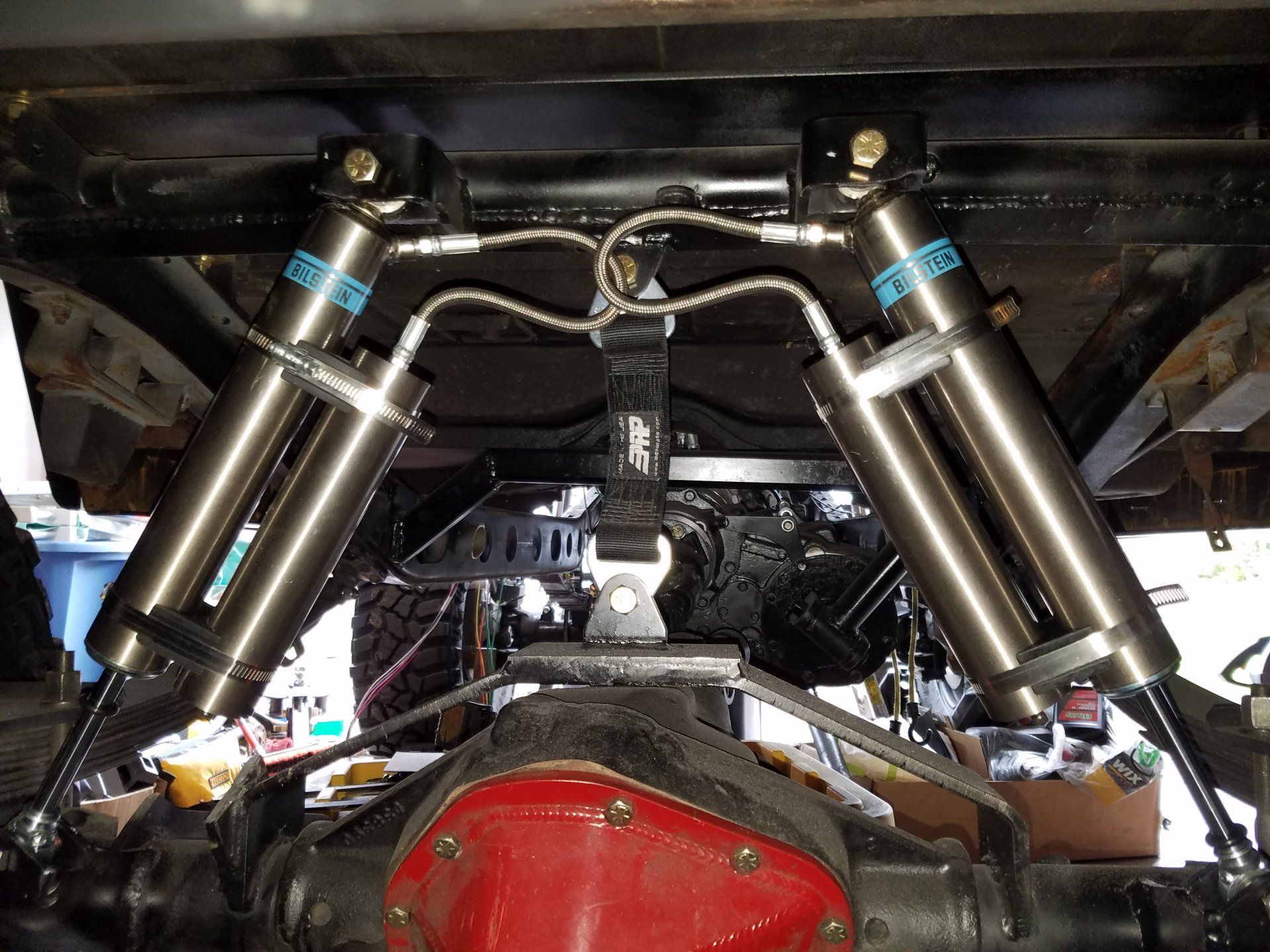

Progress has been as school and a new baby allows. I've redone the rear shock mounts, uppers and lowers, to reduce stress on the shock heims and give them a better orientation. I used a combination of ruffstuffs monster mounts and the side angle mounts from Barnes. I'll grab some pics in the next day or so. The Bilstein 7100 short body shocks look great and I'm now thinking of a set for the front to match.
Need pics!!!

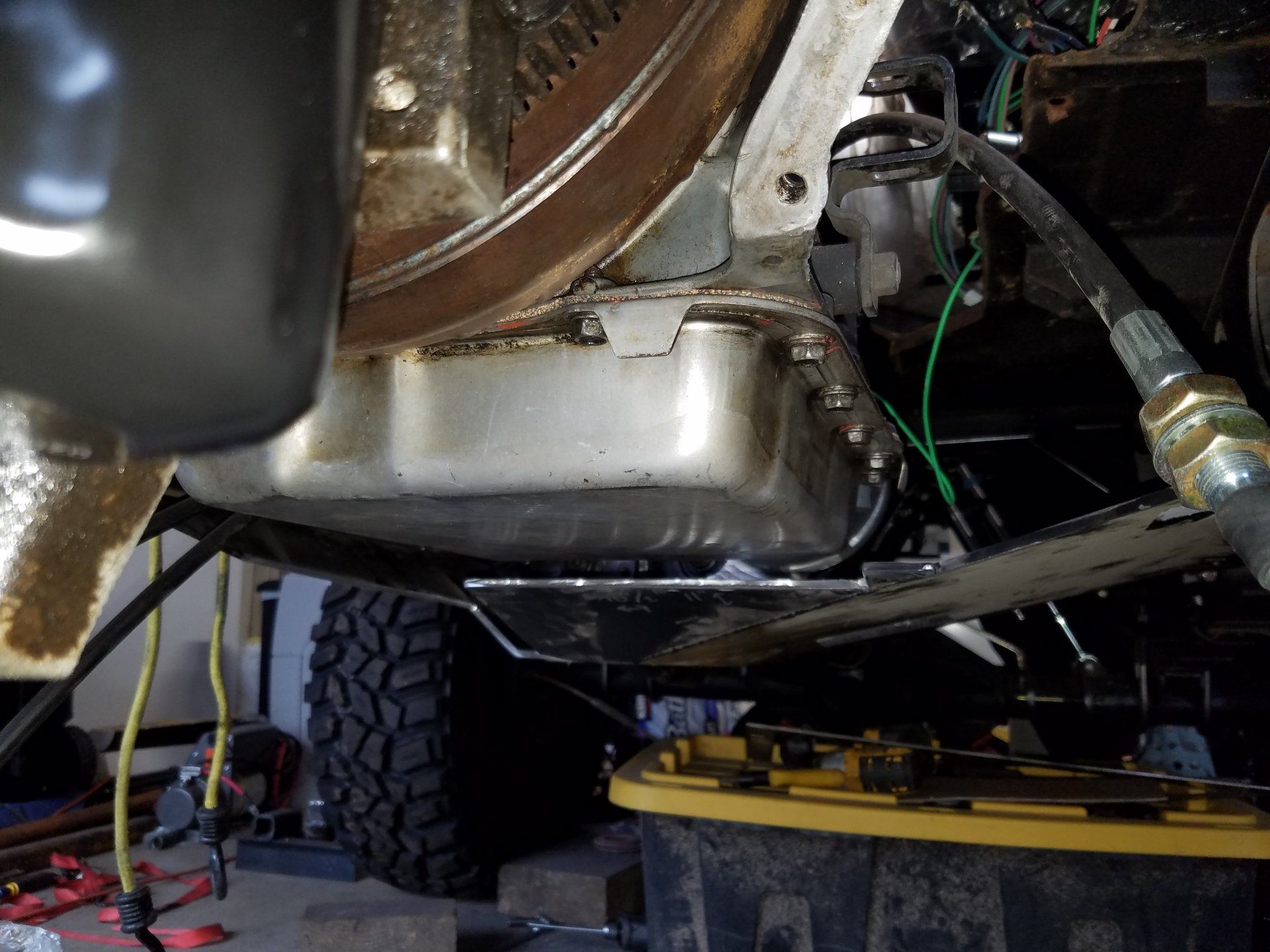

Belly skid is almost done. I bought an IPOR skid and am making some changes to it for my application. I think for the time saved having to try to cut and burn one myself that I'm money ahead.
Rear shocks are in. I'll need to put the reservoirs somewhere, but they're fine for the moment.
