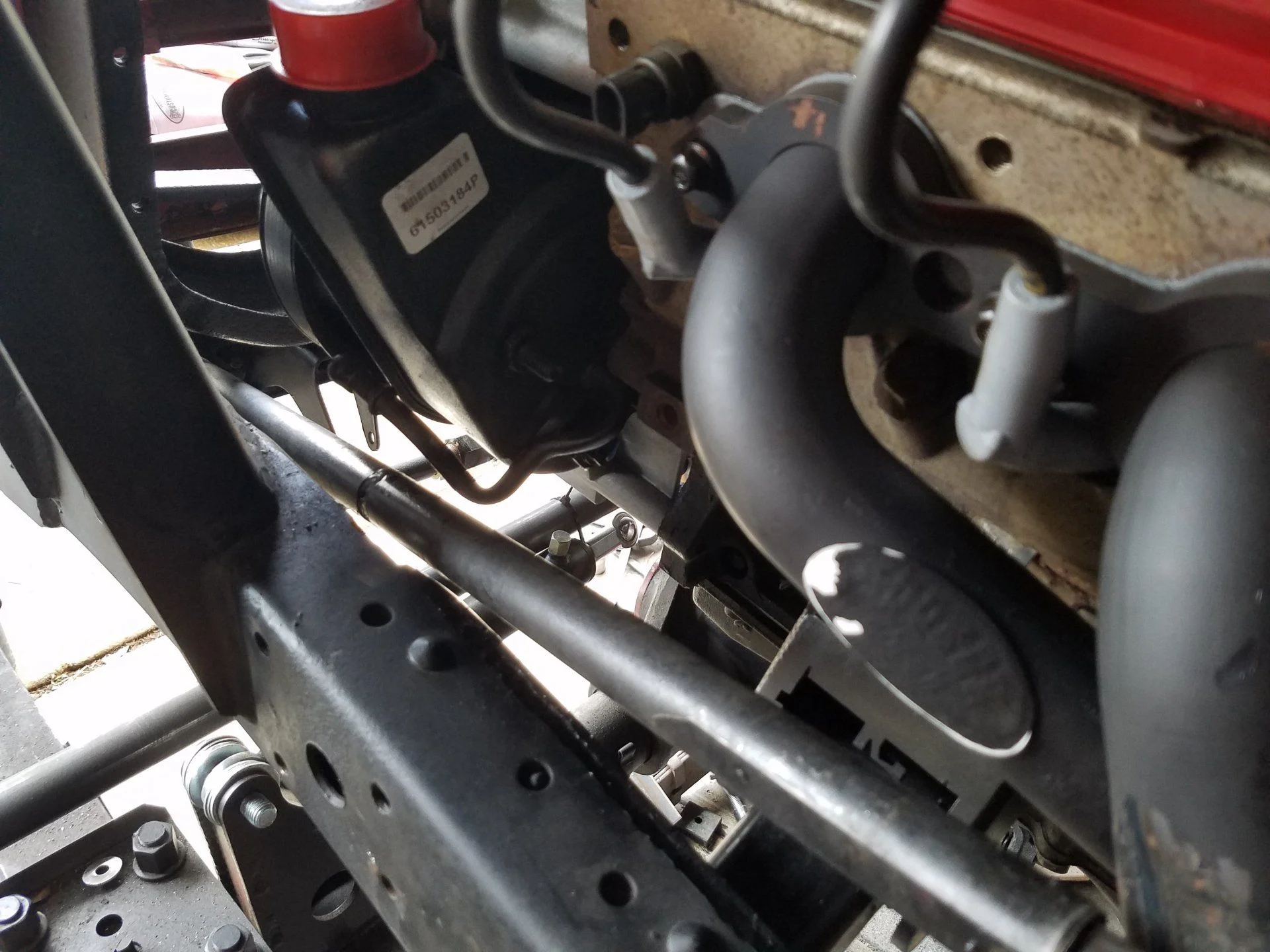

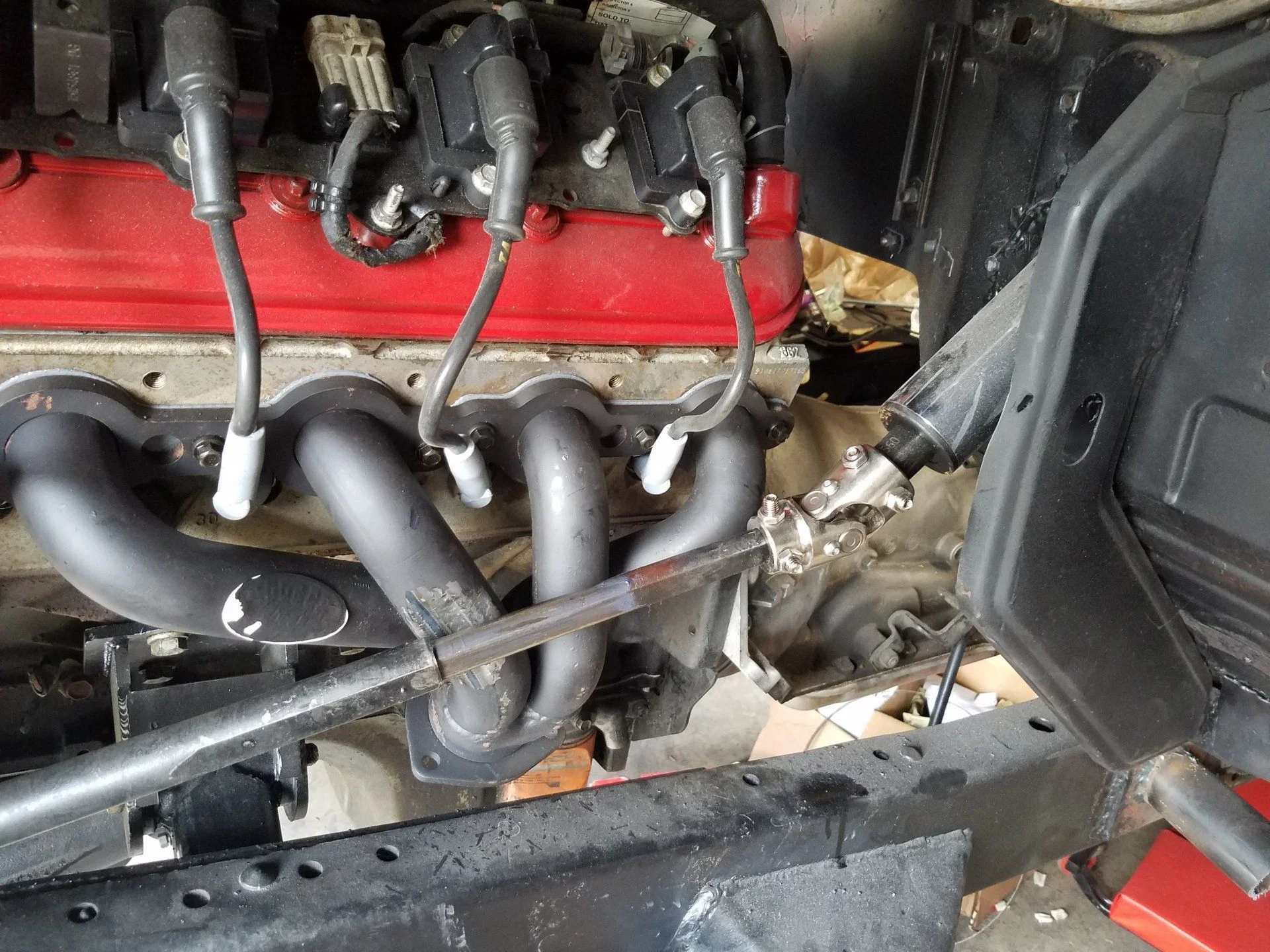

I've had a couple of hiccups with the truck as I've been trying to sort the steering and exhaust: I could do neither the way I had things going. So I picked up a set of Hooker LS Block hugger headers, will have to redo my engine mounts to install those, but will have ano almost straight shot for my steering after that all is done!

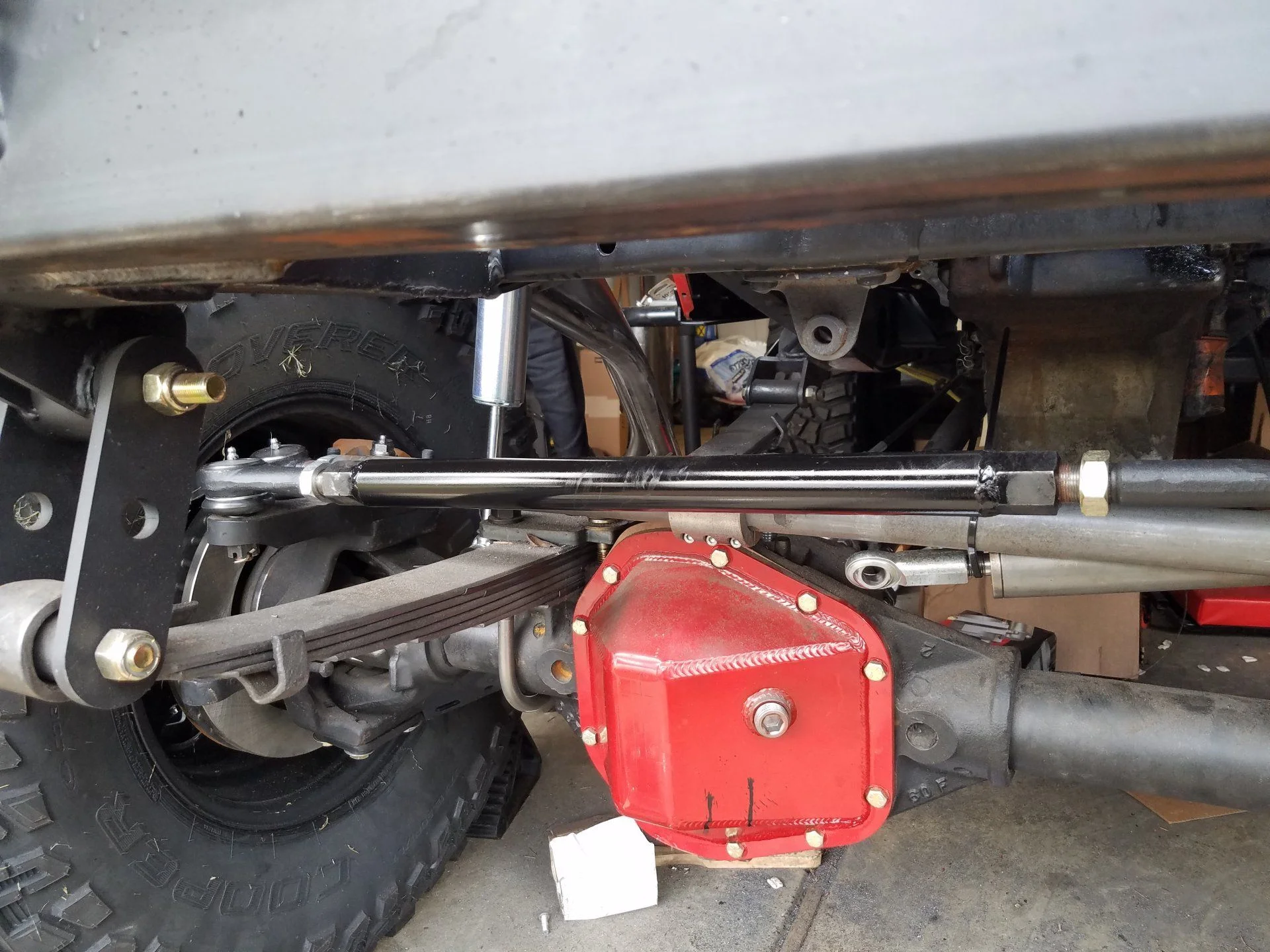

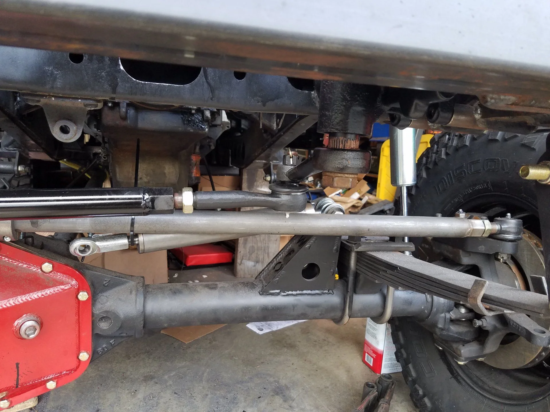

So, a question for all of the guru's: should I have any worries running soft brake lines from each front caliper to the frame on the respective side? With my steering setup, it's not a good idea to have a center line going to a tee and then to the shorter stock soft lines that come from the caliper.
Nope, shouldn't be an issue as long as you can make sure that the soft lines don't get snagged on something!
Does your soft line = braided stainless steel covered line? If so I've been running that with good success and have eliminated any hard line on my axles.
Yes sir, the "soft" are the double braided Kevlar core stuff and I'll have hard lines on the rear axle and the frame.

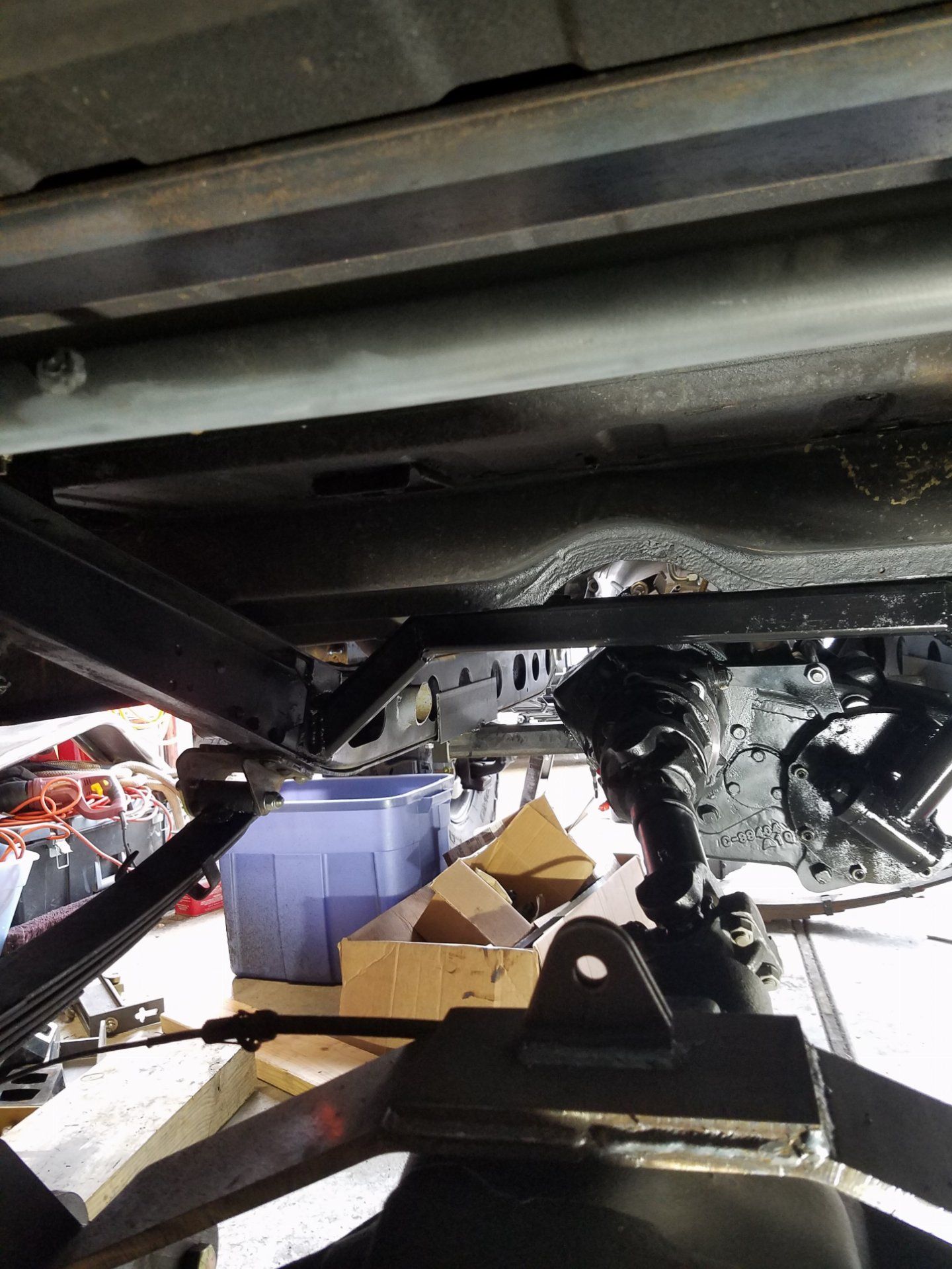

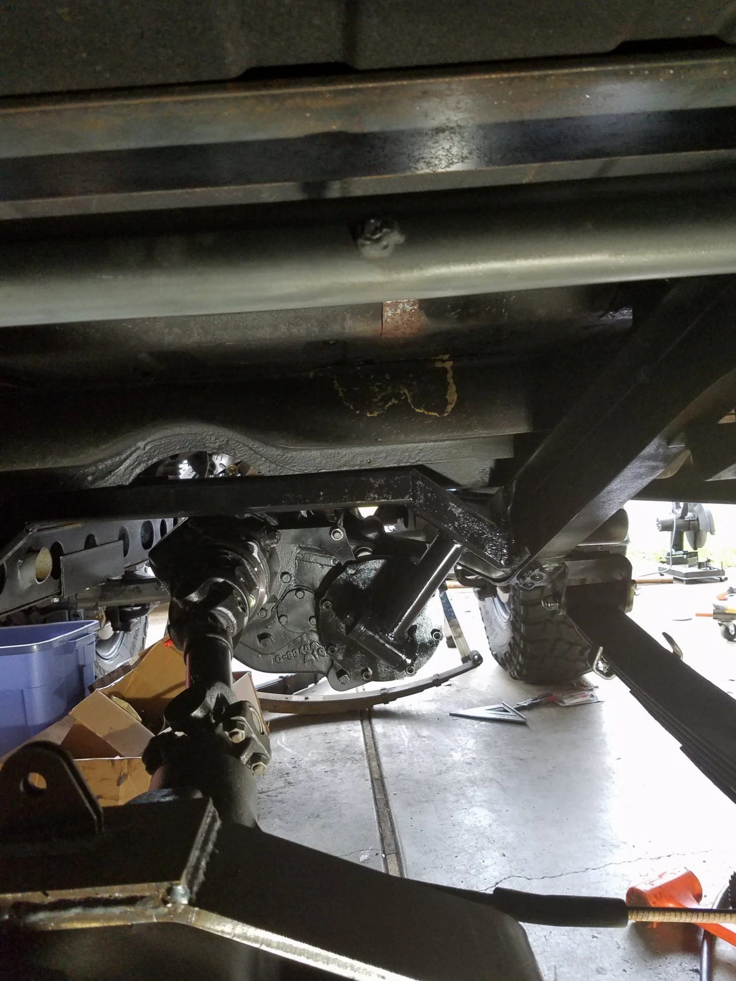

Steering is dialed in. I replaced the rag joint with a u-joint to give me a little room for error on the steering shaft angle.
