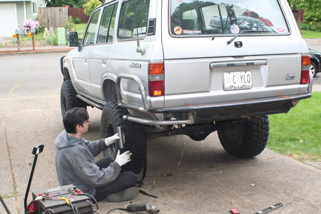

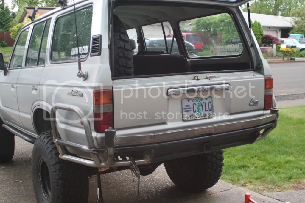

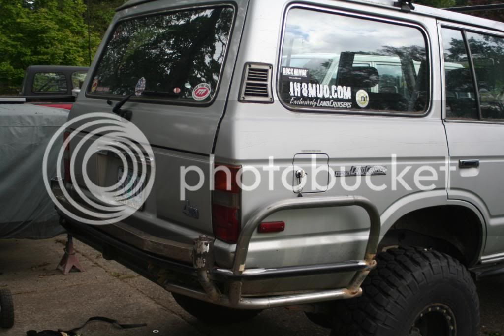

After a much needed break from working on the truck Mike and I got right to it without delay today. Brokenparts was kind enough to lend me a hand getting some tubes bent for the rear bumper a while back and Mike and I put them to use today.
1. Mike and I cut down the bumper I threw together for Rubithon last year and ground down the welds:

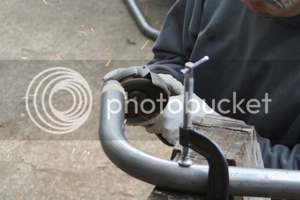

2. Mike got right to work on the upper tubes while I watched in awe of this man's grinding abilites!
3. Me: " Hey Mike I have a.."
Mike: " Not now I am on a roll.."
Me: " But Mike its a hole cutter.."
Mike: (20 mins later) " Why didnt you say so?"
Even with the hole cutter/ notcher the bends and tubes took a lot of finess to fit!

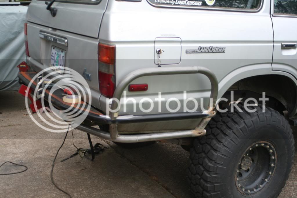

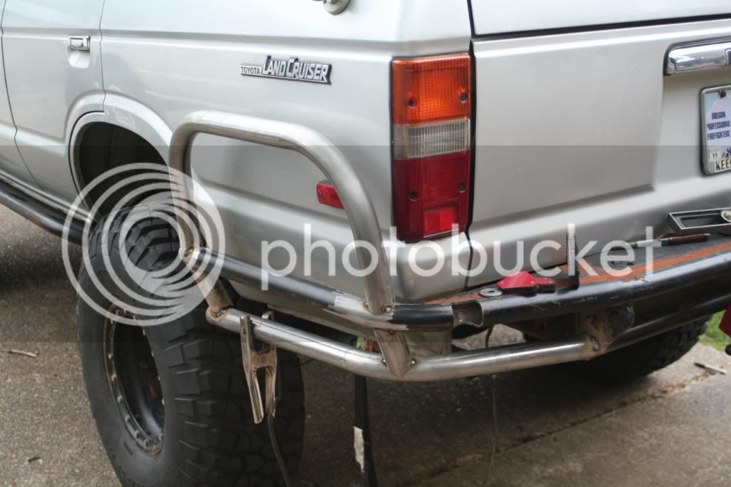

4. After a good 6 plus hours and a bit of spot welding we came up with this:
Obviously lots of work left to do but I am very pleased with the way it is turning out and am very appreciative of Mike's help and wealth of knowlege!

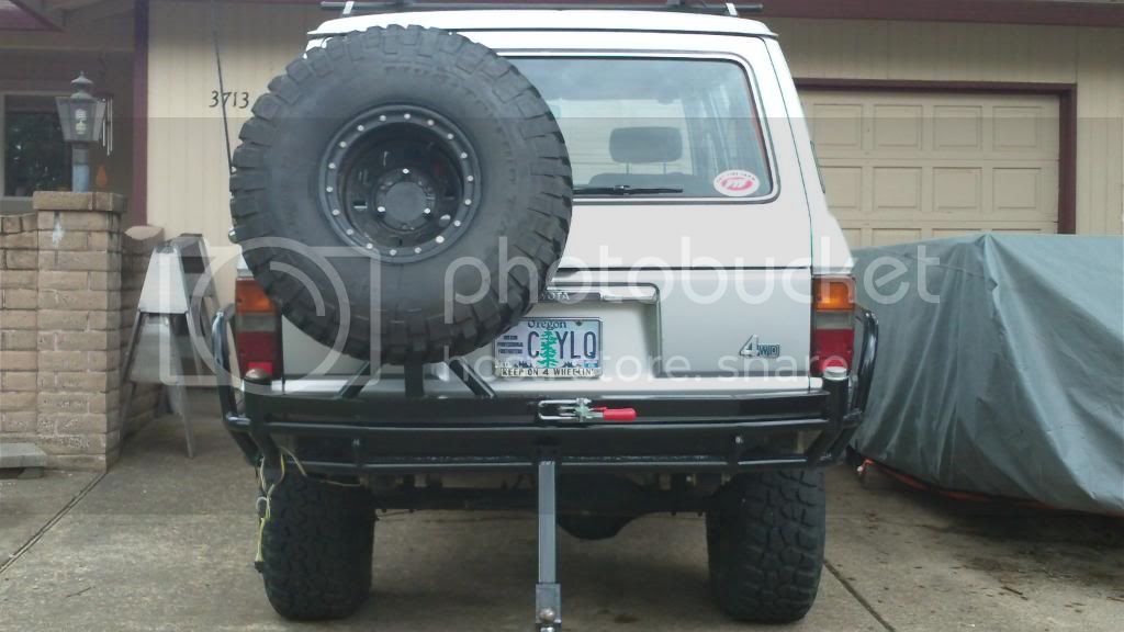

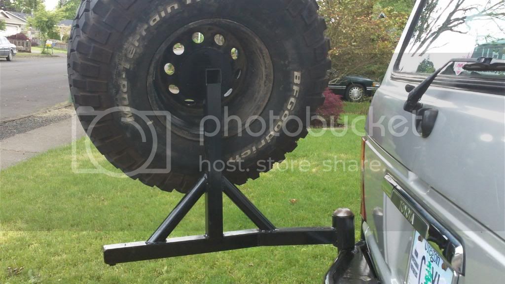

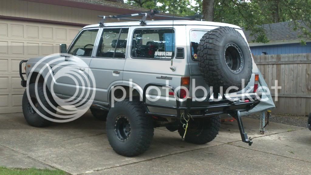

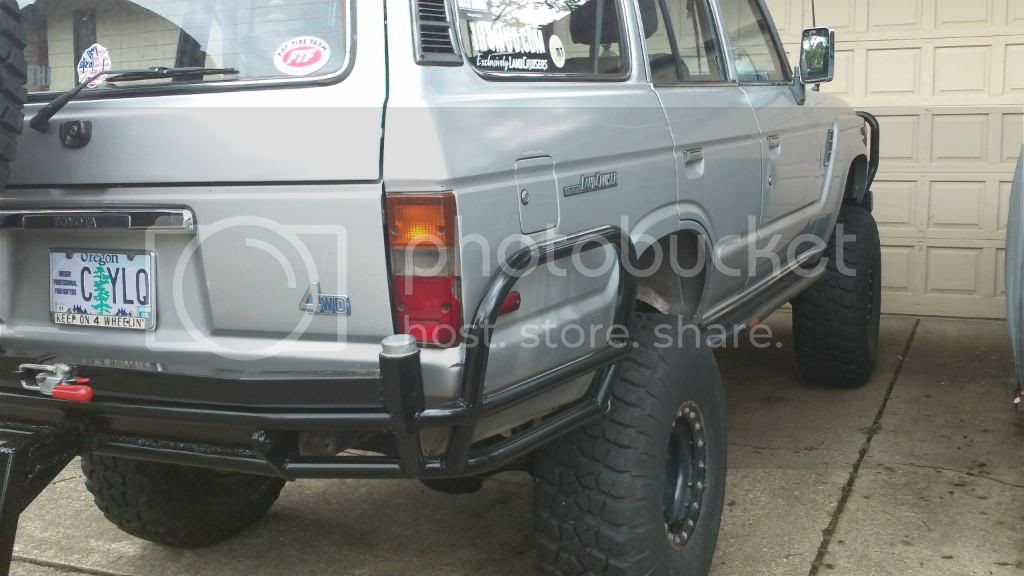

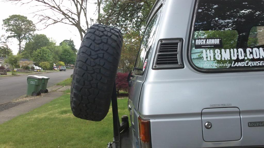

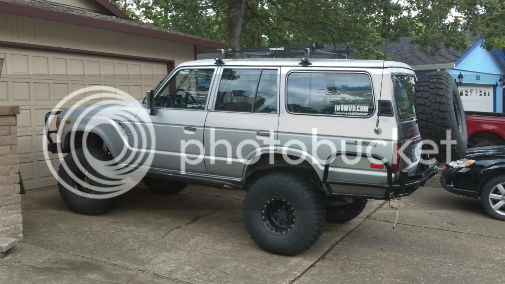

Got some more done this week and am very pleased so far! The tire carrier went through two revisions to get it closer to the body and add support. I can hang off of the end of the arm and bounce and there is no flex at all!!!
I am working out some designs in my head for the jerry can and high lift but wont have time for another 2 weeks to get to it.
Let me know your thoughts.
Clint
Well done Clint, that's one snazzy bumper!

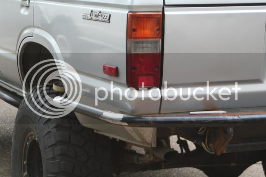

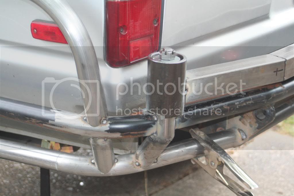

Nice tow hitch. :)
I'd do some kind of tube inside the side hoop so you dont get a rock or branch into panel. Other than that it looks great man.
Lots of room in there huh? Maybe a small plate with some dimple die holes? ;)
The drop is necessary to keep me from ripping off the bumper on the temt trailer again :doh:
Nice Clint ... just a question .. why you choose the drivers side for the tire ..?
I can see out the back better. Sounds odd but I have drivers side mirror to see left and have better view with less blind spot on the right with it there.
What are your plans for the passenger side swing out?
dual jerry can and high lift. I was also thinking of moving the CB antenna from the tree catcher on the side. Hope to have some more done in the middle of June when things slow down again!
make sense .. I was thinking just if you need to stop side on the road it's easier ( safe ? ) open in the pass side ..
Nice tow hitch. :)
I agree, if you take a shot on the top of that bar it may bend into the body temporarily. Hard to tell how close it is in the pictures though.
Otherwise looks fantastic, let's meet up this year and scratch it!
