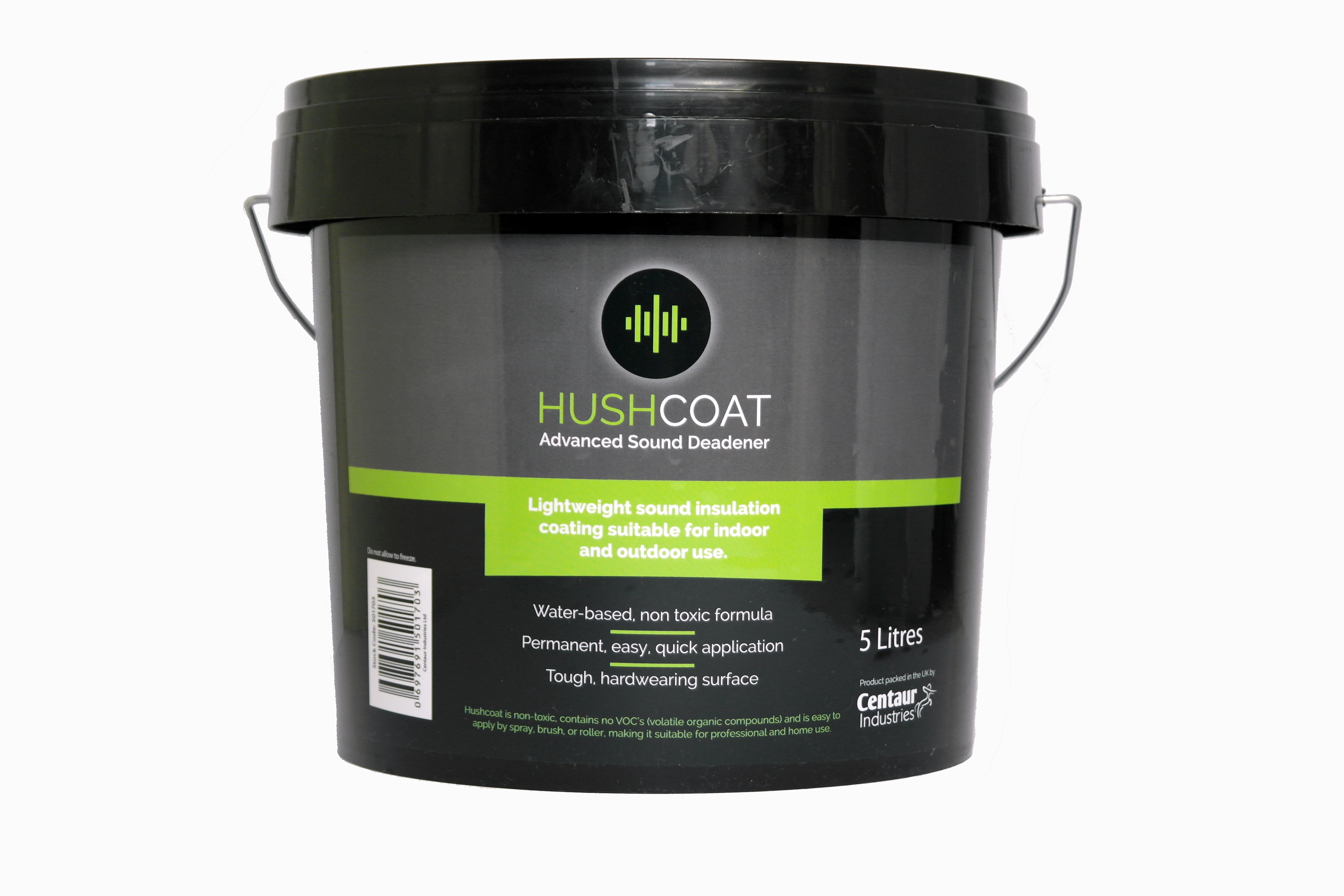

I'll shoot the underbelly with sound deadner and reassemble everything on Saturday and start getting this beast built.
