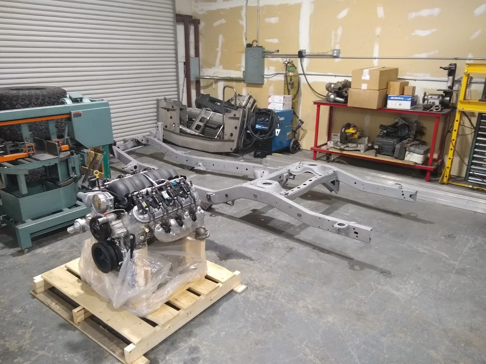

Got things moved around. Still need to move some more crap over to the machine shop or just throw it away.

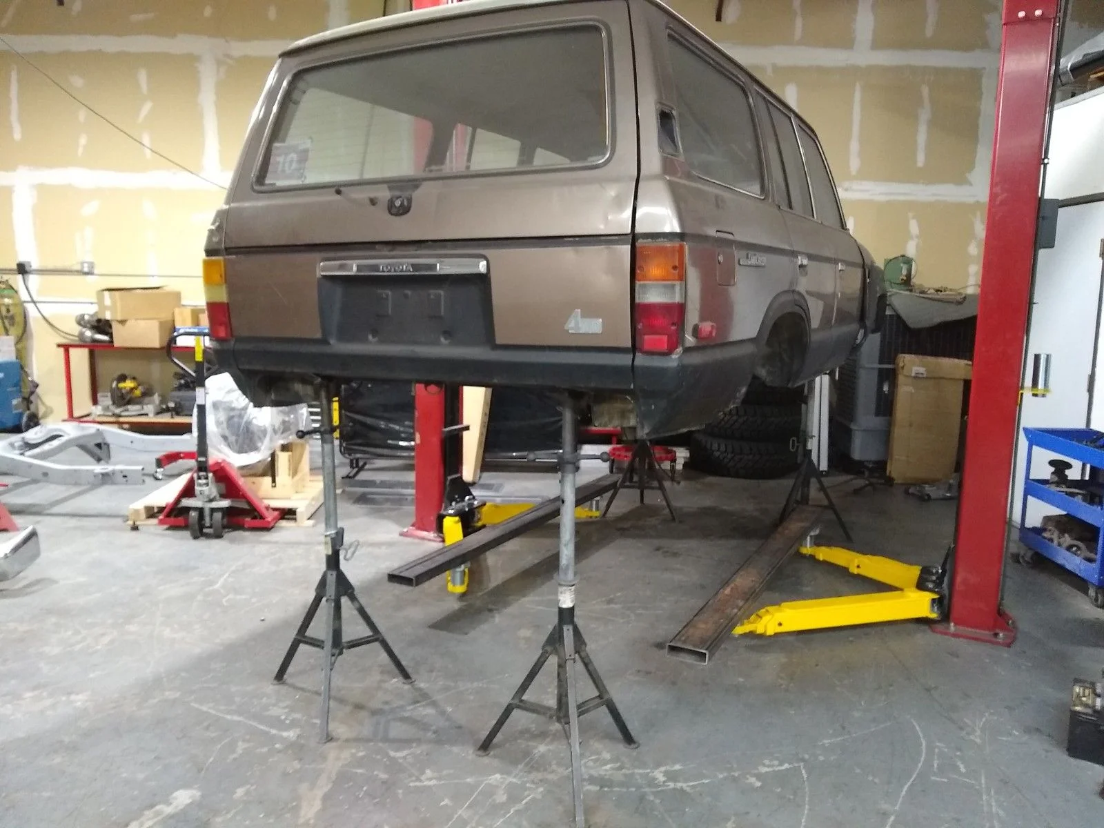

60 body and frame are on the lift ready to separate.

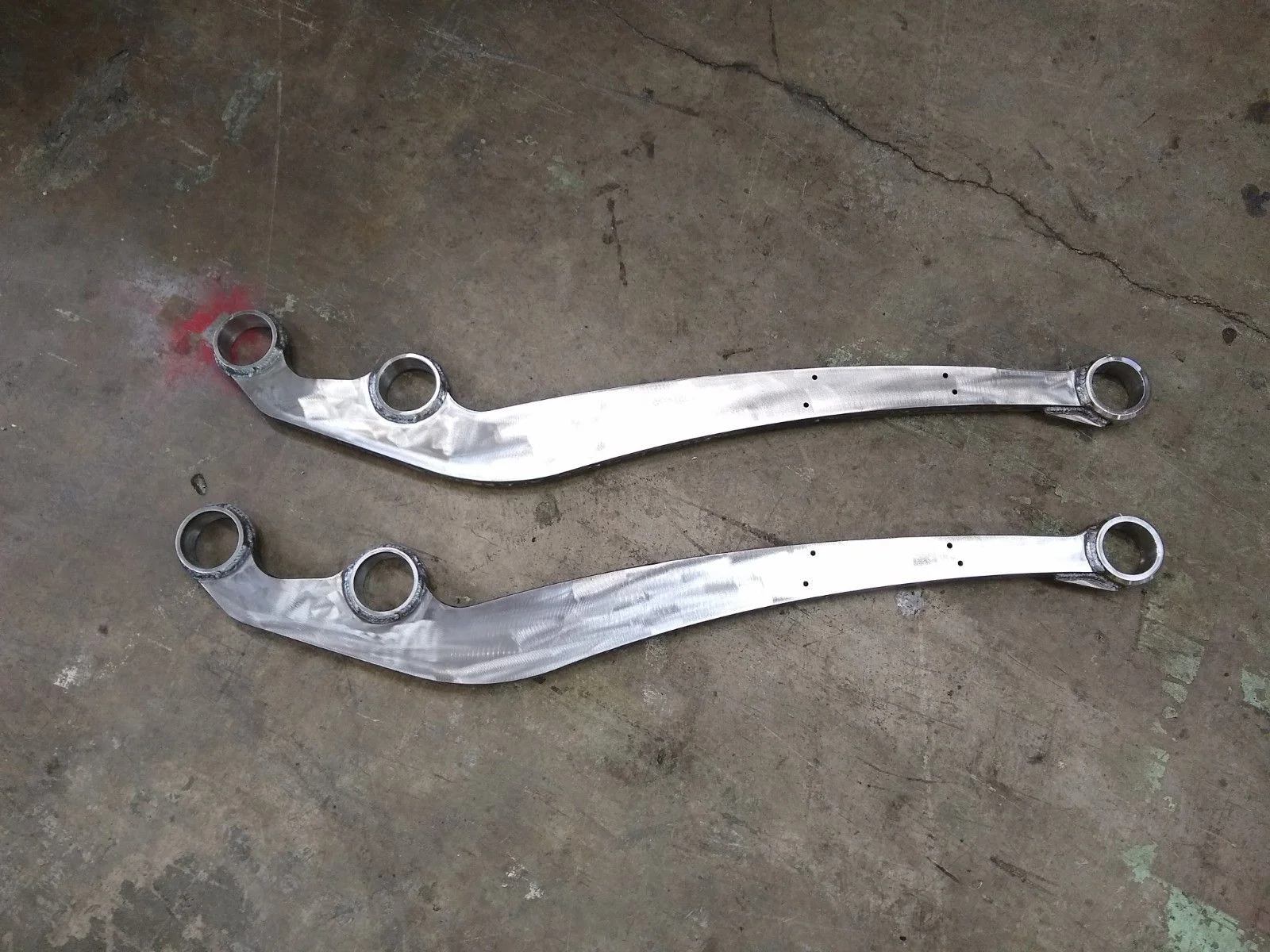

Should have the axles cleaned up, and re-assembled early next week. Then get the suspension back under the frame. The Delta arms will be here on Monday and see where the new front center line is. They increase the length about 1/2" on the 4" lift version to accommodate for the lift, but I'm thinking I'll set the body a tad more back to help with clearance for the 37s.
3rds were dropped off and old tires and wheels and 37s are at the tire shop.

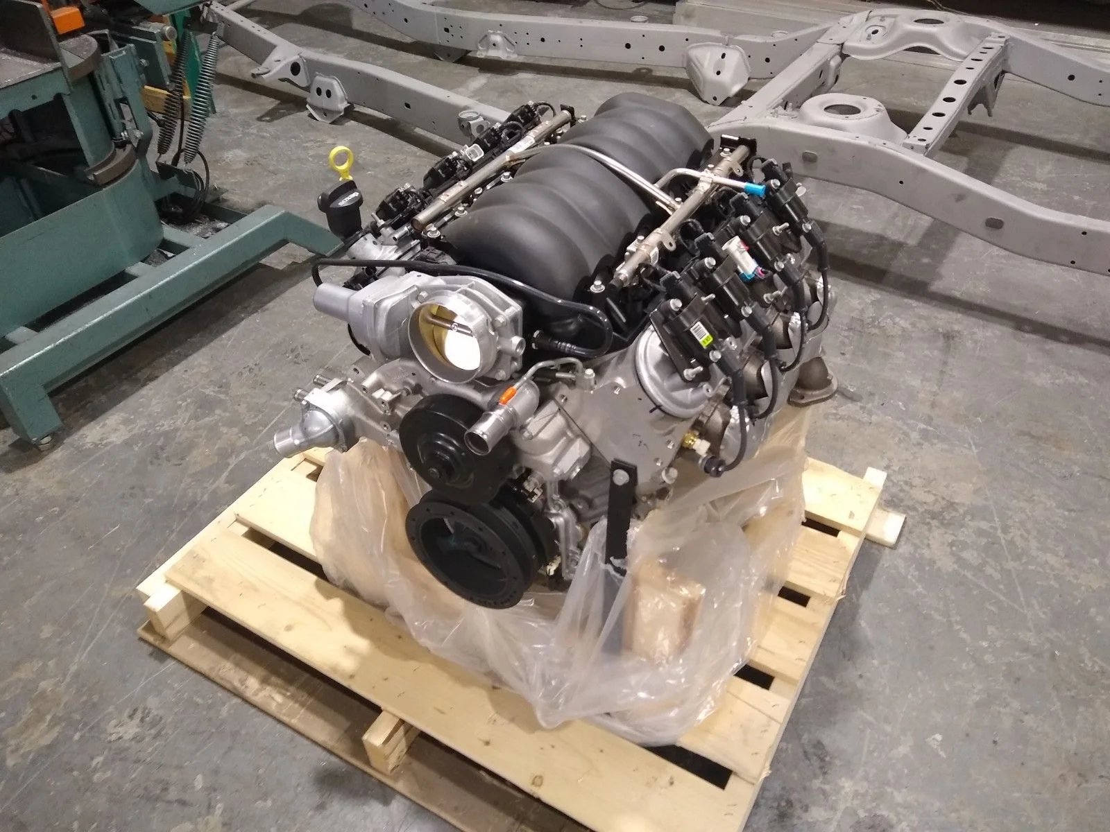

Pulled the LS3 out of the crate and started digging out other pieces..

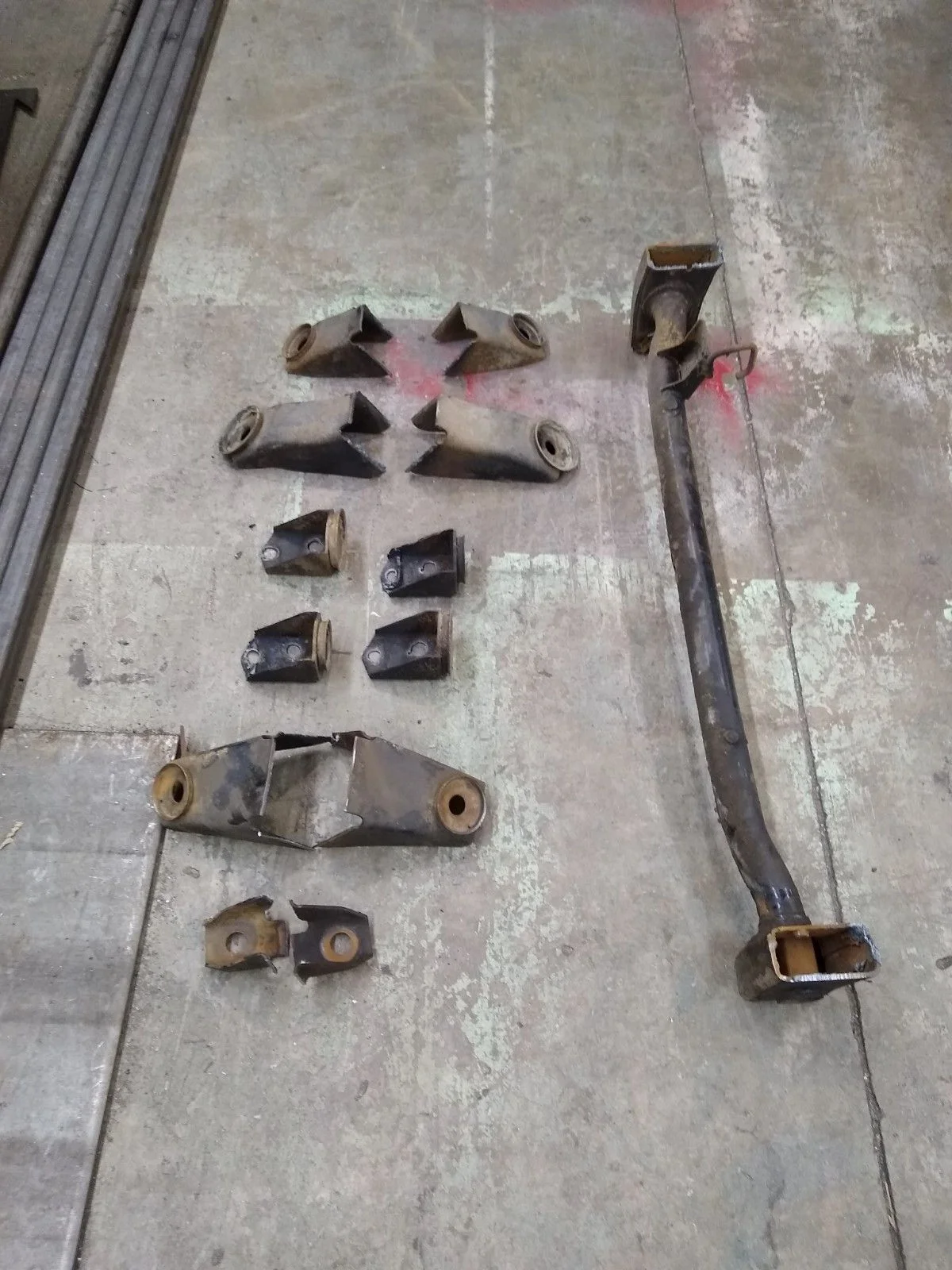

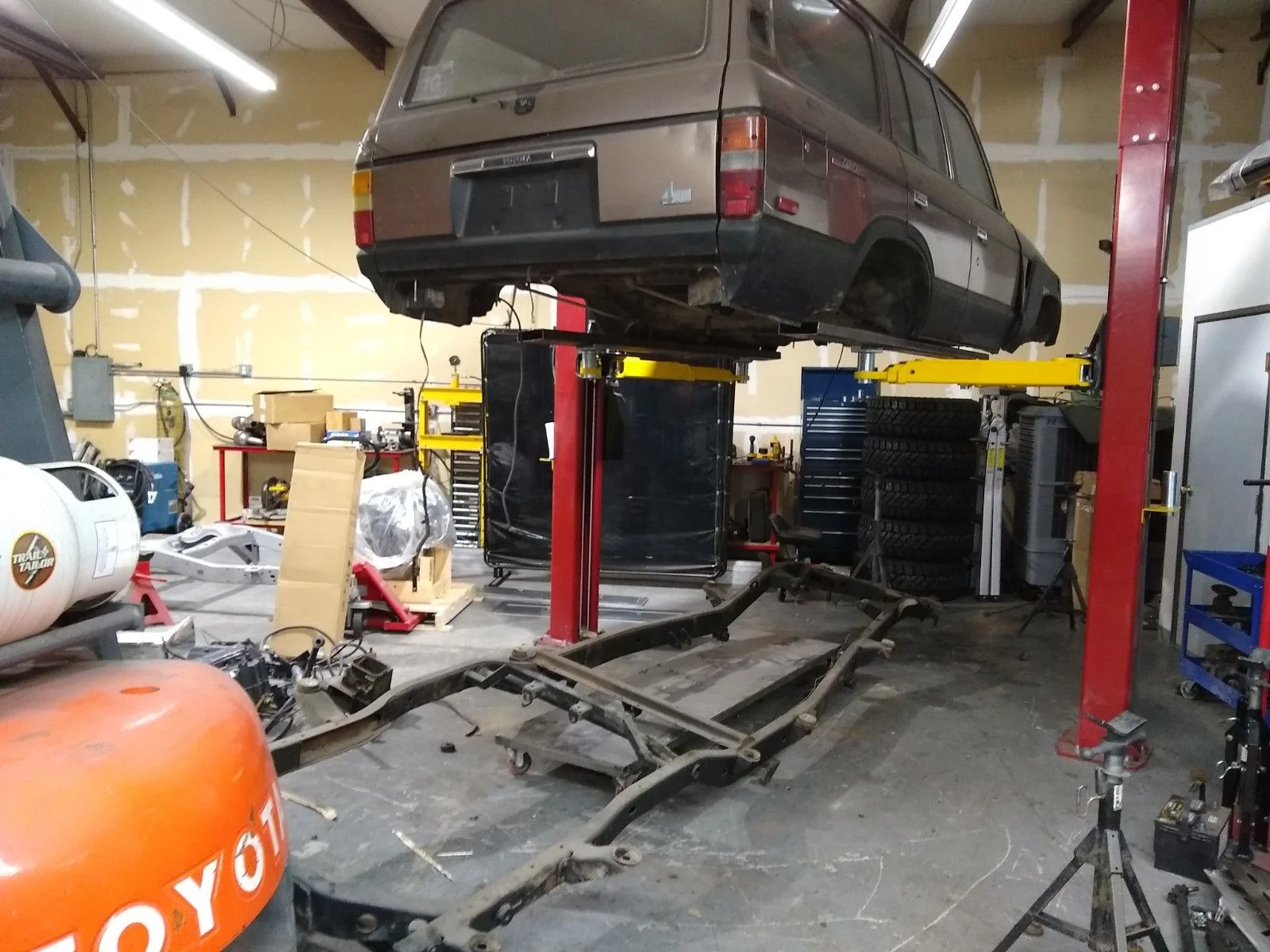

Got the body and frame separated and started hacking off body mounts. I think I will make a Trail Tailor version of these mounts for the other body/frame swap guys if they are interested @NCFJ @orangefj45 @torfab @FJ60Cam any interest?
J
Mark me down as interested for these as well Jason... may have one underway in my shop soon. Would be nice to have a supply of the mounts rather than custom making them each time.
Now that you have the cnc bender are you going to make replacement rear shock mounts the tube part? Reason i ask is because you saved that part of the chassis along with the body mounts.
That is the plan.
J
That is the plan.
J
Makes sense i have been thinking of doing the same thing but dont have cnc bender have model 4 from jd square my buddy @Str8Razor just got your old bender off you not long ago. If you can make that witch i am sure you can i am sure alot of guys will purchase one for just in case...good job man and definitely offer the body mounts the frame swap is getting almost as popular as ls swaps
I have the shock pins drawn and about to go to the lathe when its free. Two pin diameters of course.
