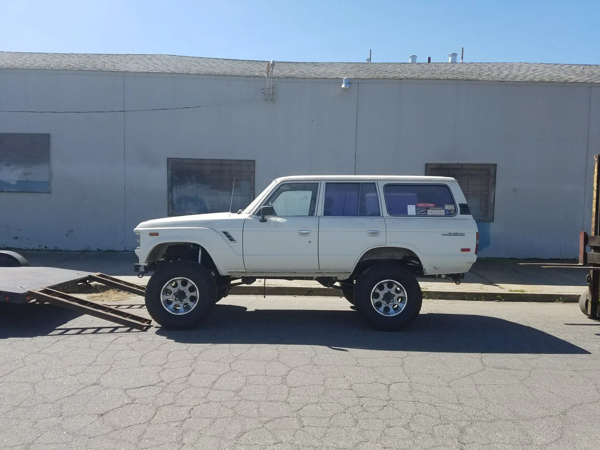

This type of build is a dedicated tourer, not a crawler, and the extra wheelbase will give you better handling at speed and give you more room for all the glamping necessities....plus the dimensions are just more appealing to the eye when stretched a little.
Fj80 frame with fj60 body

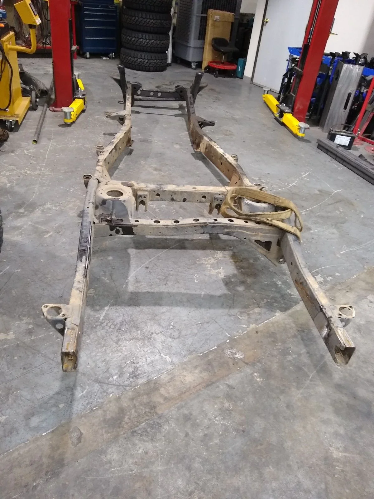

Stripped all the brake and fuel lines off the frame.
Decided to stretch the frame 24". This will roll the rig out even smoother on the highway and also give me extra room to extend the canopy boxes and rear pullout drawer.
J
Sure is going to be nice to work with a clean frame.
J
One you go clean you'll never go back :) Everything that rolls in here gets a good pressure washing before a bolt comes off. I can not stand working on nasty greasy dirty trucks. Cleaning them well makes the whole experience sooooooo much better. Blasting makes them a pleasure.
I got in this habit just out of high school when I worked at a place that built and serviced trash trucks. The shop manager refused to allow a dirty truck in the shop. I watched him send many a truck away to be steam cleaned, saw him send poorly cleaned trucks away again until they were truly clean. I was fortunate, I spent 90% of my time building new trucks.
I've gotten into the habit of only buying P&O steel and bare/stripped tube, etc anymore as well. Mill scale and protective greases are not a friend of mine. Other than the engine area, the frame is fairly clean. Of course being a California cruiser, no rust to speak of.

Got my line dialed in for the cut and have all the plate ready to bend for the inner frame sleeve and then the outer will be reinforced as well. I plan to make the frame extension as invisible as possible.
