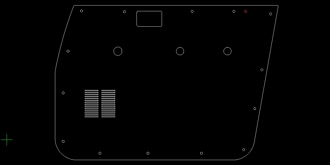

With my rib injury I'm on extreme light duty. So, a good time to catch up on what seems like my never ending to-do list.

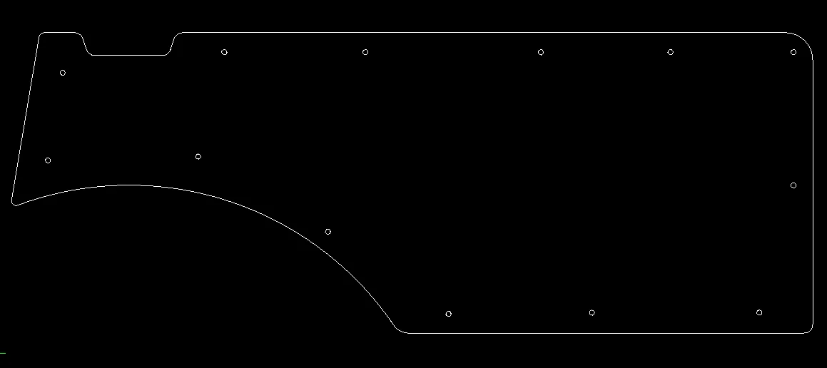

Getting the door cards reversed for aluminum. These will be available in aluminum and ABS soon on the website. By the end of next week I should have all panels for the 60 ans 62 finalized. I'll cut all the aluminum and my neighbor that builds custom concert speaker boxes will make all the ABS. He has a vacuum CNC router table and that way I don't have to convert my plasma over to router.
MORE TO COME!
J
60 front panel. I need to get the map pocket holes plotted and play with the speaker slot design. Most guys will cut this out and install 6.25s over the factory 5.25s.

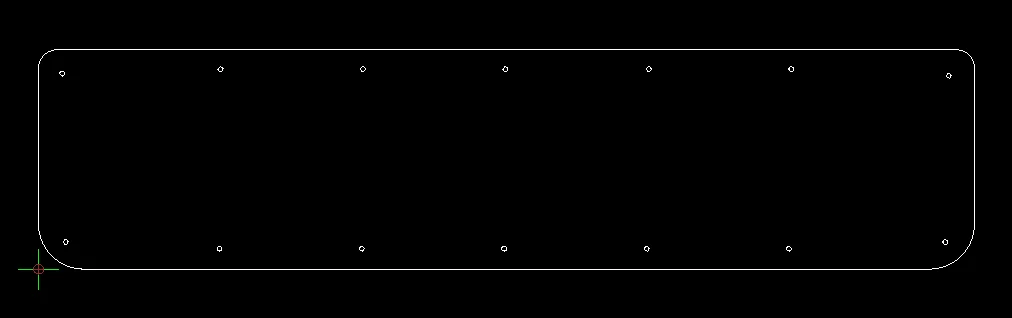

60 rear panel

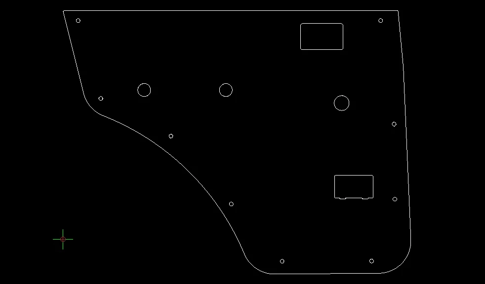

Early and Late PS and Early DS

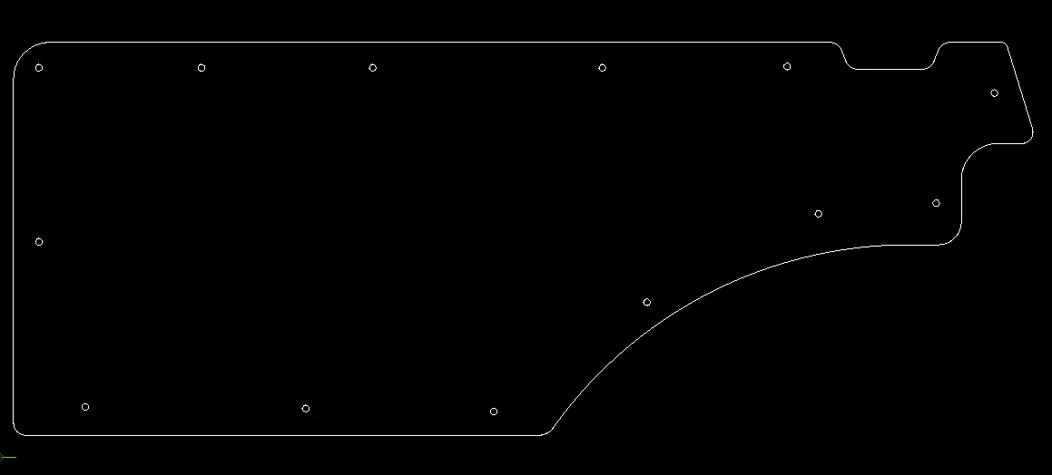

Early PS
MORE TO COME!
J
Early PS

This will be a very welcomed upgrade! Any idea on pricing?

Should be around the 450.00 mark for a set of 7 panels in ABS. Aluminum bare metal around the 750.00 mark for 7 panels.

Will we be able to just buy the rear panels? or only as a complete set. Some of us got the cards out of AU and have no rear panels.

Stupid question ... Will these work on the 62? It's been so long since I had a 60 that I can't even envision the panels.
They will once I get to those designs... HA
I like your style. I'll be honest ... Have been considering getting panels redone, but would prefer to have this over fabric that is just going to get wrecked again in a few years. Well done sir.

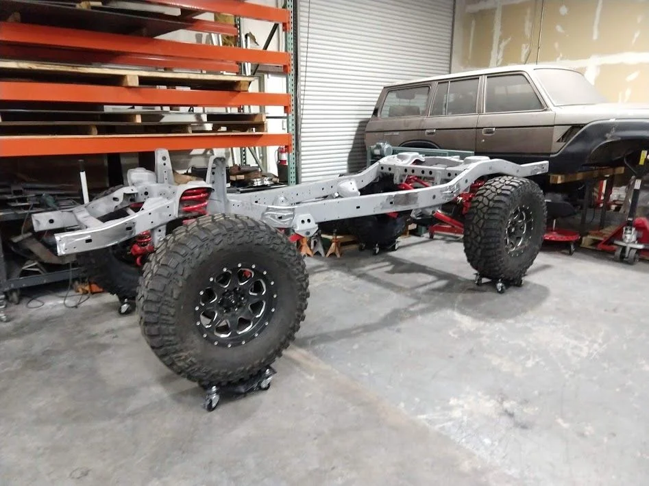

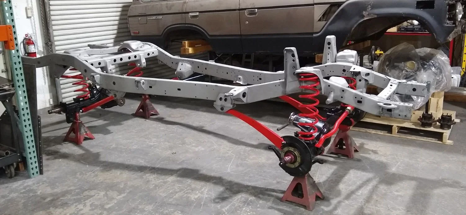

Sometime next week I'll get back to Dingo. With my current injury its a slow healing process and I've got a couple of guys to come in during the week and on weekends to help me when needed on heavier lifting.

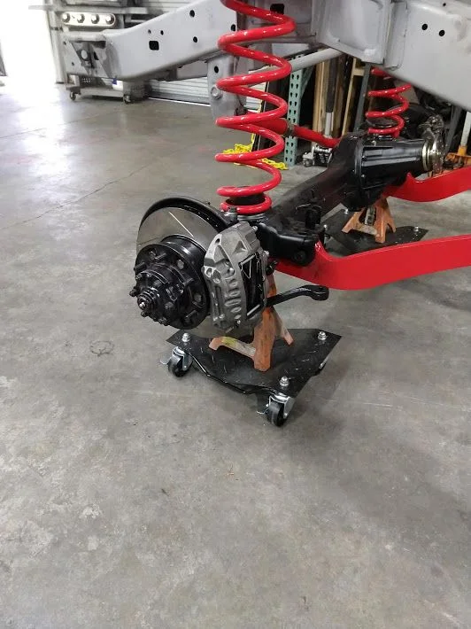

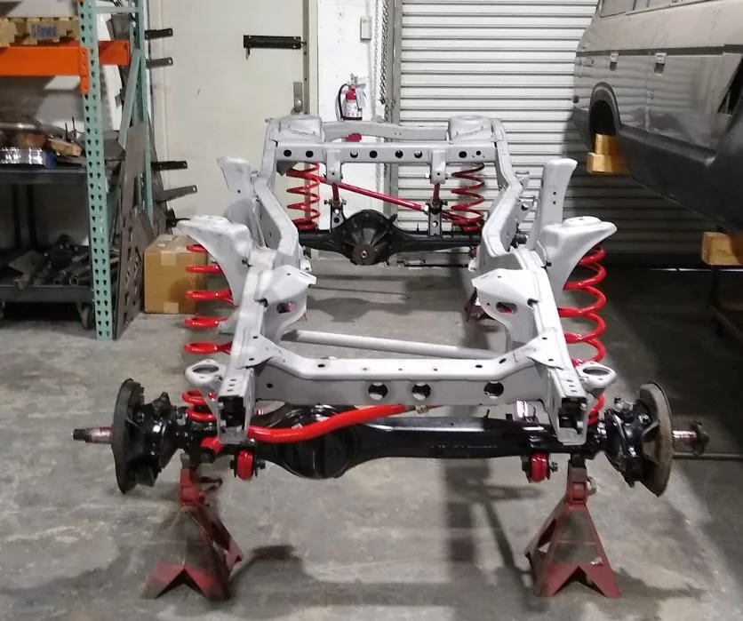

So back to the suspension and body mounts. Got the new body bushings this week and now I can design the mounts for a proper fit.
J
