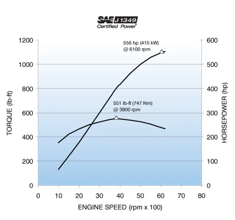

Seeking the forum members suggestion for a diff ratio for an LSA swapped triple locked 80 series with a 6L80E transmission. Tire size would be either 33” or 35”.

Motor specs:
  • LSA 6.2L (376 cu in) supercharged
  • 556 hp @ 6,100 rpm
  • 551 lb.-ft. @ 3,800 rpm
  • 9.1:1 compression ratio
Power Curve
Picture attached.
Tire size haven’t decided yet. Either the BF KO2 315/70/17 which is a 34.4” tire or 285/75/17 which is a 33.8” tire.
Yes and the optimal RPM while cruising at 120KM is between 1,900 to 2,100.
