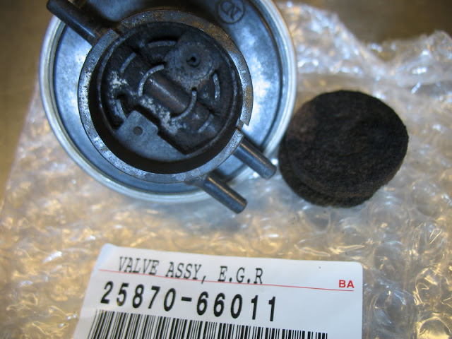

I'd been having a rough idle when I came to a stop after warmed up. Was worried it might be the AFM, which someone had opened up and messed with previously. Then I saw another thread with suggestions for causes of rough idle, so I took a look at the EGR. Sure enough, I pulled the vacuum hose off the EGR valve, and the idle smoothed out right away.
I took the Back Pressure Modulator Valve apart and this is what I saw.
It was totally blown out, replaced it, and now everything seems to be operating properly. I know some would say, why not bypass the EGR, but I like to keep things working as designed.

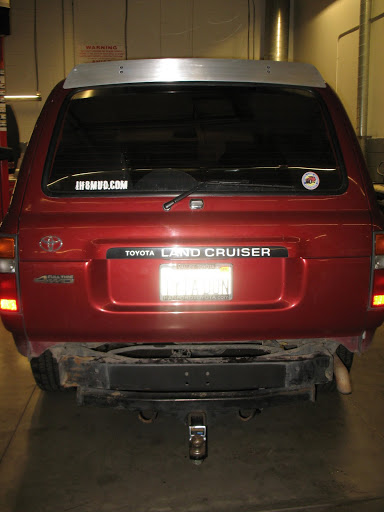

Time to update this project.
The other day I decided to un-paint the rear wind deflector.
It was peeling and needed to be cleaned up.
Ended up with kind of a brushed finish after careful sanding, in a straight line.
Mounted up, I'll see how I like it, may end up painting black again, or see about powder coating.
