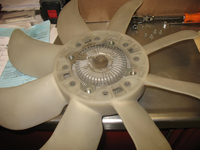

I got the blue hub fan clutch yesterday and installed it on my lunch break.
On the way home, the A/C stayed cold almost all the way, until I got into town. The temp gauge had stayed just below center, then right at center, and at the first stoplight it started creeping up.
Overall the fan clutch seems to be making a difference, especially on these 102° days.:eek:

You should look into changing the fluid of the Fan Clutch to 10K or possibly more, I need to this as well for those hot days In Cali!
I did take my old Aisin fan clutch (black hub & adjustable) apart and add OEM 10K cst fluid...

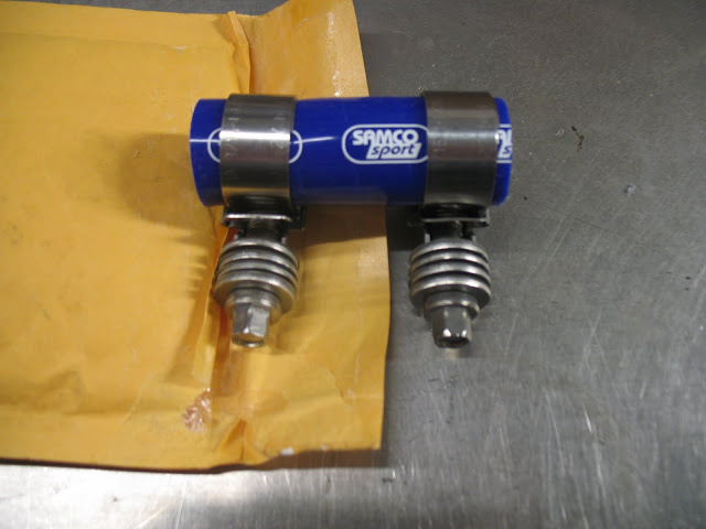

Nice, just did my FHH and PHH hoses in Samco Silicone the other day.
Looks like its coming along nicely. :beer:

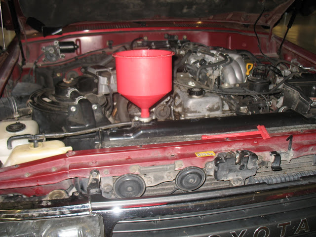

Refilled with 50/50 mix of Toyota red and distilled water with my handy-dandy Smart Funnel.
Drove home that night, but still seeing the gauge creep up at times. :mad:

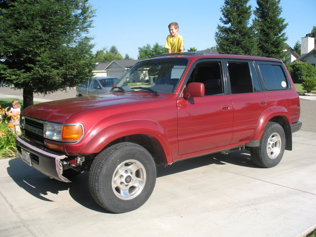

Glamour shot
Notice the missing hub caps? I had a professional paint them for $20, turned out nice.
