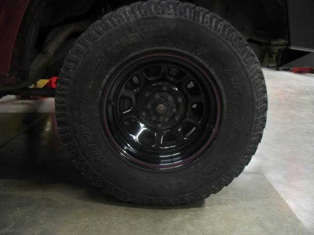

Now for the wheels & tires.
They are 31x10.50 15s and are pretty worn out. This is probably the best one.
I did mount them on the Cruiser, and lowered it down to almost normal height, so here's how it looks.

I just found out why they went to 16" wheels in '93!
REAR DISC BRAKES!!!:doh::doh:
The wheels I got won't work without spacers, so back to the stockers I go. :bang::bang::bang:
