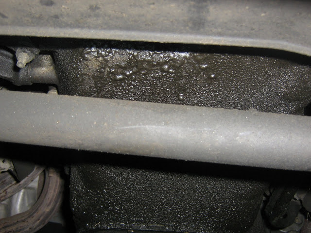

Front of oil pan, I'm guessing front crankshaft seal, possibly oil pump o-rings, etc.
Rear main?

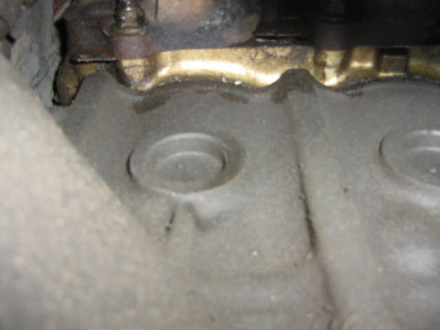

So, on to more good news. When I had it in the air, I took a look up toward the head gasket, and this is what I saw.
Does that look like some seepage to you guys? How long can you go with seepage happening? I know, I know, until it blows.:doh:

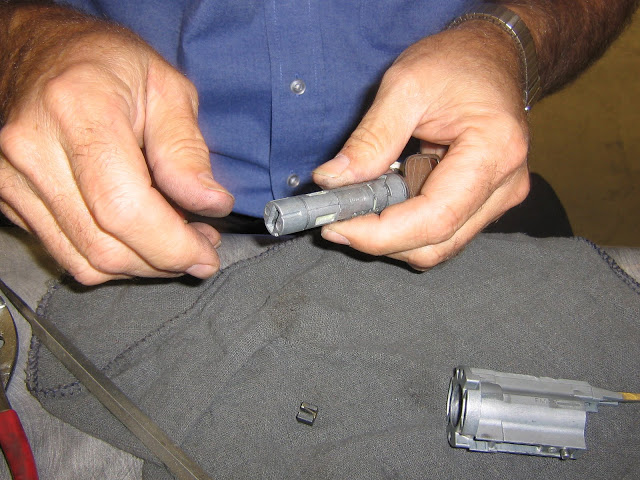

The key I got with the Cruiser only opened the driver's door and operated the ignition, so I had two new keys cut from code. The new keys opened all the locks, but wouldn't turn in the ignition.
One of our parts guys has been around awhile, wrenching and working the parts departments, so he has all the stuff to rekey these locks. He brought his kit in today and fixed me up.
Once he had them all right, a little work with the file cleaned up the rough edges and had it working like a dream.
