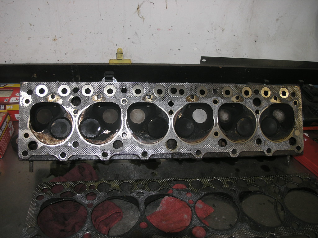

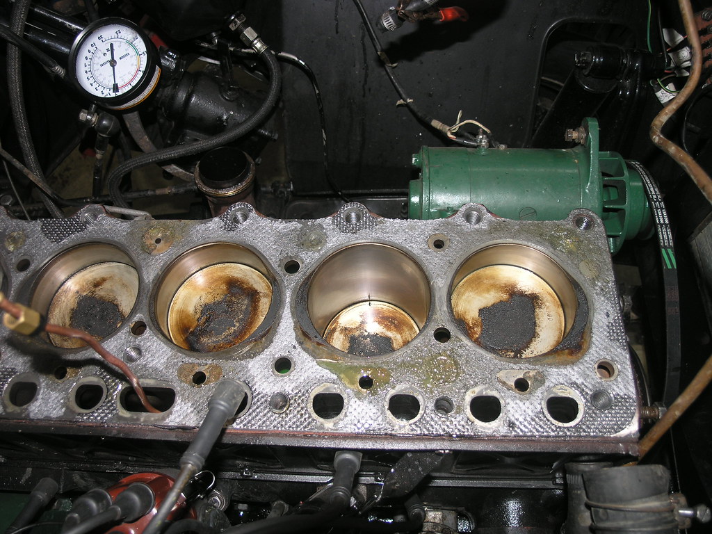

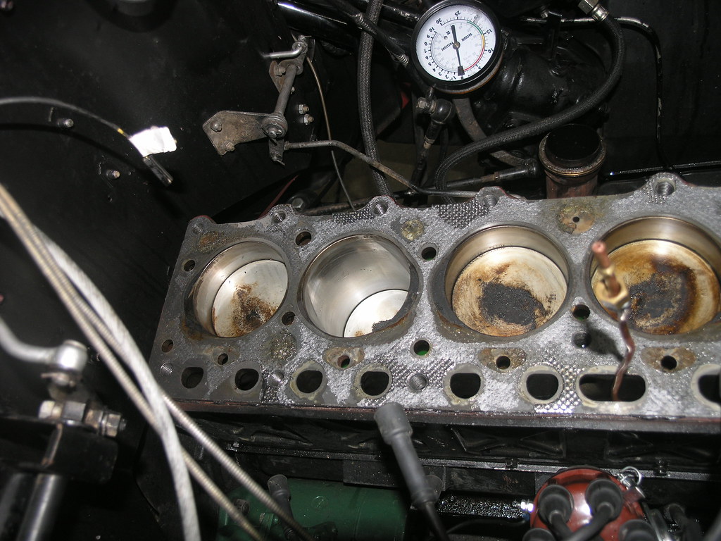

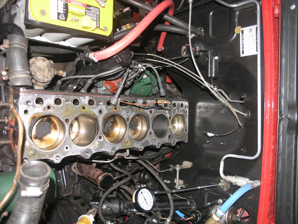

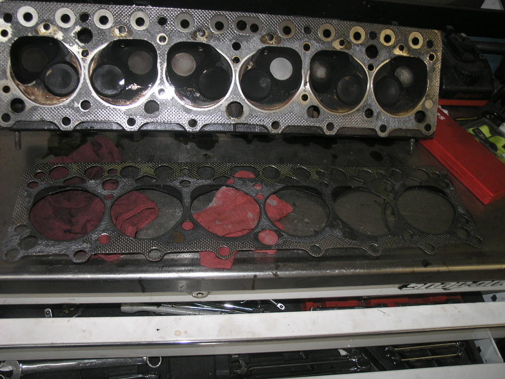

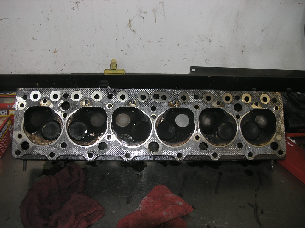

here are some photos of the head, composite head gasket, and the engine etc
I guess cylinder 5 and 6 where full of coolant.
Soounds like the rebuild place will fix the head etc and hopefully all will be ok, assuming there was not lower end damage.

Was the head painted before or after it was installed? If before did they remove the paint from the top of the head on the drives side where the head bolts go. If not the paint can get soft and squish out causing headgasket failure. Ask me how I know.
They painted it afterwards ( their paint even )
ok so chatted with the engine rebuilders, everyone was nice and cool.
They said there is zero signs of over heating, they said the heat plugs/spots where not even melted ( have no idea what this meant )
They said they would magniflux it later today/
They said definitely 5 and six is where the gasket blew.
I told them i like to use OEM toyota gaskets, and gave them the part numbers and Cdans phone number at american toyota. They are thinking likely bad gasket, but they really had no explanation of why it happened, and they are convinced it is not overheating and all is cool on my end.
I have been told that the deposits of carbon could be just the begin breaking in and just normal until the rings seat, which i was also told could take more than 400 miles depending on the ring materials.
Also could be because it was running a little rich...
LCNW said they would do a compression check and see where s*** is at after they get the head back on etc.
