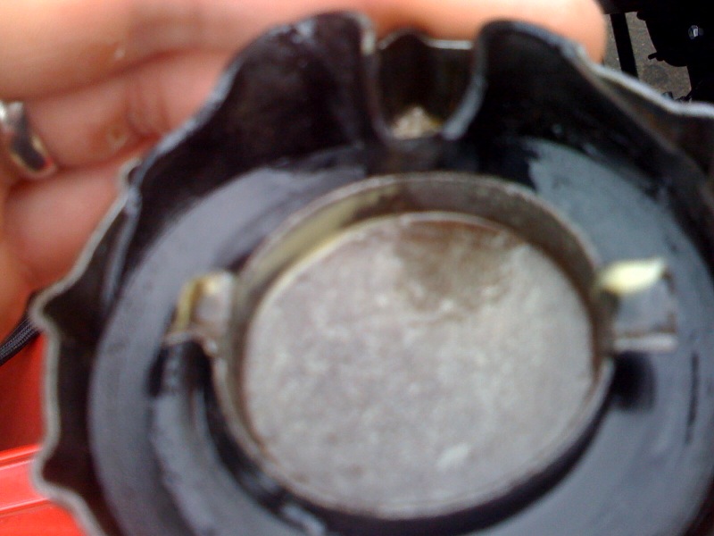

I agree with the cracked head or headgasket, is the oil frothy? Look at the bottom of the oil cap for foam ...
Tucker
no foam but there was some weierd milky stuff under the cap...
I cannot see where it could be leaking outta the head gasket, but i guess it would be just a high pressure leak when running...

That looks like oil and water mixed under the cap. They should have put correct amount of oil in it, so once it ran the oil level should have been correct. So most likely you lost 3 quarts of oil over 400 miles, either way 2 quarts is still a problem. Good luck, hope they honor their rebuild. If they should have checked the heads and blocks for cracks and also for warps so this is really odd for a fresh motor.
That looks like oil and water mixed under the cap. ...
Correct, would be interesting to know if Destin had seen this mixture before the head gasket cracked, it`s a warn signal to change the head gasket immediately.
