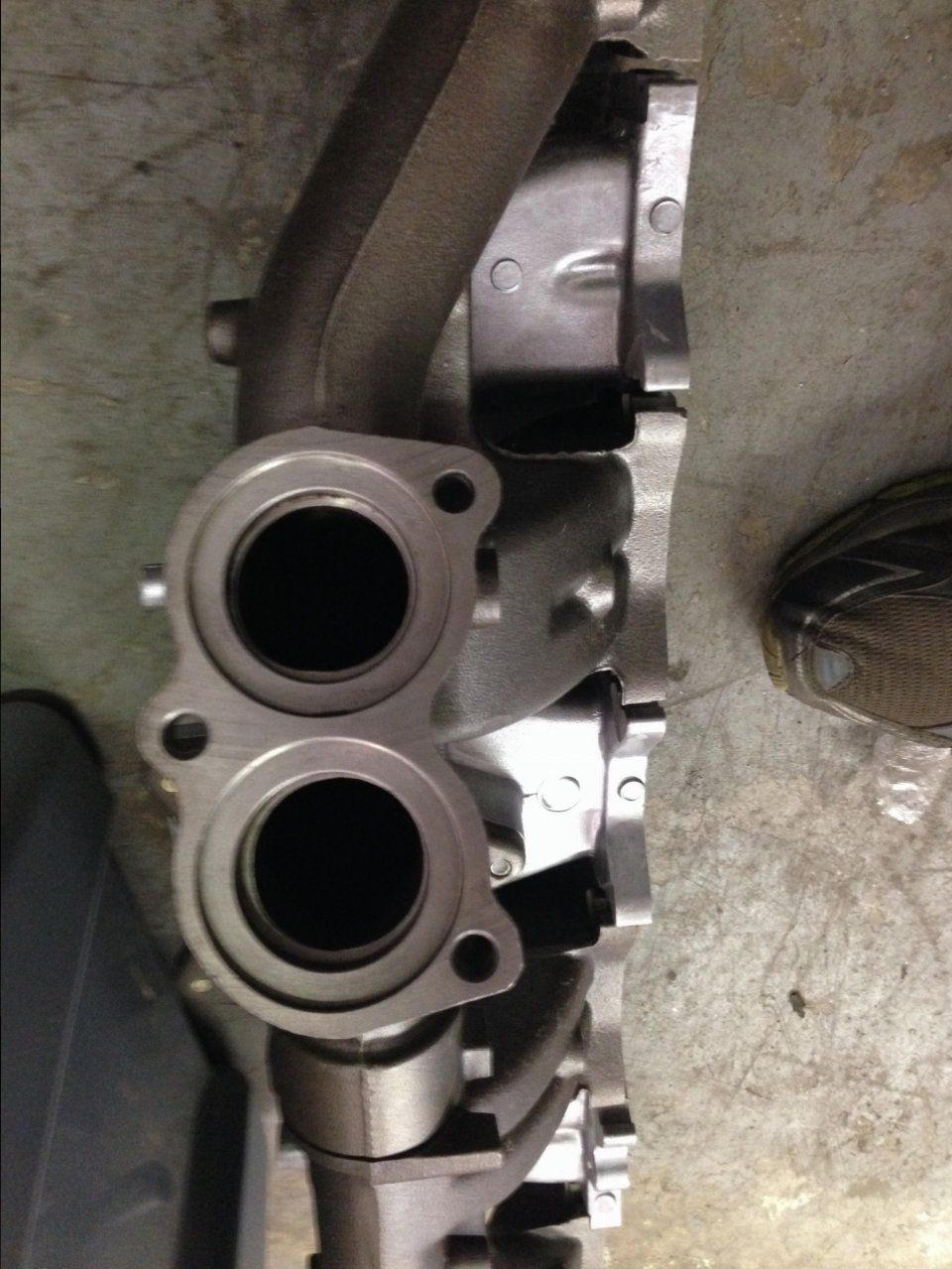

Also, not that anyone on earth may ever encounter, but 3F exhaust flange is specific to 3F manifold, and 3FE won't work.
Sir Harris has agreed to sell back the 7X down pipe, as it appears it will work, this after hours and hours of measuring, in an attempt to determine viability.
