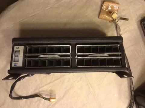

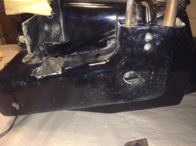

'76 evaporator (modernized? modern fittings?)

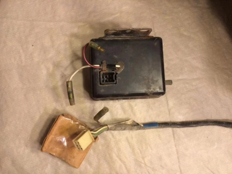

'76 amplifier (??. Don't know what this even is)
'76 Harness (??)
1. Since the 3FE was fuel injected, how can idle up be accomplished with vacuum? Is that irrelevant?
2. Modern fittings and hoses sounds fine, but what needs to be done to the evaporator core? What about fittings exiting firewall?
Brett pressure tested and, pretty sure, he said the evaporator core was fine to use, but not sure if that means that hoses can be made to work with the existing fittings, or if it all needs replaced.
3. What does the amplifier do? It has an adjustable rheostat, but doesn't appear to be accessible, once the evaporator is in place.
4. Surely the pro's could figure out, but the '76 harness appears relatively simple....perusals of the 3FE are not.
What controls the compressor, or better yet, is it possible to adapt the harness to the 3FE compressor?

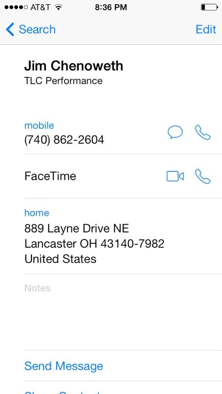

how can i get in touch with one said mysterious and elusive "Jim C.?" I tried once before to PM him, but nevet did figure out his contact.
Fj40jim@gmail.com
Best to email or leave message.

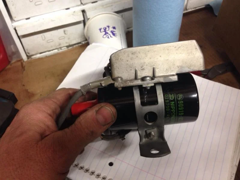

If the lead time is longer than you can wait, I may be have an extra. Know I have a Petronix unit from Pighead that Mark A. recurved, but think I have an Asian as a back up.
I, at least, have one and it may be years before I need.
i can wait 2-3 weeks, if that is needed. i would rather wait then have to r&r the dizzy. it can be aggravating enough doing it the first time. i will contact Jim tomorrow. thanks for the offer. i ,ay be at your mercy anyway if he says that mine is irreparable.

Could pull the dizzy from the '71, also. It was desmogged by a PO and appears to have been done correctly, so assuming advanced and useable.
