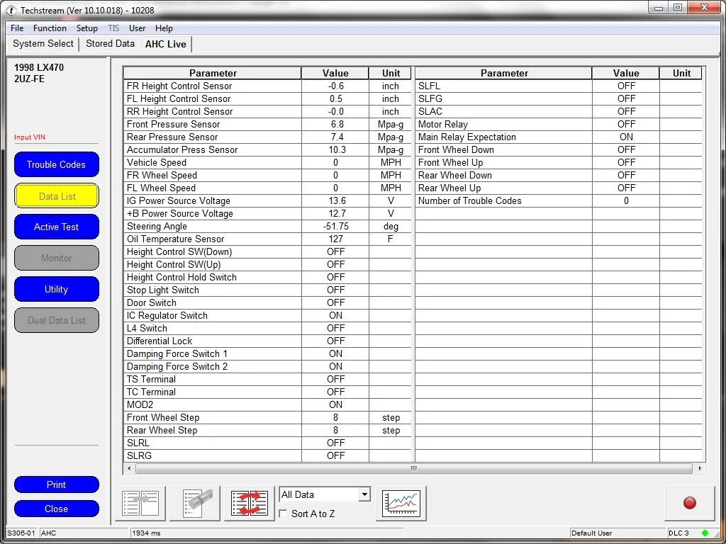

I finally ordered techstream and finally got it installed/working after much frustration. If anyone in Atlanta wants to use it or help installing it, PM me.

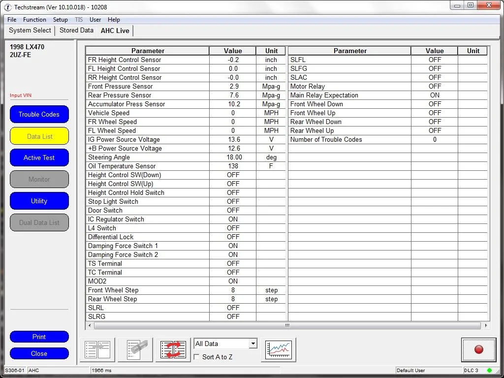

While I was waiting for my techstream and rear springs, I figured I would crank each torsion bar one full turn clockwise.
Is this possible, front pressure=2.9? Did I go way too far? This is with the truck running, N to L to N - reading.
Is my steering angle (18) affecting the reading?
I got the rear springs today, should I just go ahead and replace them and get a few turns on each torsion bar counter clockwise to increase front pressure?
2.9?? Spurious reading I reckon. Do a few more checks - L to N and wait 30 seconds till the height accumulator finishes charging and see what the consensus is. I've seen similar ridiculous readings before that come good after one or two more L to N cycles. A legit reading of 2.9 would equate to about 20 turns if you started at 7.0MPa, you'd have all spring and no damping.
As long as you're on flat ground and the front wheels are pointing roughly straight and you aren't loaded up then that's good enough. Don't be too concerned about the steering angle that Techstream is reporting.
Thanks guys! One full counter clockwise turn on both torsion bars, new rear springs (no spacers) and a couple of up and down cycles.
Now 6.8 and 7.4.
What are the goals 6.9 +/- 0.5 for the front and 5.6-6.7 in the rear?

How concerned about -.6 and +.5 front height sensors?

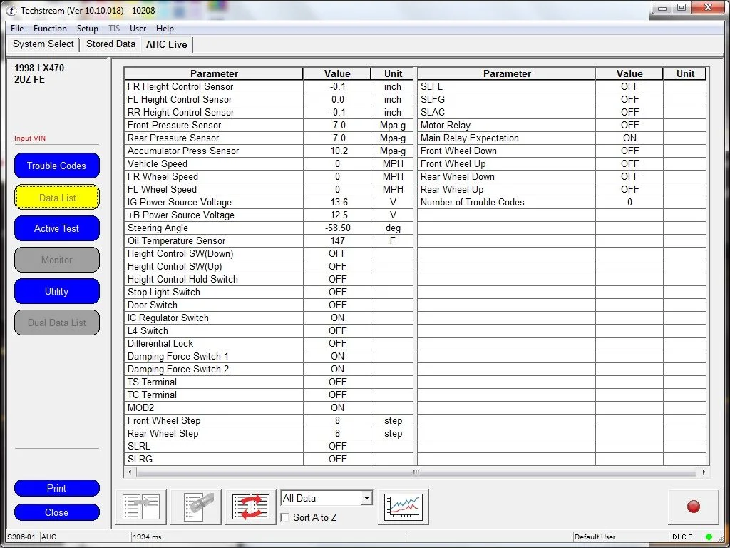

Found a flatter piece of driveway, using a 3' level...
Not sure a couple torsion bar tweaks made a difference.
Is this as good as it's going to get for the rear without spacers? (these are new springs) 7 and 7?
Much better. If you're interested you might try experimenting with the front pressures, maybe try a little lower and see how that responds. It's all about finding the best combination of mechanical springs (torsion bar) and gas springs (remaining charges in your damper accumulators). Your rear pressure isn't going to lower unless you jettison weight or drop the vehicles height. Adding 30mm spacers while you've got the springs out will normally give you another 0.6MPa pressure reduction. I haven't encountered anyone yet who has had to deal with too low rear pressures by adding spacers on new AHC coils.
Regarding the factory pressure tolerance and range. The front's design pressure is 6.9 MPa and the design engineers concluded that the acceptable deviation from their design pressure is +\- 0.5. There is a marked difference between new globes and 6.9MPa and how it performs at the outer limits of the tolerance. For the rear we obviously don't have 30mm bolts to dial in/out tension so the designers gave us a range of 5.6-6-7MPa but the best I've heard off is for new coils to get the rear's pressure down around 6.3 or 6.4MPa. It doesn't take much weight (about 210lbs for +1MPa over the axle) to creep up into the high pressure/poor damping and drop to L when loaded up zone.

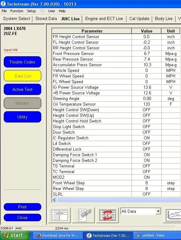

@PADDO, How critical is is to accomplish the "0.00" reading for the height sensors? Also, I'm ok with the rear pressure reading here correct? This is with half a tank of fuel, and no rear seats. I've just replaced my OEM coils with new, 30mm Slee spacers and installed Air Lift 1000 bags in the rear. I adjusted the TB's a bit as the new rear setup had my front pressures at 5.9 upon first check with TS.
