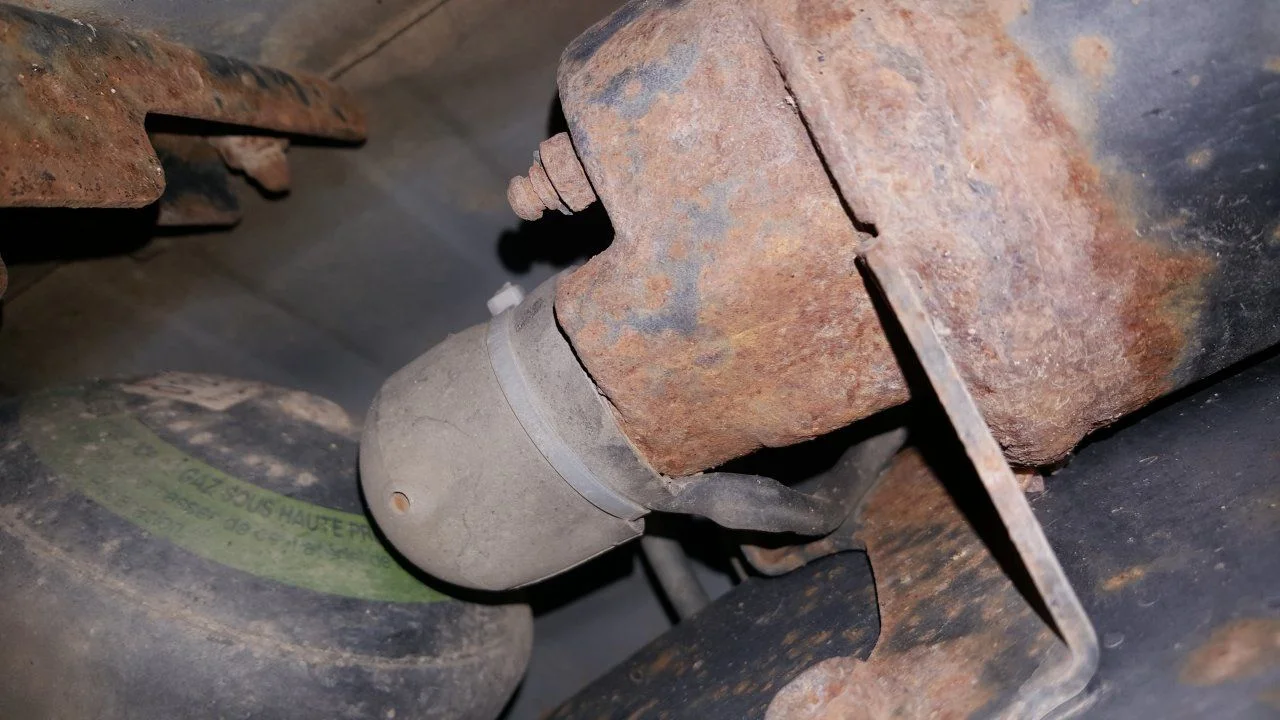

I purchased two cans of ach fluid to bleed the system. Im checking on your opions and knowledge if my globes are to corroded to try and bleeding myself. Im worried the bolts my break or get stuck during the process. Or should I leave this job to the dealer, or wd40 the crap out the bolts myself and dive in?
I did the globe check and got 14 marks between high and low, so the are in good working order. However, I'm currently low on fluid, two marks below minimum while in N. I am the third owner and the don't appear to have been bled before...
:hmm:
Doesn't look too bad, the rust.
If you have 14 grad's, and the globes are old, I would check if the heights and pressures are right. 14 is a number for new(ish) globes.

The damper globes will more than likely have a manufacturing date sticker, that'll correlate with your vehicle or not and tell you if they are original.
If the sticker is correct they are original. Date of March 2000...

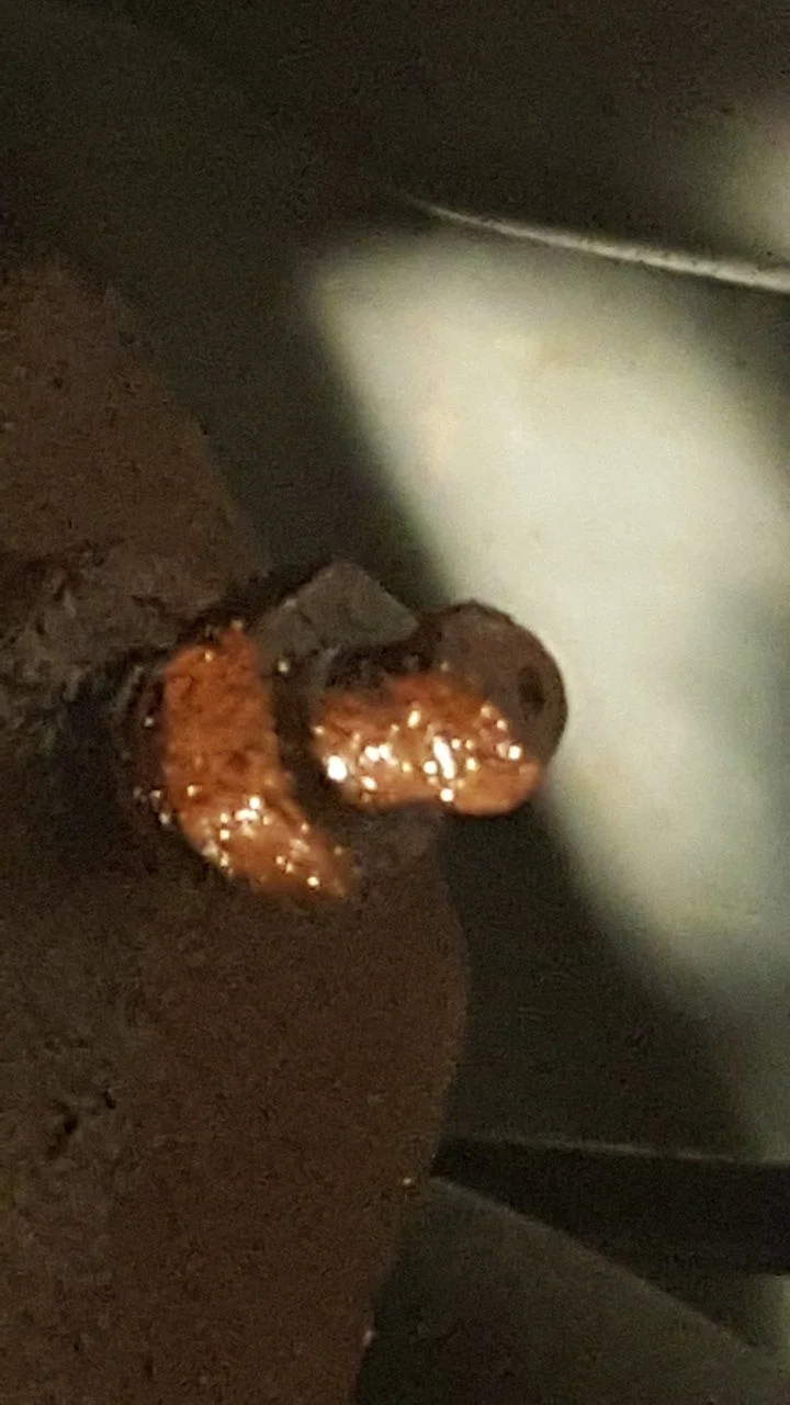

Does the bleeder points have a rubber caps on the end? I am trying to determine if mine does...pic attached.
The rubber caps are missing.
