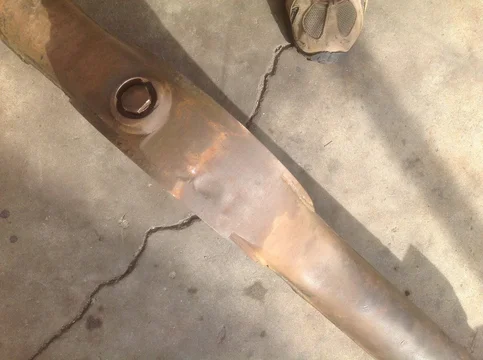

This is what a rear axle housing is supposed to look like. Full circle weld for diff cover and carrier to mate to, weld obvious.
This is what your housing looks like: crushed in about 1/4 inch, welds supplimented and ground down flush.
Got it!! Man this guy was ruff on these axles. I guess I will have to keep my eye open for a new housing since you don't have one.

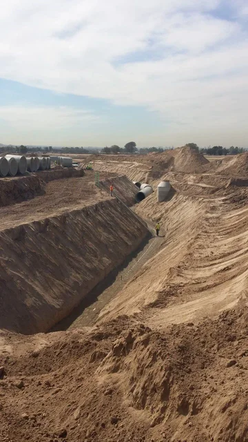

That's great civil work Dave! Thanks for sharing the cool photos!
Yes it's hard to backfill what I consider my art but there is no remorse after I get my check ;)
Money fixes a lot of things. It's kind of like the artists that make sand or ice sculptures except they probably aren't compensated as well.
