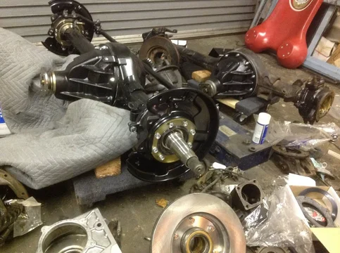

Heading home for the weekend now. Got the other spindle/backing plate assembly on, along with the steering rod. Shock hardware is ordered. One hub/rotor done. Got Gabe's tire carrier mocked up, finished knuckles on the Fireman's axle. i'm tired.
