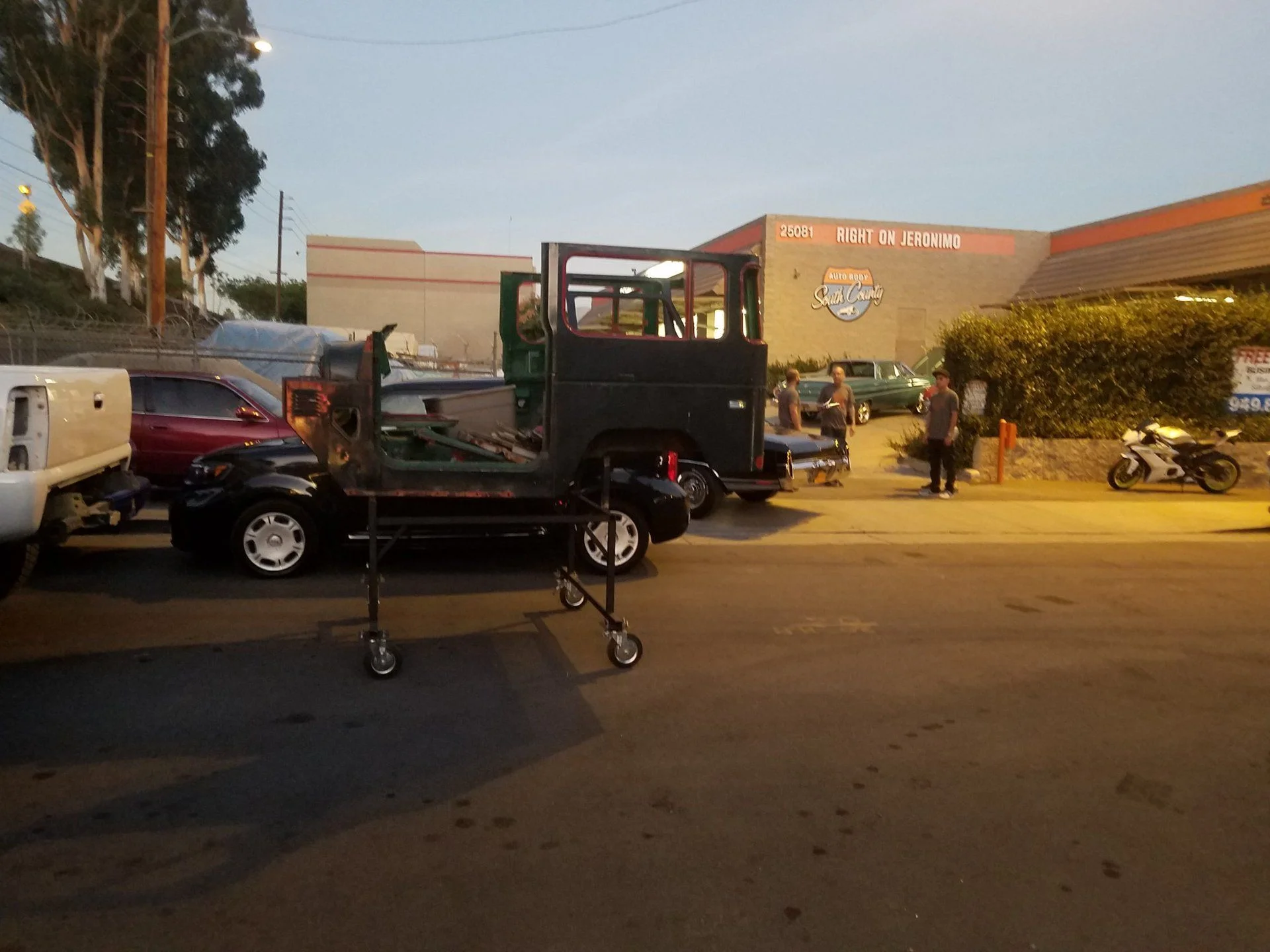

I have officially dropped off the rig at the body shop.
Next stop the dentist...for biting the bullet! :eek:

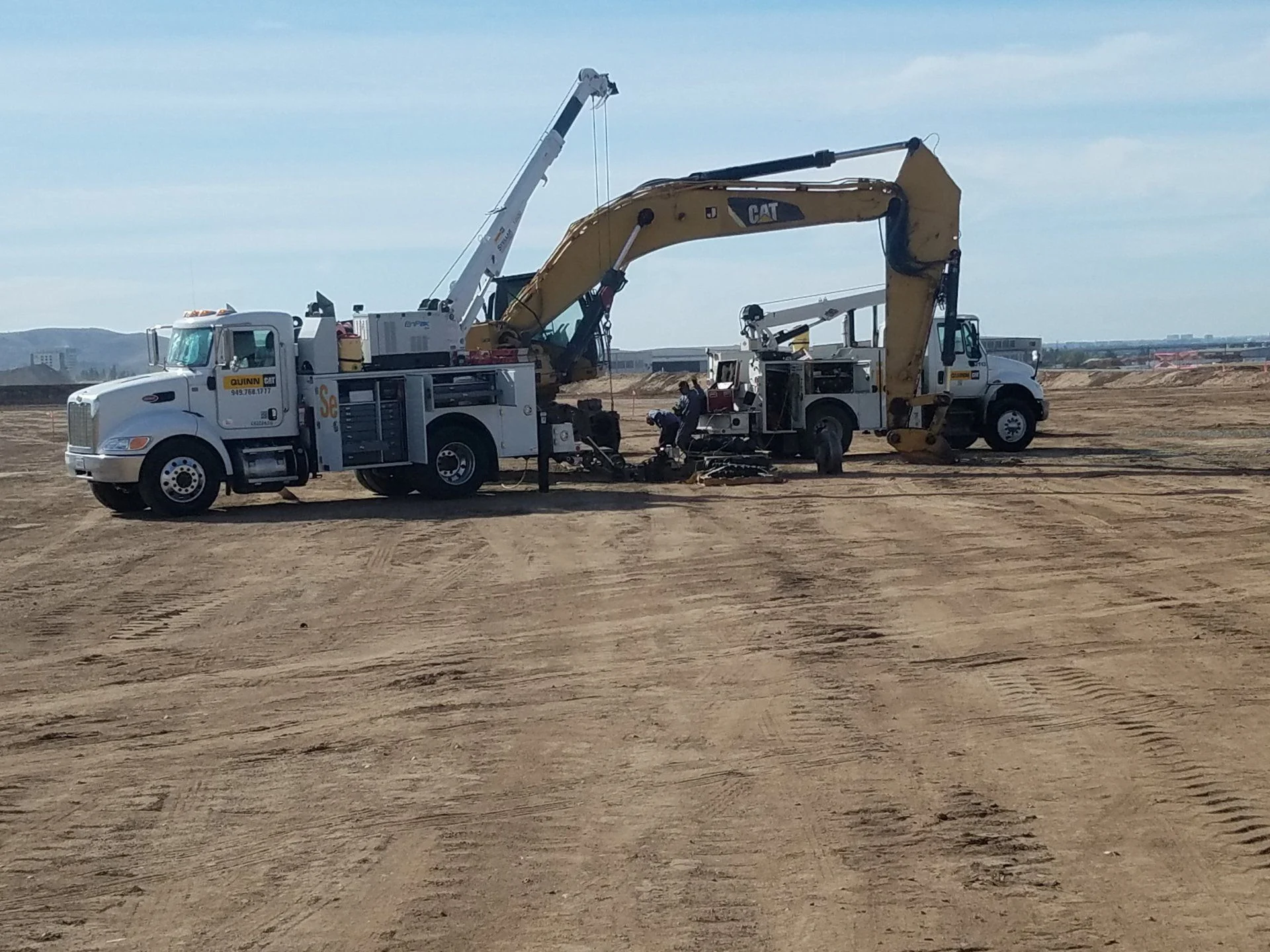

Not just the tracks. . . but it looks like new sprockets and rollers too! Don't see any new idlers in the mix though but I'm sure they'd be swapped out if needed. We recently replaced the track chain on our excavator as the pins and bushings were worn. Buzzed off every track pad and put them back on the new chains; not a mentally stimulating but tedious job. When I was a young fella I used to rebuild those track rollers for D8s, 977s, etc. -- pressed the innards out, installed them in a new shell, and pressed the collars back on. Quite the workout. . .
