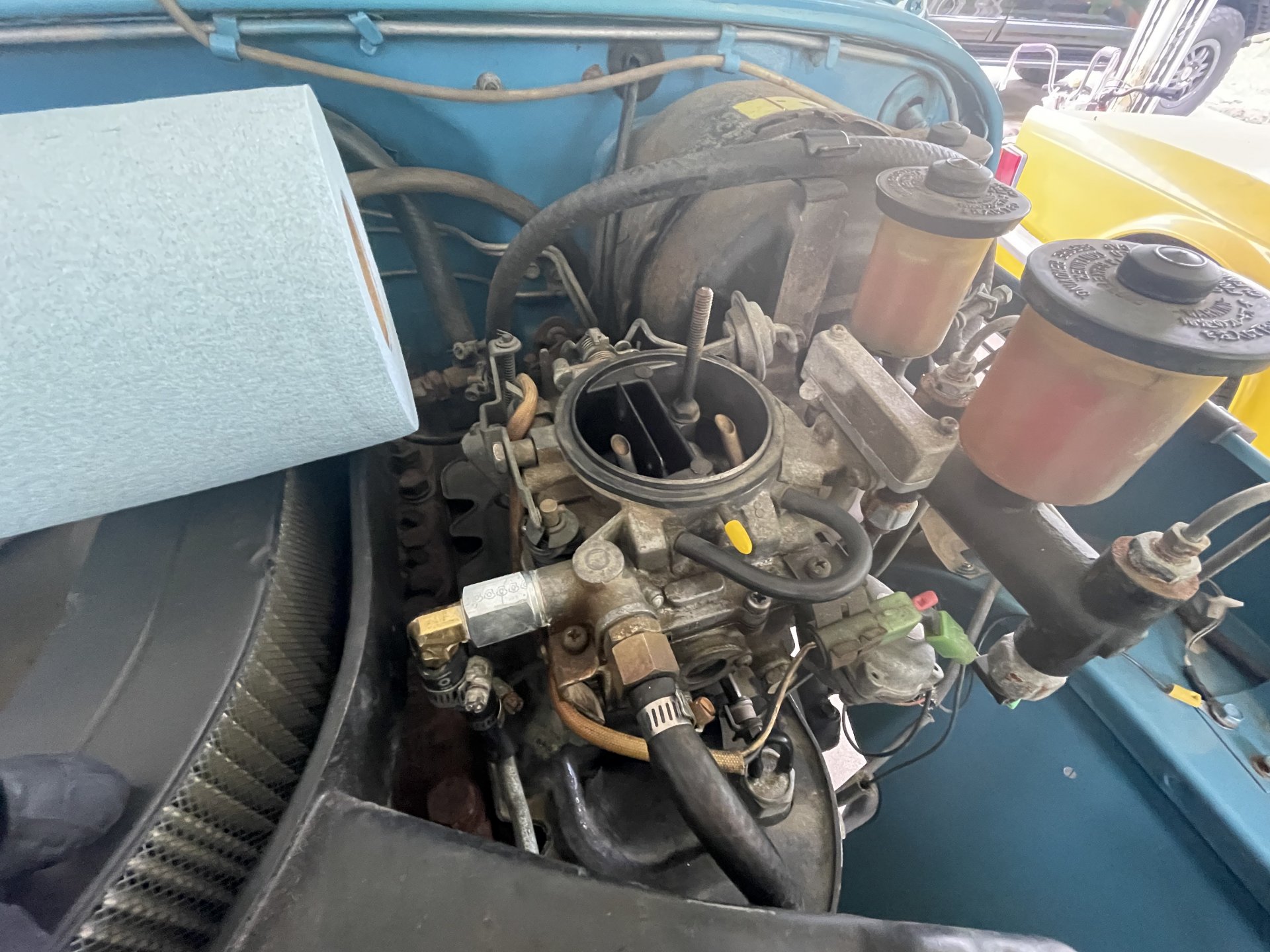

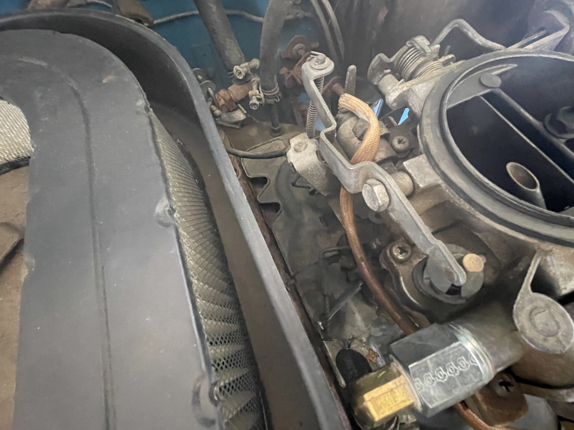

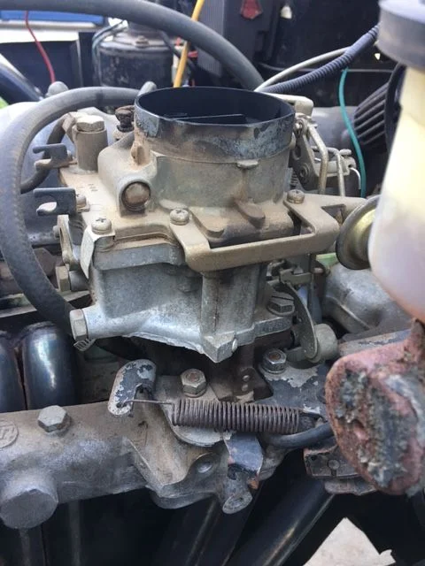

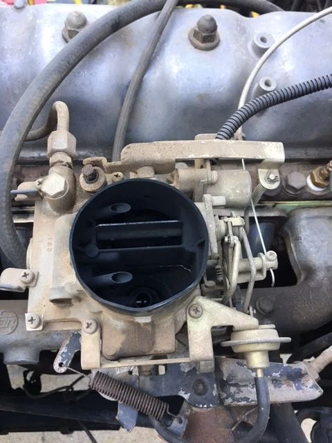

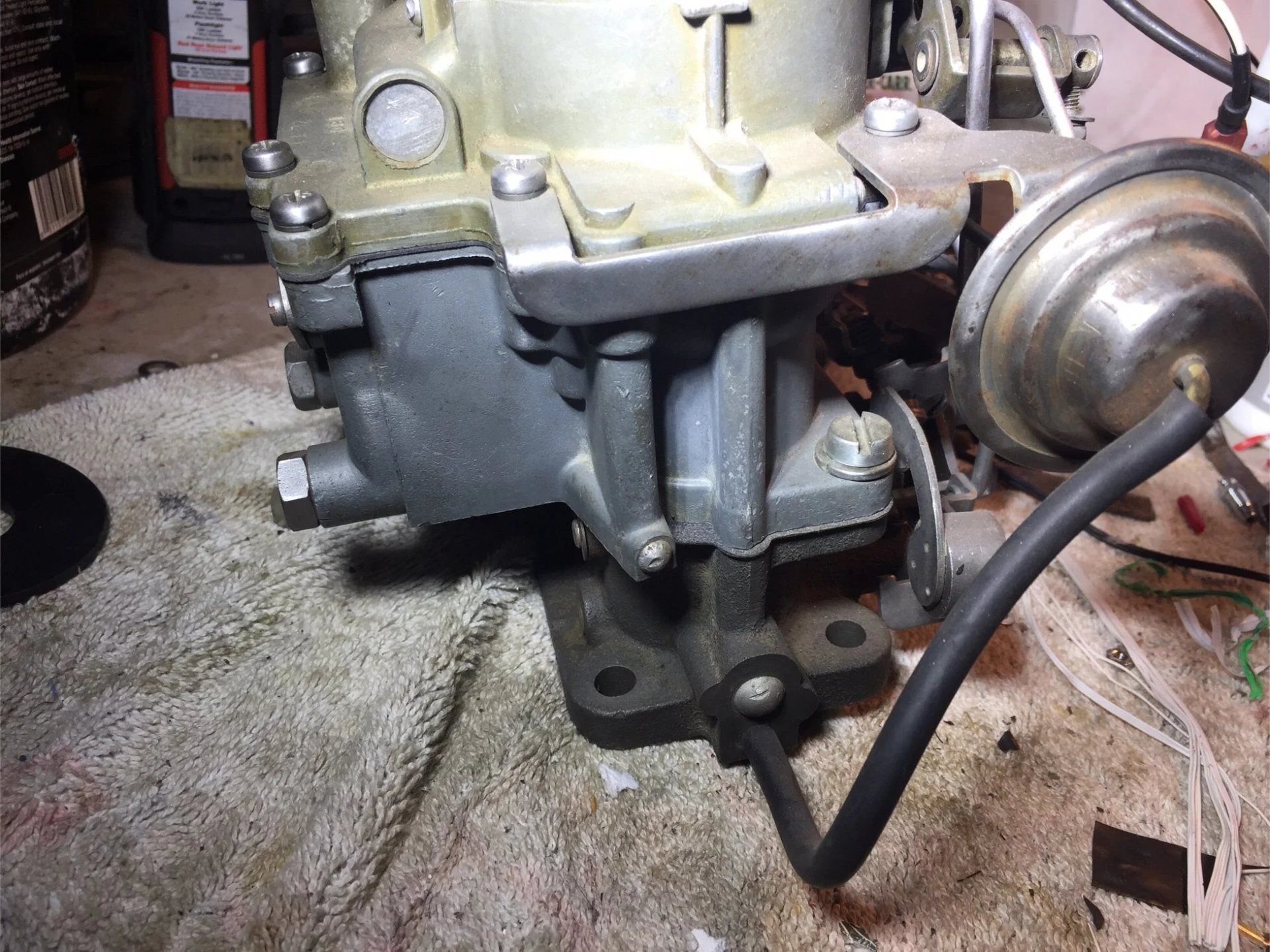

Could you guys help me identify this carburetor? Previous owner did a 2F swap in this 71 FJ40 and it looks like he may have pieced this carb together. There is a long stamped arm that was only available between 73-75 but those look like they have a return line and mine doesnt. Also on the lower half of the carb there are 2 ports (one of the ports isn't even hooked up) but the 2 ports were only available in 76/77 carbs.
The number stamped on top of the carb is 1 0 26, which doesn't follow the format mentioned at the beginning of the post. It does have a metal tag attached to a screw that reads 60361 if that helps.. I would like to get a rebuild kit and am trying to pick out the correct one, I have been looking on the SOR website to help ID what I have. Thanks for any help

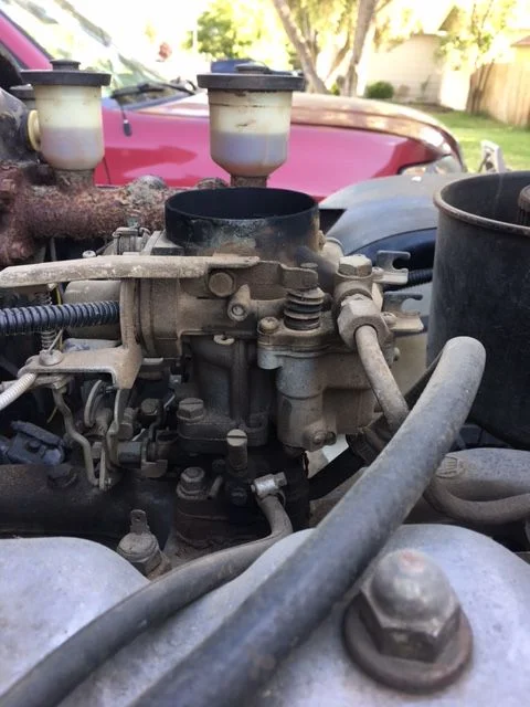

74ish carb body

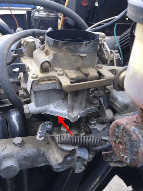

71/72 carb body
The carb body looks to be a 74ish. The secondary slow jet draws fuel directly from the fuel bowl(red arrow). 71 carb bodies are molded slightly different, in that the fuel passage to the secondary slow jet picks up fuel after the secondary main jet.
My guess is the air horn(carb top) is from the original 71 carb. Perhaps the 74's airhorn was more warped, bent or the choke butterfly was F'd up. Looks to be a 74ish throttle linkage as well. That said, I do sorta recall seeing FJ40Jim id a carb that was made in (I think 1981) but was for an earlier cruiser.
The port on the right is commonly drilled for a source of ported vacuum. So the PO may have added a vac advance distributor. I've never seen the location of the abandoned port(on the left) used. I'm still learning though. I'd think that at least needs capped.
The big difference between the kits is what main jet, slow jet and power jet sizes they come with. 71-74 gaskets interchange. I believe the carb guru's don't necessarily stick with the jet sizes shipped in the kits though.
Thanks for the reply.. I will get a gasket kit for the 73ish then and go through the carb.. Hopefully the jet size will be fine.. The thing back fires a lot as you can see in the picture, so a good tune up is in order.
Yeah I noticed the black. If you've been running it without that base port capped, that could be a contributing factor. I had the same backfire issue with my 71, it is my belief a lean condition was the cause. Hopefully you don't have a vacuum leak at the manifolds, I did. Make sure your idle solenoid is working. At idle you should not be able to see fuel spray. If you shine a light down the primary(passenger) barrel and can see fuel, something is wrong. Make sure you get a stong squirt from your accelerator pump plunger (I've learned a big a** squirt is imperative).

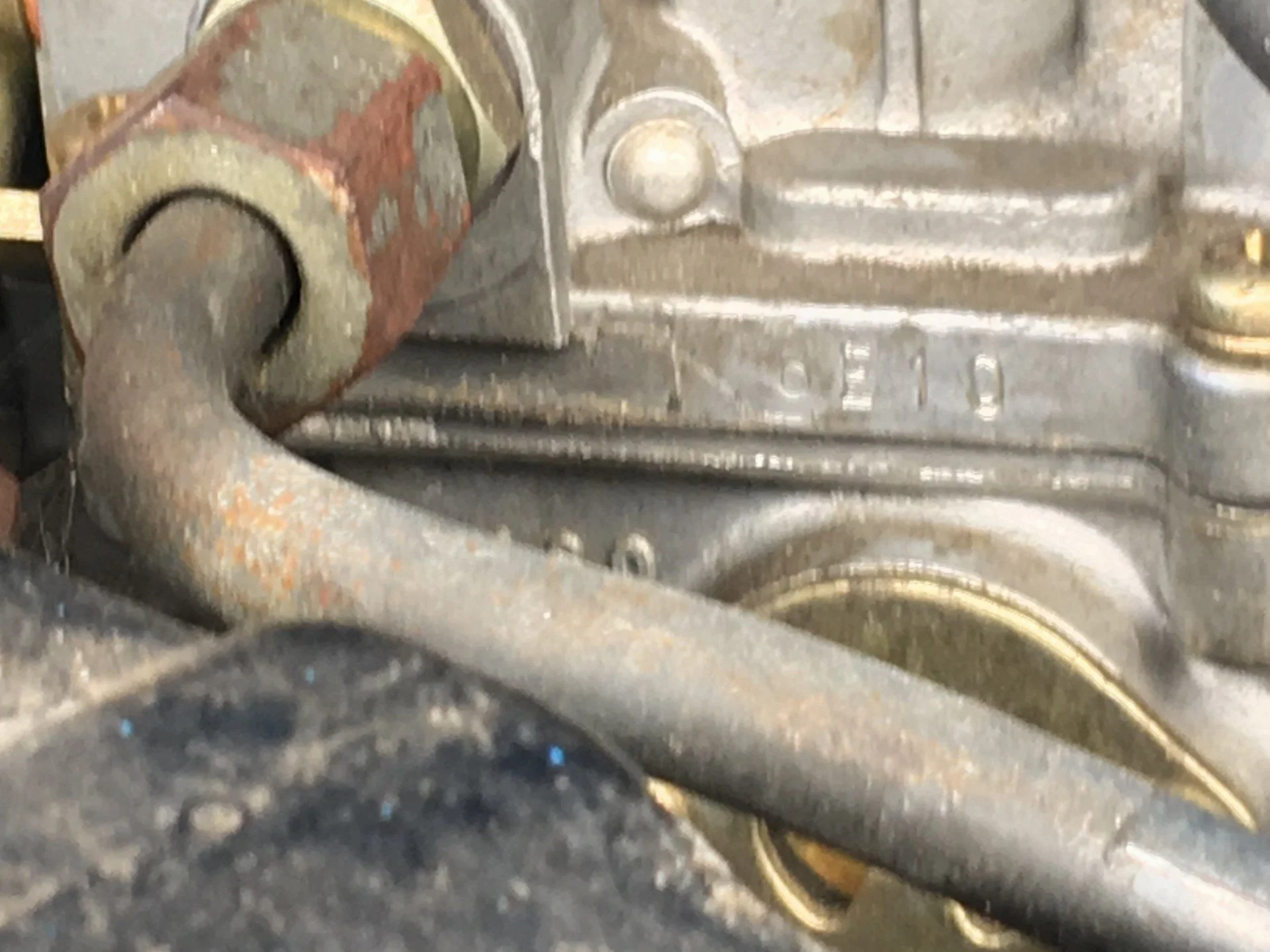

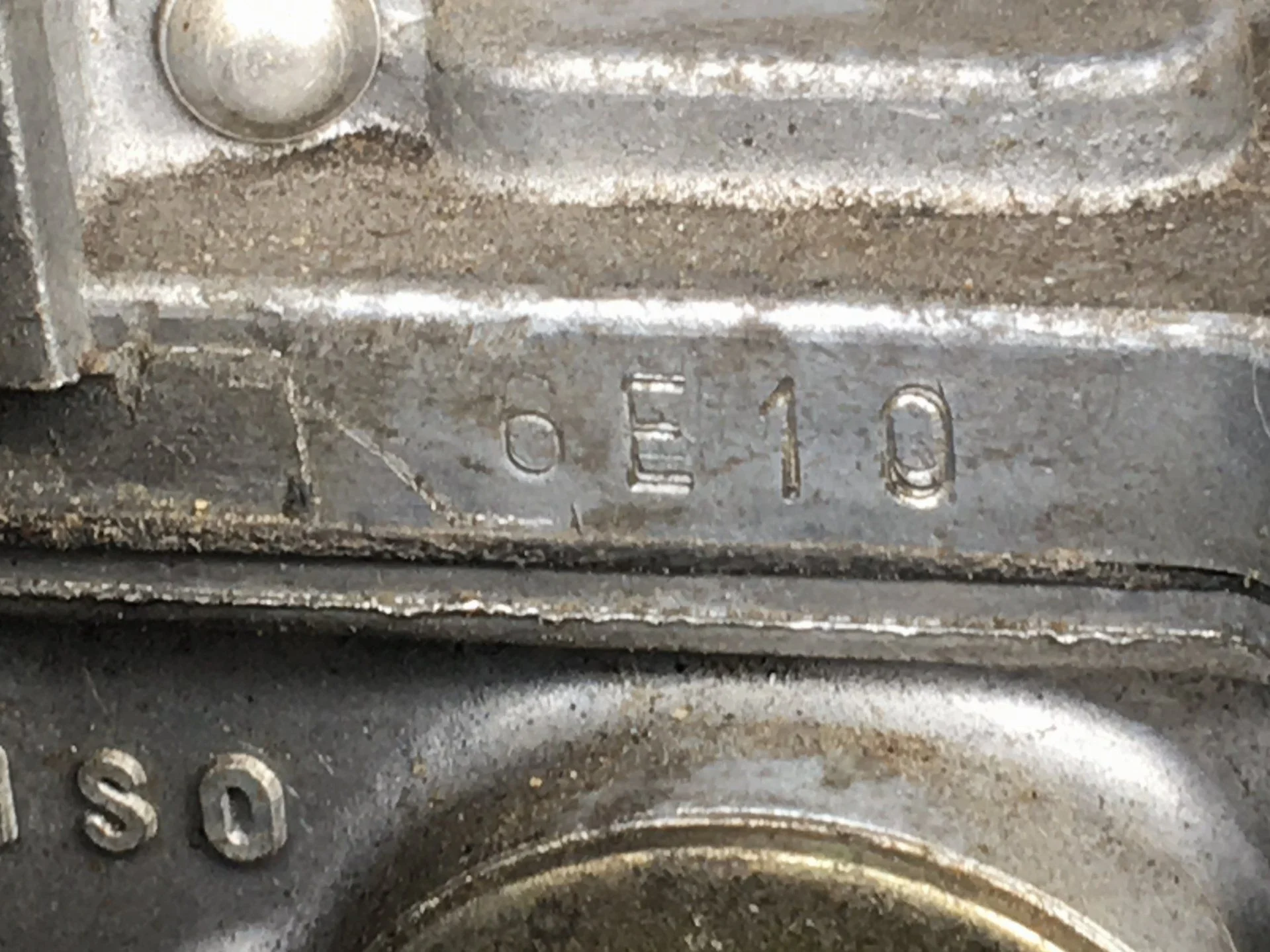

My numbers at 6 E 10

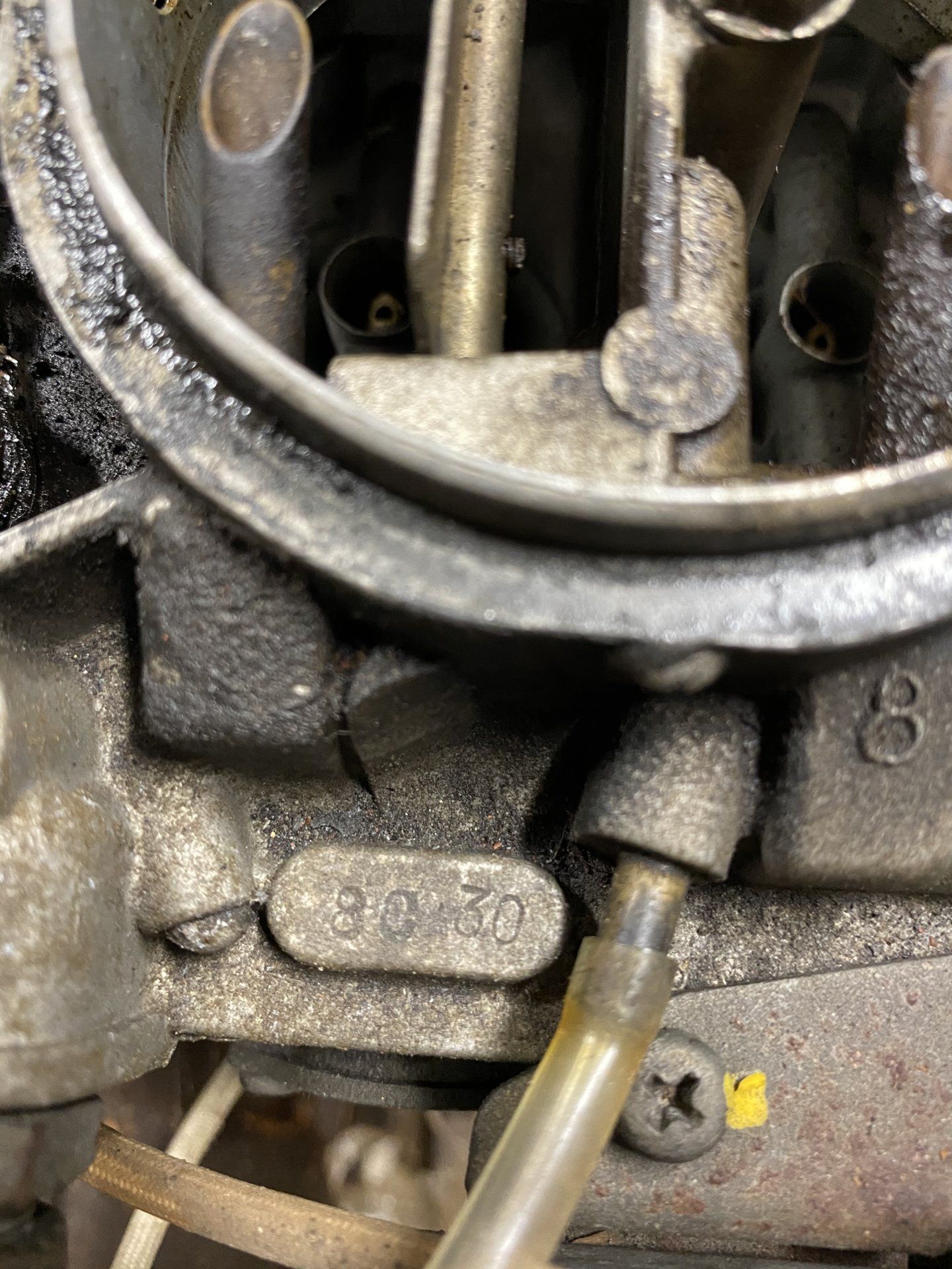

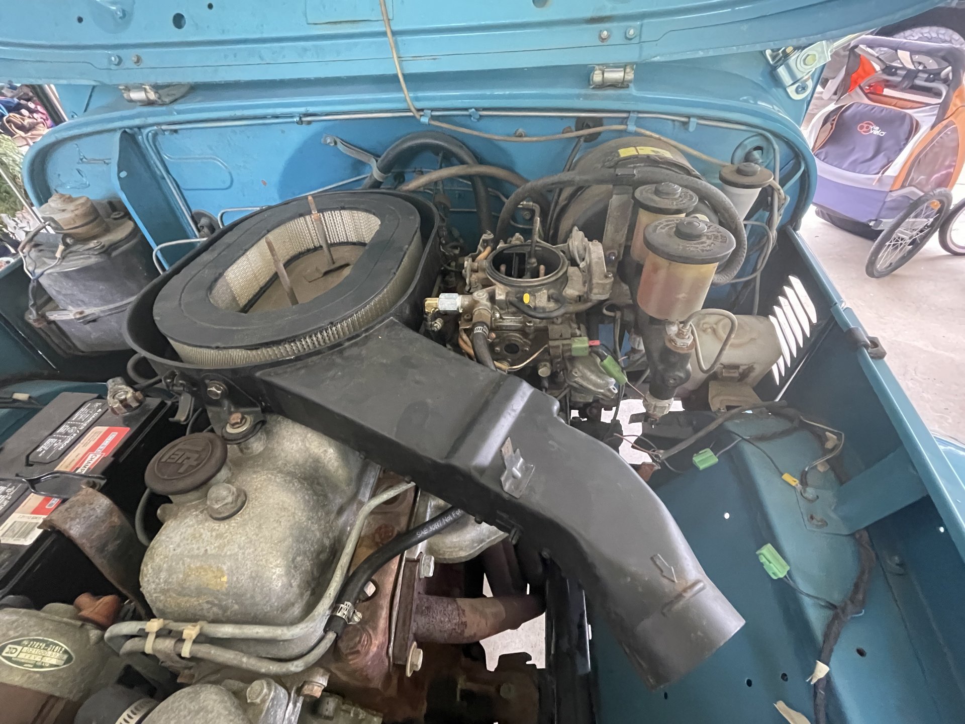

That date breakdown doesn’t seem to make sense on stamped date on my carburetor.

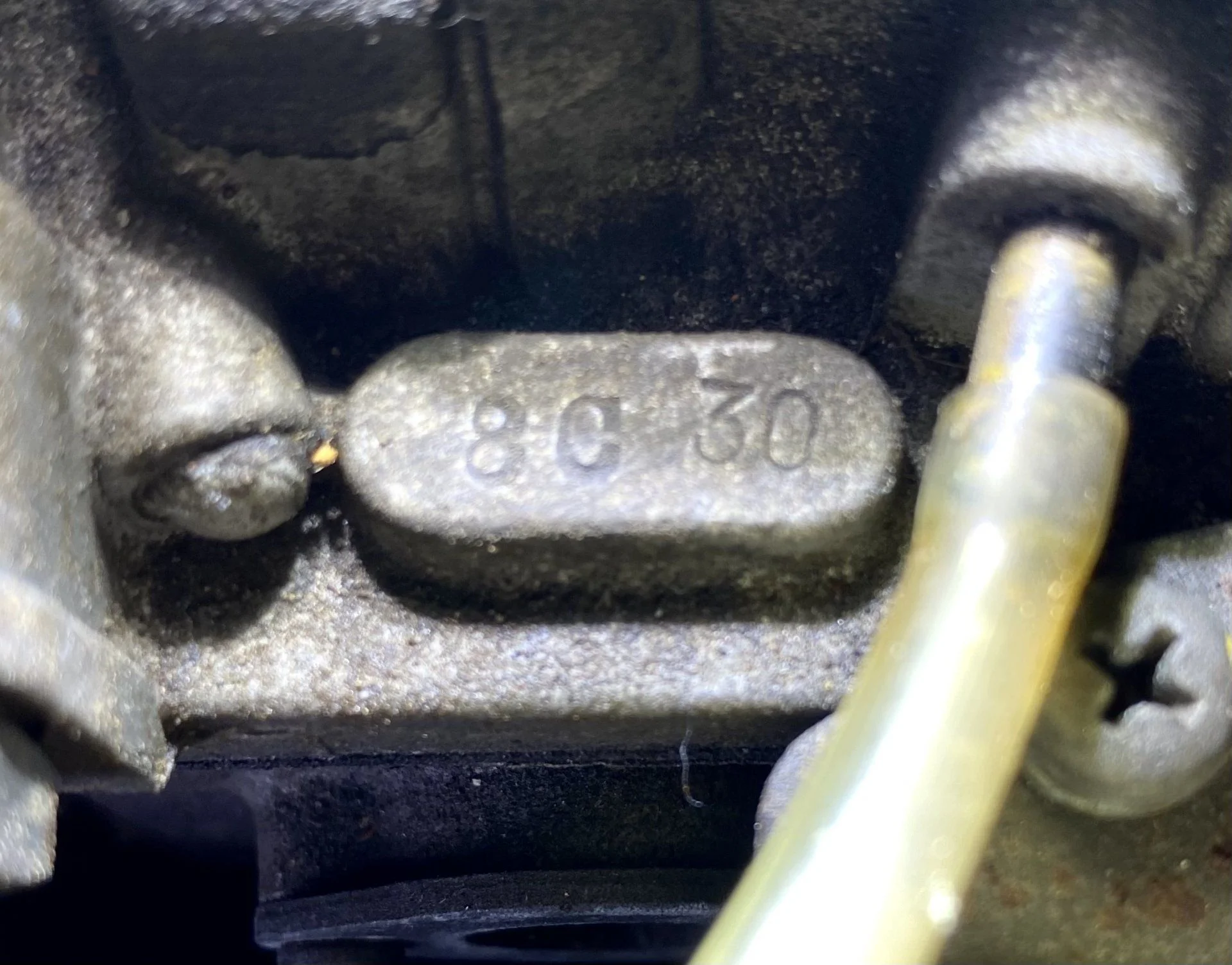

The 8 makes sense, I was told my 2f replacement came from a 1978 Fj40. But what does the 0 or O represent? Here is the rest of it.
That looks like a 8C30.
So, 1978, March, 30th.
Always zeros. No “Ohs” or “eyes”. To easy to mistake with zero and one.
You are right, thanks for that. I took a closer photo and it does look like a “C”.

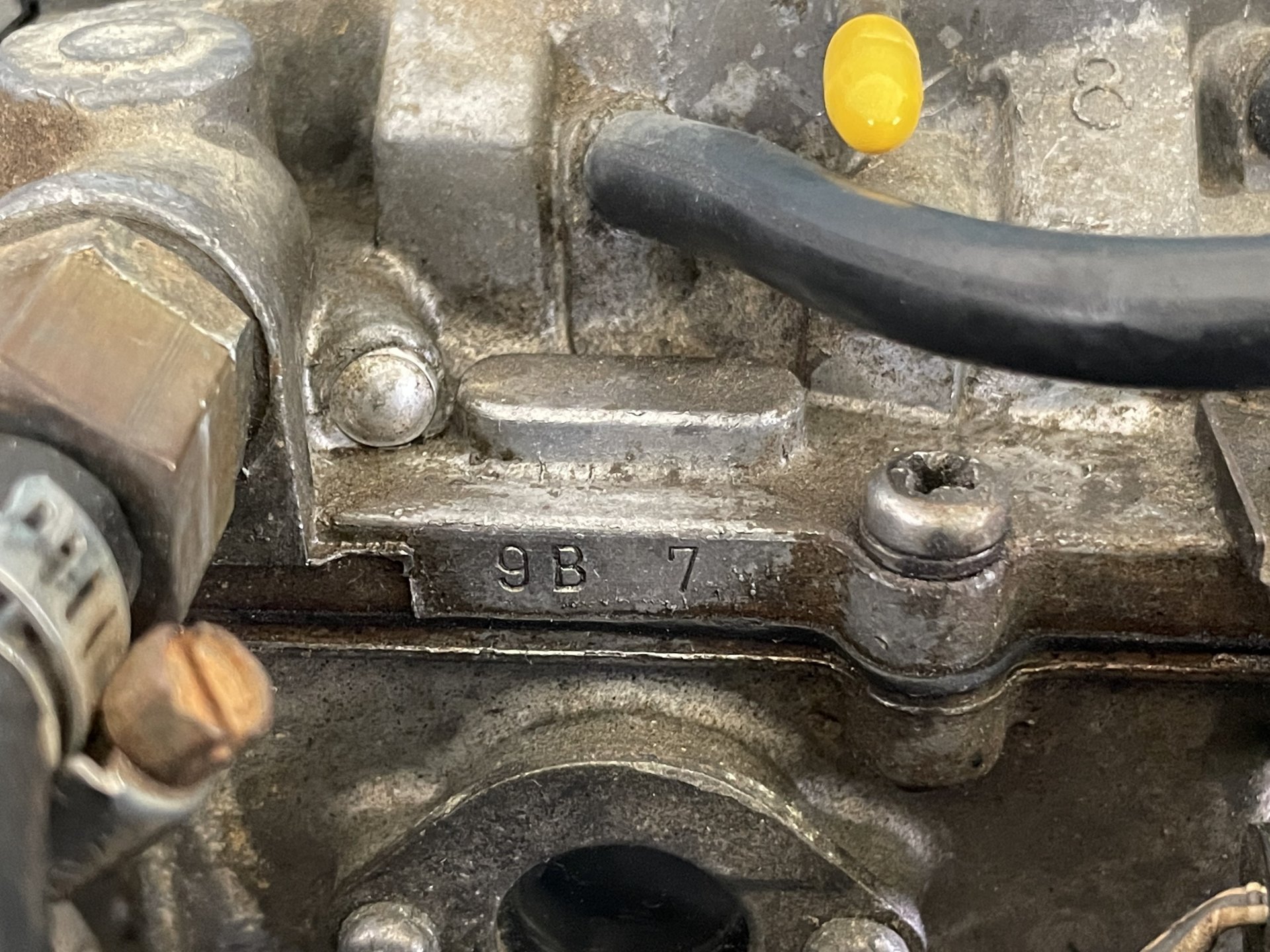

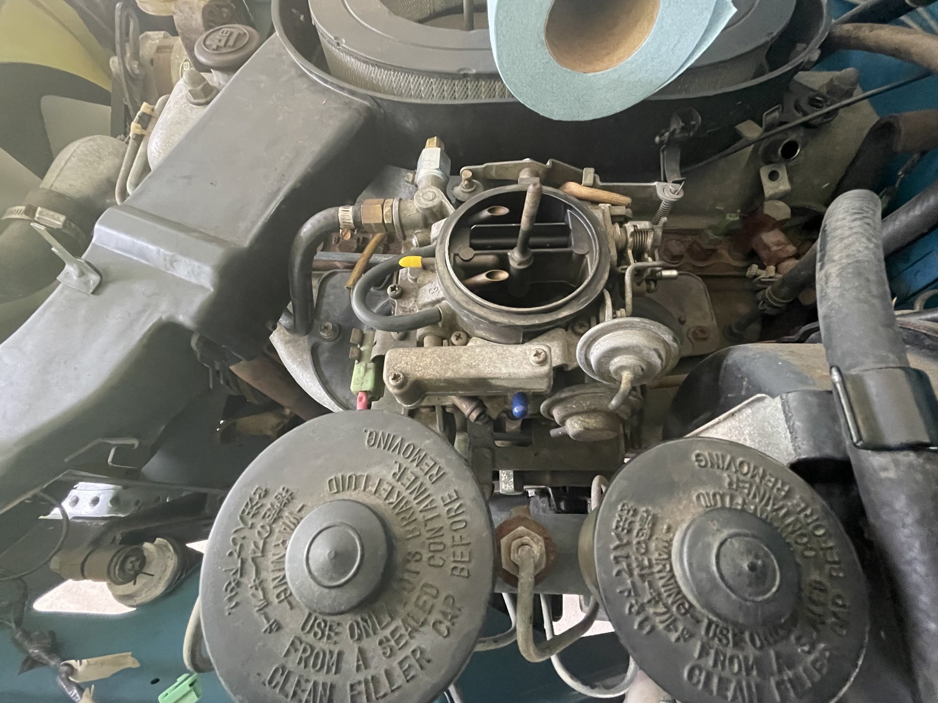

My 40 is a may 77 that was desmogged by the PO. I think im reading the date code correctly January 9 77?
There are vacuum lines that are not plugged/capped. After reading through this thread I think I should cap them.
Any disagree?
Thanks
@highrisk
IH8vacuum lines...
I would search through the desmog threads and start a specific thread about your situation.
Lol. I searched for everything but desmogged….. that’s a great idea.
Before you get too excited, do some research on WHAT you are desmogging.
Glorified 1bbl.
Glorified 1bbl.
Fair enough, any advice on which vac lines to put back together? I am experiencing stutter, bucking, and stall at higher RPMs, when pulling hills, and so on.
