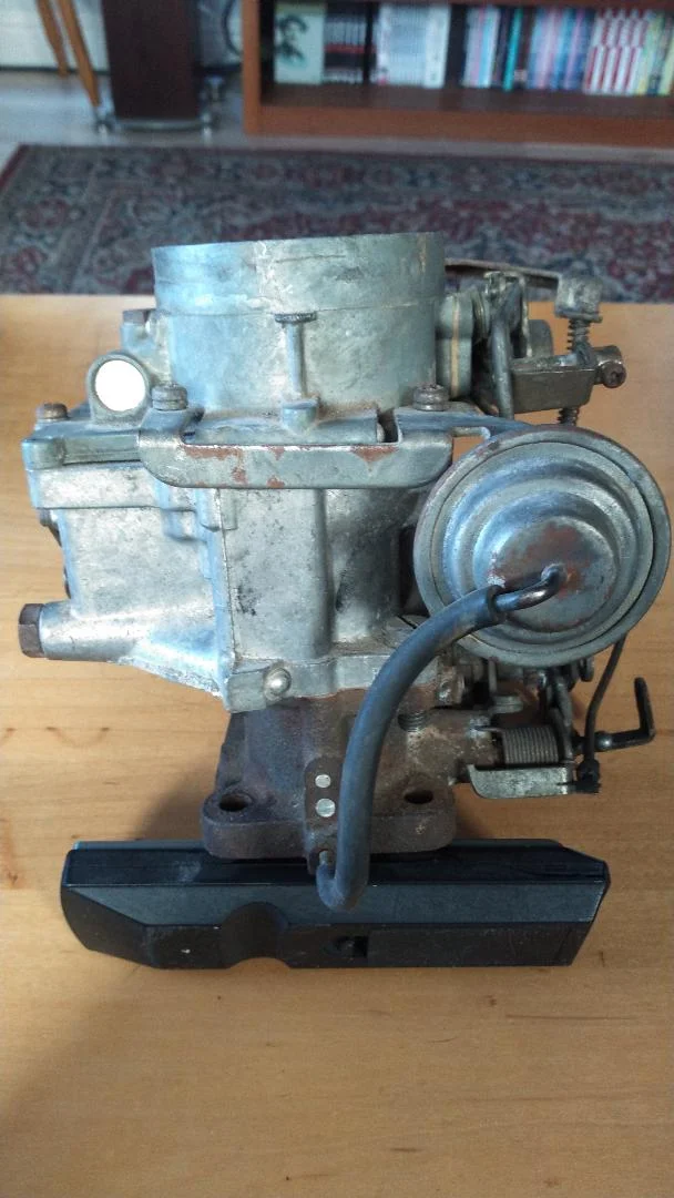

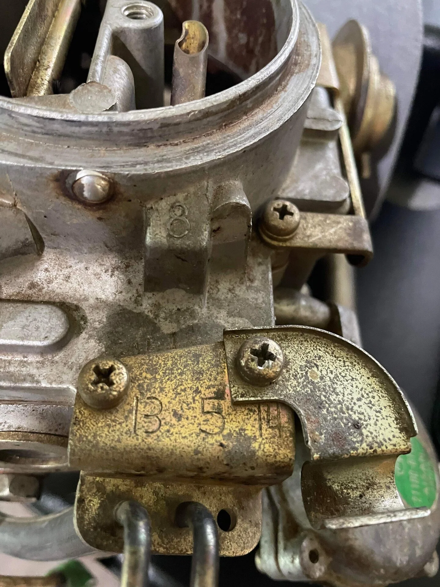

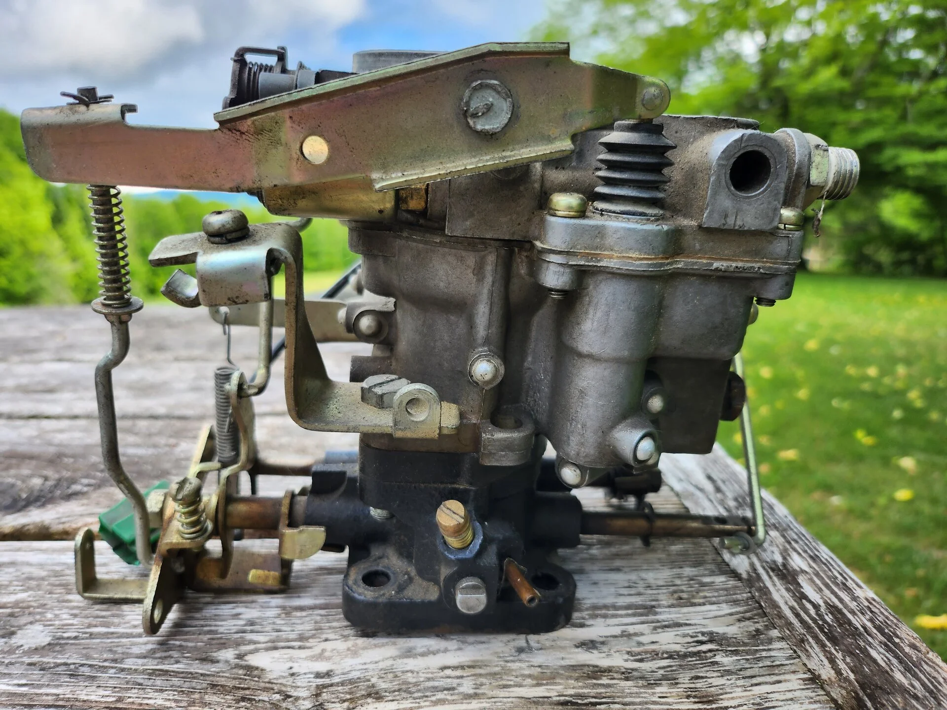

Since this group has an unbelievable ability to identify parts, I come to ask for the communal wisdom. I have learned from this thread how to decipher the date code and that my carb was built 12th February 1985. I know the rig is from Venezuela and has no emissions on it. Given that and these pictures, can anyone give me a part number or a link for the carb I should be buying to replace this? Thank you!

there are a couple of figures on this board that could possibly rebuild it regardless. how does the linkage seem? too bad its off the engine, you could have performed a "vacuum test" with some carb cleaner
just a guess ............................. 21100-61012

It is an FJ45 Troopy. 1985. I just sent you a dm with the VIN. Thank you for trying!
Can I get some help with this one.

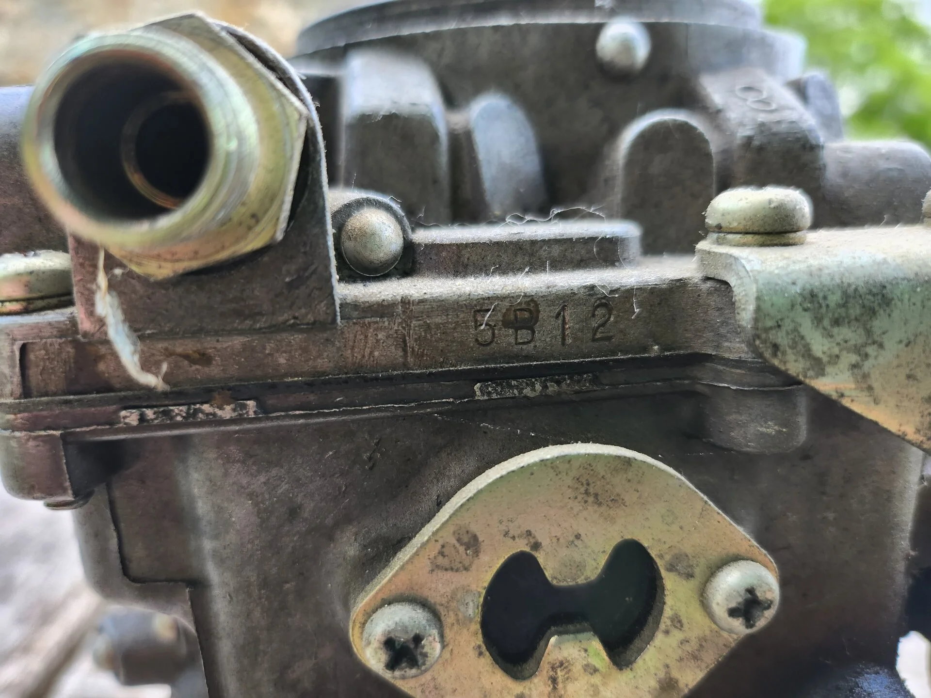

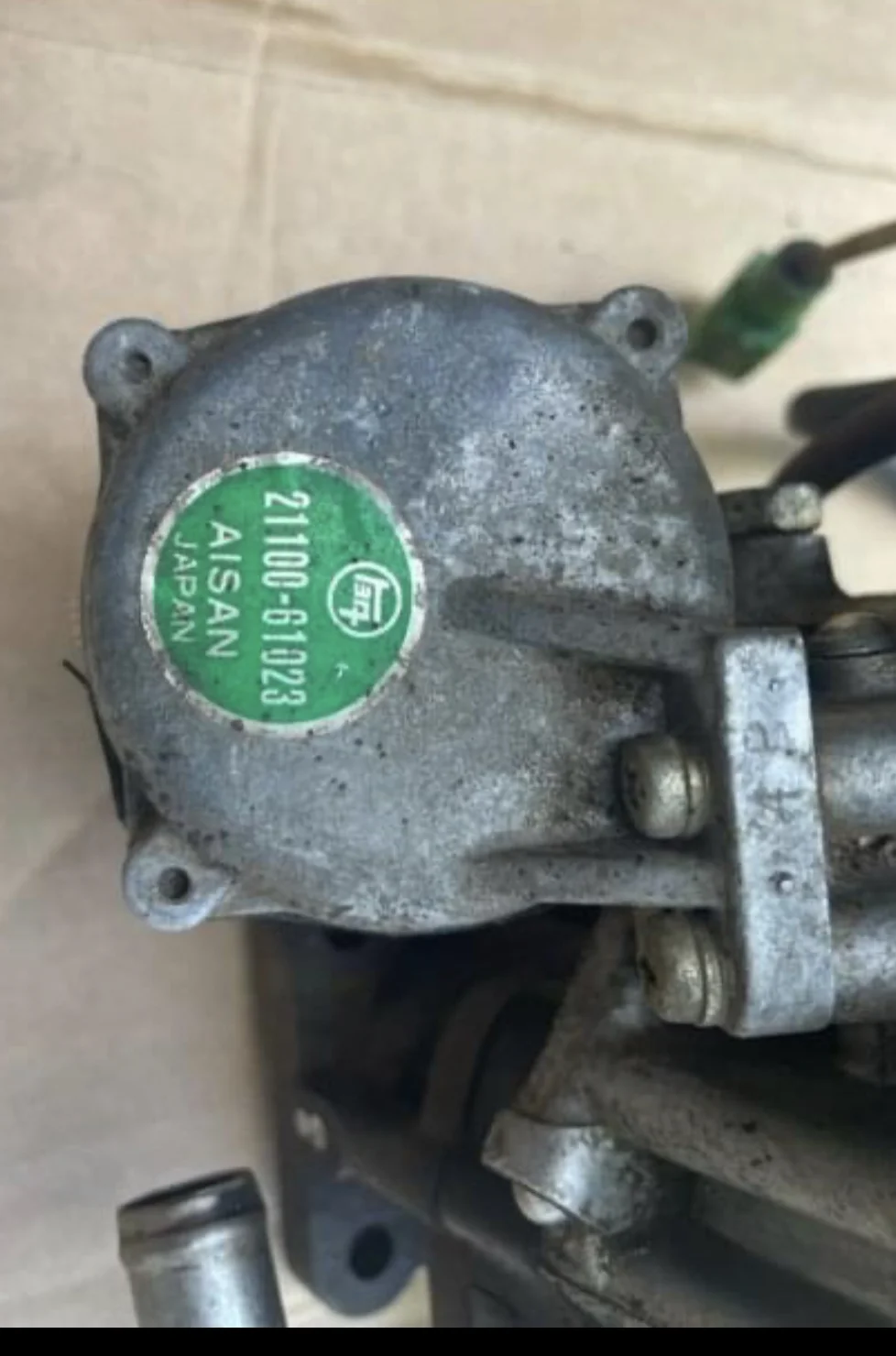

For this photo, slide to the left and photograph the 3-4 digit code. See above photos. The code on the cast steel vac bracket doesn't apply to the carb.
That said, the carb is a rest of world (ROW) 75-80 carb.

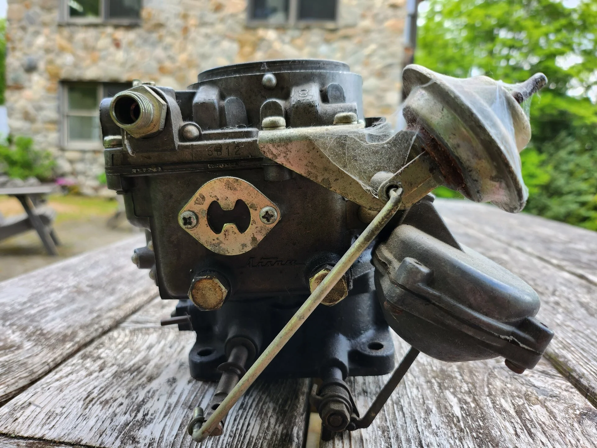

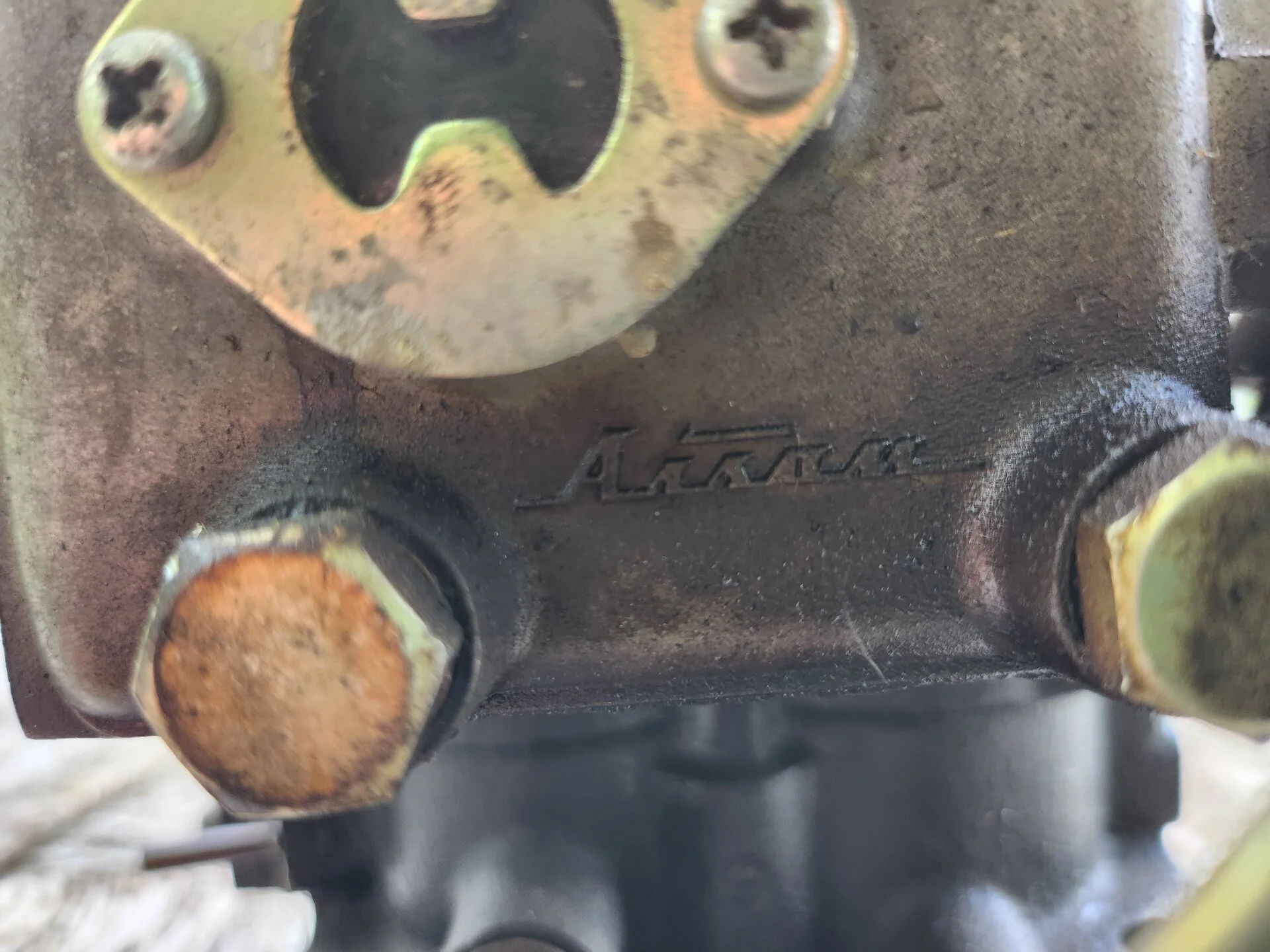

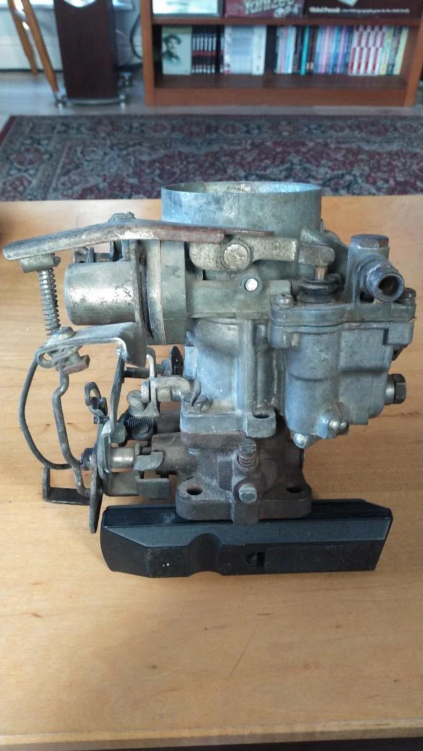

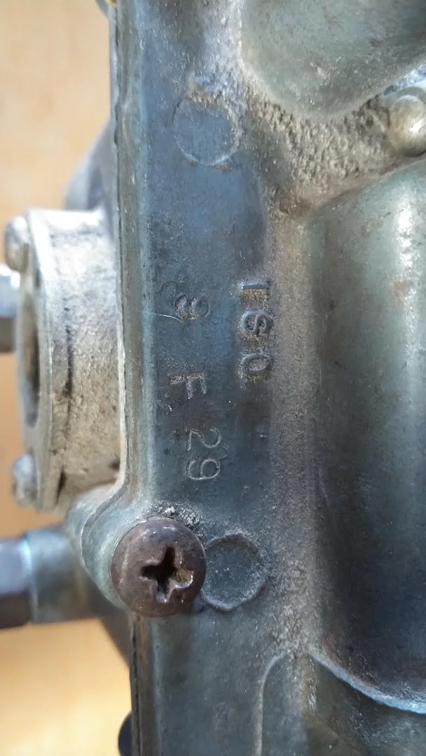

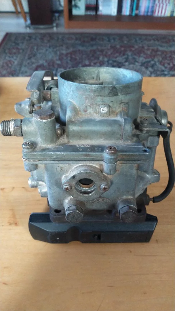

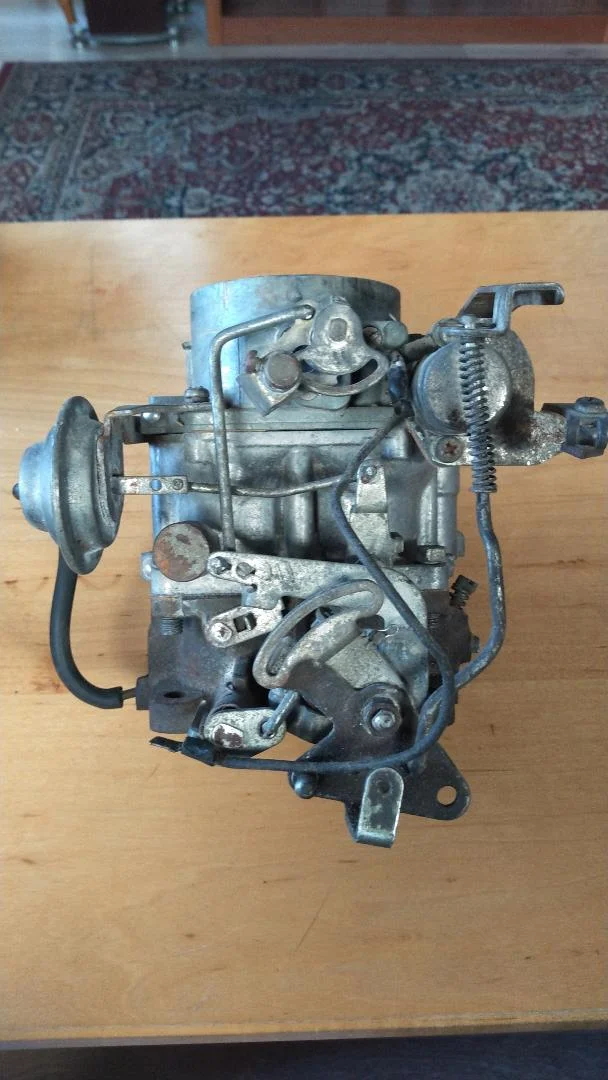

I need some help with this franken-carb.
I purchased what I think to be mix of a 69' and 73'. The goal is to rebuild it and replace the unit currently on my 72' FJ40; which is a late 75 carb. I need help identifying the rebuilt kit for it since the air horn is a 69' and the main body (not sure if that's the correct name) is a 73' (correct me if I'm wrong on that).
There are multiple rebuild kit options for a 73' carb, and I don't know what the difference is, or how to identify it. I used the SOR Carb Identifier to get me this far but I feel like I'm getting into the minutia. Advise?
