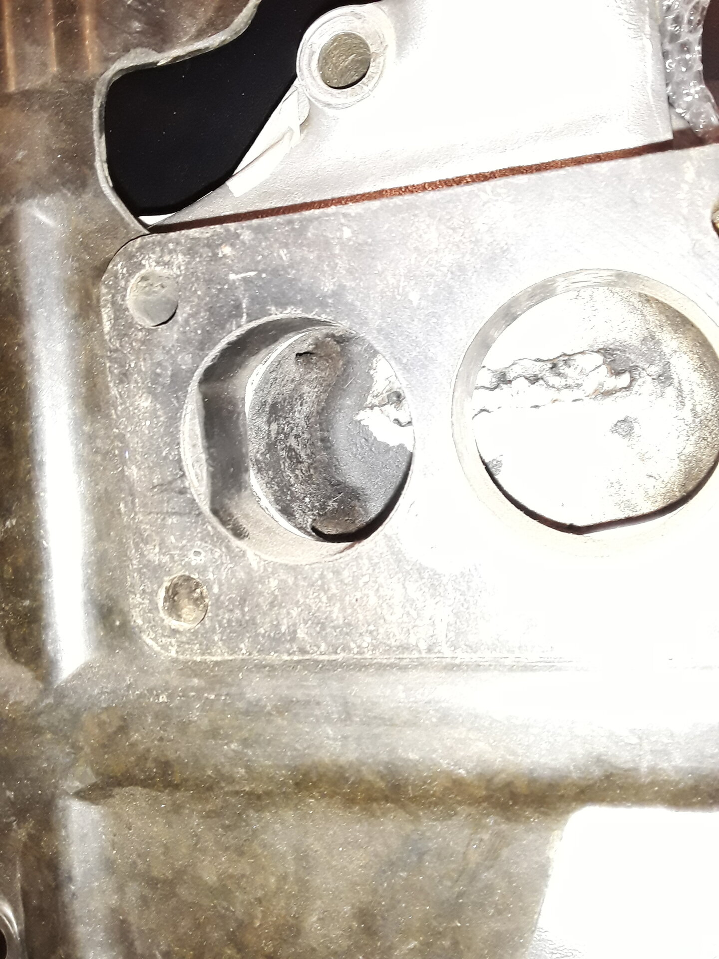

Look at the space that 95% of the work must function in. The factory has the primary so close to the manifold edge that they even restricted the flow thru this with a non-circular bulb on the insulator plate. It is a tight curve that the fuel charge must travel thru from the primary barrel. Why not place this function at the center of the intake manifold?
yes, welded, and cracked on both sides.
Plenty of clearance on the factory insulator and the intake manifold.
