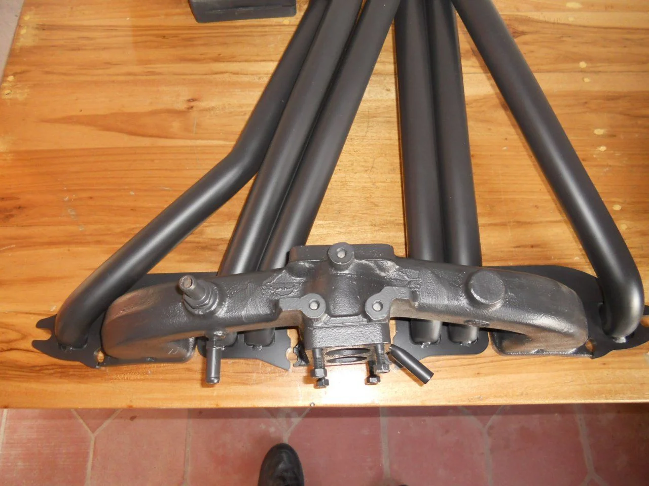

Thanks Jim. I have this intake manifold I bought on Ebay and had sandblasted and ceramic coated. Clean as a whistle inside. I will presume I would be blocking off a number of ports on the manifold and the tube on the insulator is for PCV? Haven't heard back from Sealed Power on the availability of the pistons they list. They also list most of the parts for a rebuild, with the curious exception of valve springs.

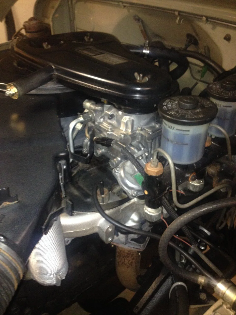

I have the exact same 21100-61090 High Altitude Spec carb on my 77' FJ40. It is desmoged, and I am uncertain as to what ports can be capped and which need to hooked up. Being that the rig is located in GA, can the HAC port near the airhorn be capped, as shown in the photo below?
Would you recommend a specific port in which to hook the distributor vacuum line too? Maybe port #5, #13, or something else?
If a desmogged port is not hooked up, should it be capped? i.e.: both ports on the blue BVSV, the unused Port #5 or #13, the unused port on the exhaust manifold (fuel filter?), and the HAC port?
Any help would be greatly appreciated.

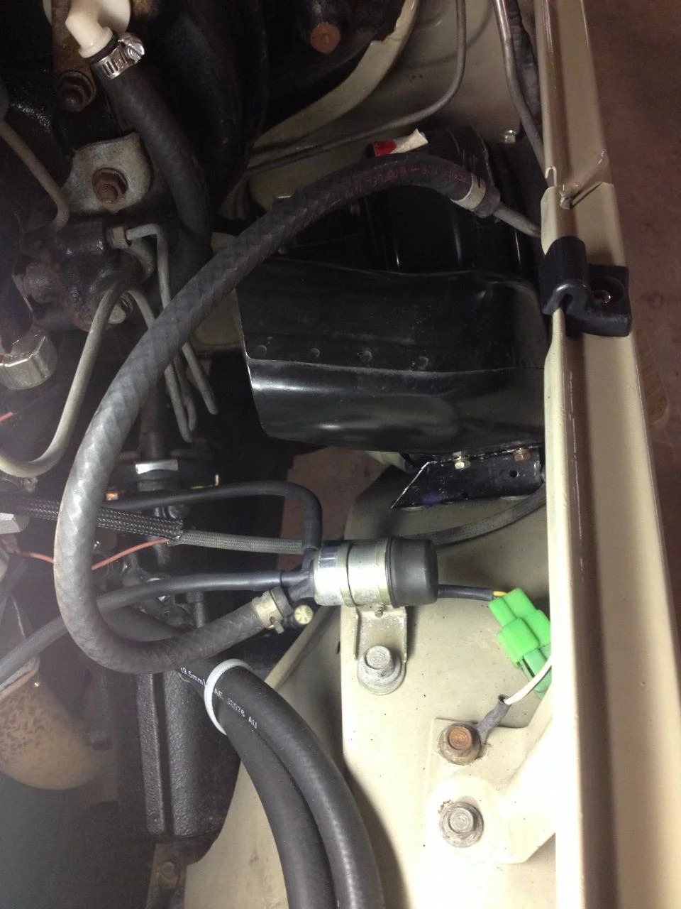

That wire connection is a switched 12V, like lenny mentions above, and is connected to a wire off the harness on the drivers side fender. Mine is in the same loom as the red brake sensor wire, and I added the extra covering. That wire will connect to the fuel solenoid that is on your Aisan carb, and controls the flow of fuel.
Is the 6J22 Aisan carb original to your rig, or is it one you just picked up? Do you have all the parts to re-smog your rig?
You can see the old wire loom that goes behind my carb fan.
Thanks guys! Will have to get the meter out and find the switched power wire.
GA, yes, I pieced it all together. After much searching, a lot of luck, and help from fellow mudders, I have everything installed and almost ready for smog. Not sure if the carb is original or not, but the previous owner did pass smog with this same carb in the early 2000's before he decided to junk a lot of the smog equipment.
