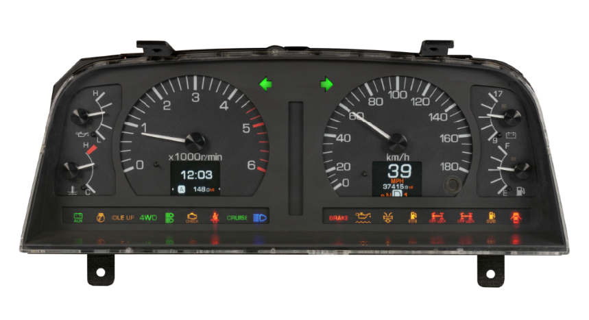

Looks like they are mailing it out this wee.
Here is what it looks like.
I'll post install pics once I get around installing it.
The pointers cannot be made longer. DD says the weight would be an issue.
I would have preferred them longer but I think it still looks good.

Cool. Are you using the "4WD" light to replace the center diff lock light?

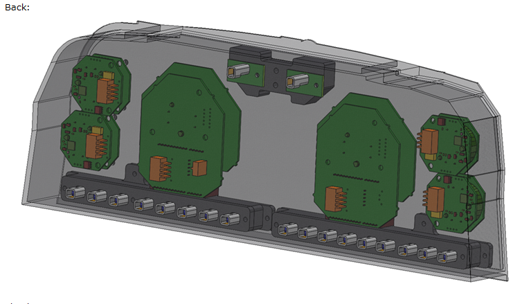

This is sweet, I've done some work down this rabbit hole myself, can be seen at the link below.
Custom Guage Cluster

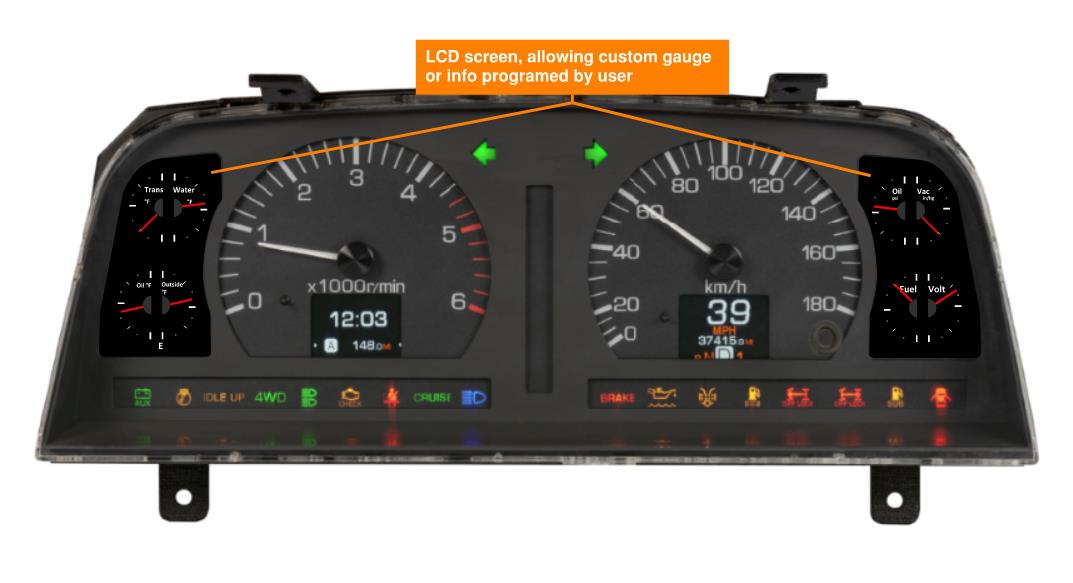

It'd be nice to have the two small color OLED, TFT or LCD displays on either side of the cluster that the user could set to display digital gauges of whatever data set they have inputs for. Like this
It would be really easy to program in a warning threshold for each item so the screen in that area flashes or changes color. The hardest part would be getting a screen to fit these slots
Why not just go with a full digital dash? Last I checked it was about 2k dollars to do so.
It would look closer to stock. digital gauges don't age well.
I couldn't agree more, seeing numbers fly around just means my brain has to go through another step to think about whether or not its in range, high or low etc. It's harder to decipher values instantly from a quick glance at a digital readout that doesn't mimic the style of analog gauges like the stuff in porches and audi's now.
Where on the other hand I just do a quick left to right scan of my gauges and if all of my needles are generally where I left them then I know everything is fine.
It'd be nice to have the two small color LCD displays on either side of the cluster that the user could set to display digital gauges of whatever data set they have inputs for. Like this
Most products like this use off the shelf TFT screens developed for other products.
Those little screens are probably 1.3" smart watch displays.
Custom screens aren't really a thing unless the product will be produced in the millions.

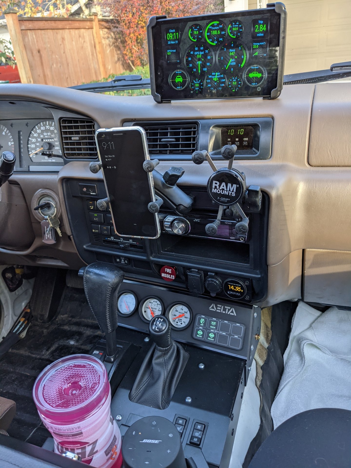

Sure I'm aware. I've already looked at adding an OLED or TFT screen to my setup to replace a set of gauges and provide more data. It was based on an Arduino system and would've utilized a standard rectangular OLED display that I could get off the shelf. Ultimately I didn't pursue it because other projects jumped up, but it'd be a cool touch of modernization to the rig.
This was my concept:
Nothing is impossible for those of us who have the time and sometimes money to see what we can do.

Looks good. But it looks like the TFT screens are cut off at the bottom? or just a rendering there?
I like where your head is at. But I don't think Dakota is going to do it just yet.

Did you get the unit in hand?
looks a lot better than my ghetto solution.
Have they said when they plan to list these on their website? I'm thinking more and more of going this direction when I start my FTE swap.
Don't think so. As mentioned we do a lot of business with them. This is from their "custom" department. But likely you can order one too. You just have to send in your/ a donor cluster, pay and wait.
....son of a ....I just threw away an 80-series gauge cluster like a week ago.:bang:
