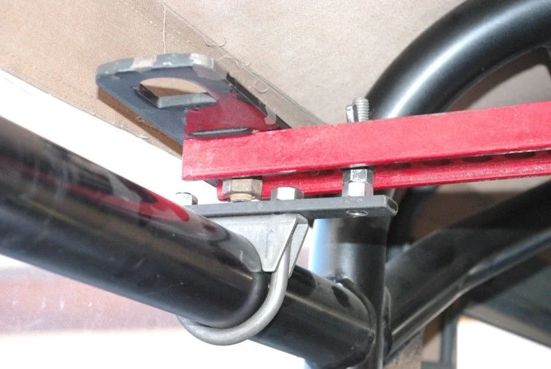

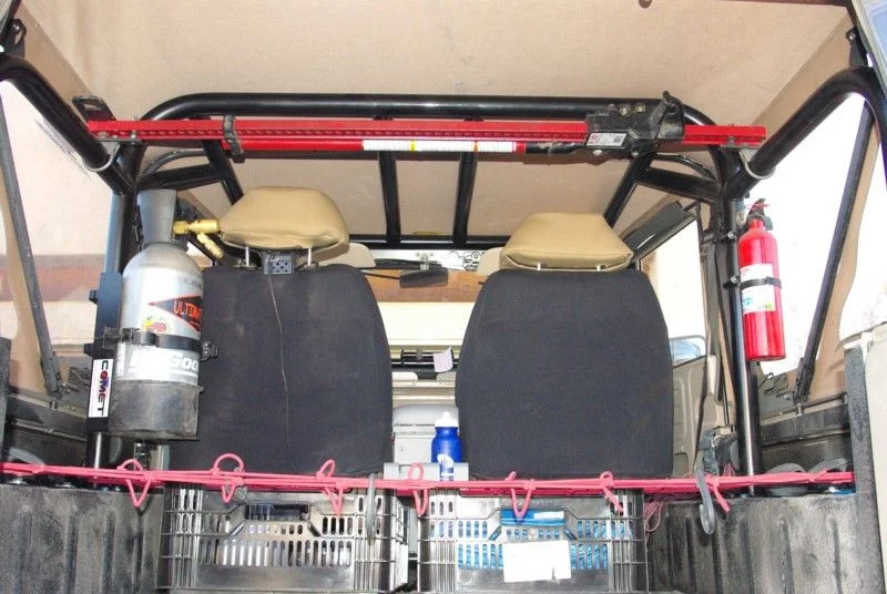

Today I played with a possible solution to mounting the jack. Not on the rear bumper, but to the roll cage. I used muffler clamps, and I will probably make one small change.
That's really slick Jon.
Mmmm. Up high. Raises the CG.
Enough to make a difference?
The straw that broke the camel's back...
Ya just never know until afterwards.
I'm sure that jack weighs less than a hard top. Also, because of the design, I can locate it it anyplace along the roll cage.
