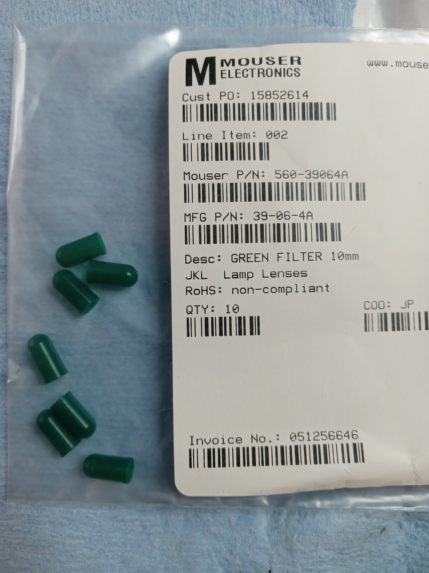

No need to spend the coin on OEM bulbs. The common replacement is DNW1-DW33/GRA
Available from any electronics supplier. Take the green condom off the old bulb and place it on the new one.

Green condoms, or "lenses".

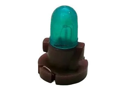

The big green condom bulbs 83119-36060 are for the cluster as a whole. Then you have indicator bulbs that are smaller such as ABS, lockers etc. the shift indicator bulbs are 84999-50180 and there is also a small green condom one. This small green goes in the OD slot.
Here’s a pic of the 4 different bulbs in the dash. The two on the right end are shift indicator bulbs.
