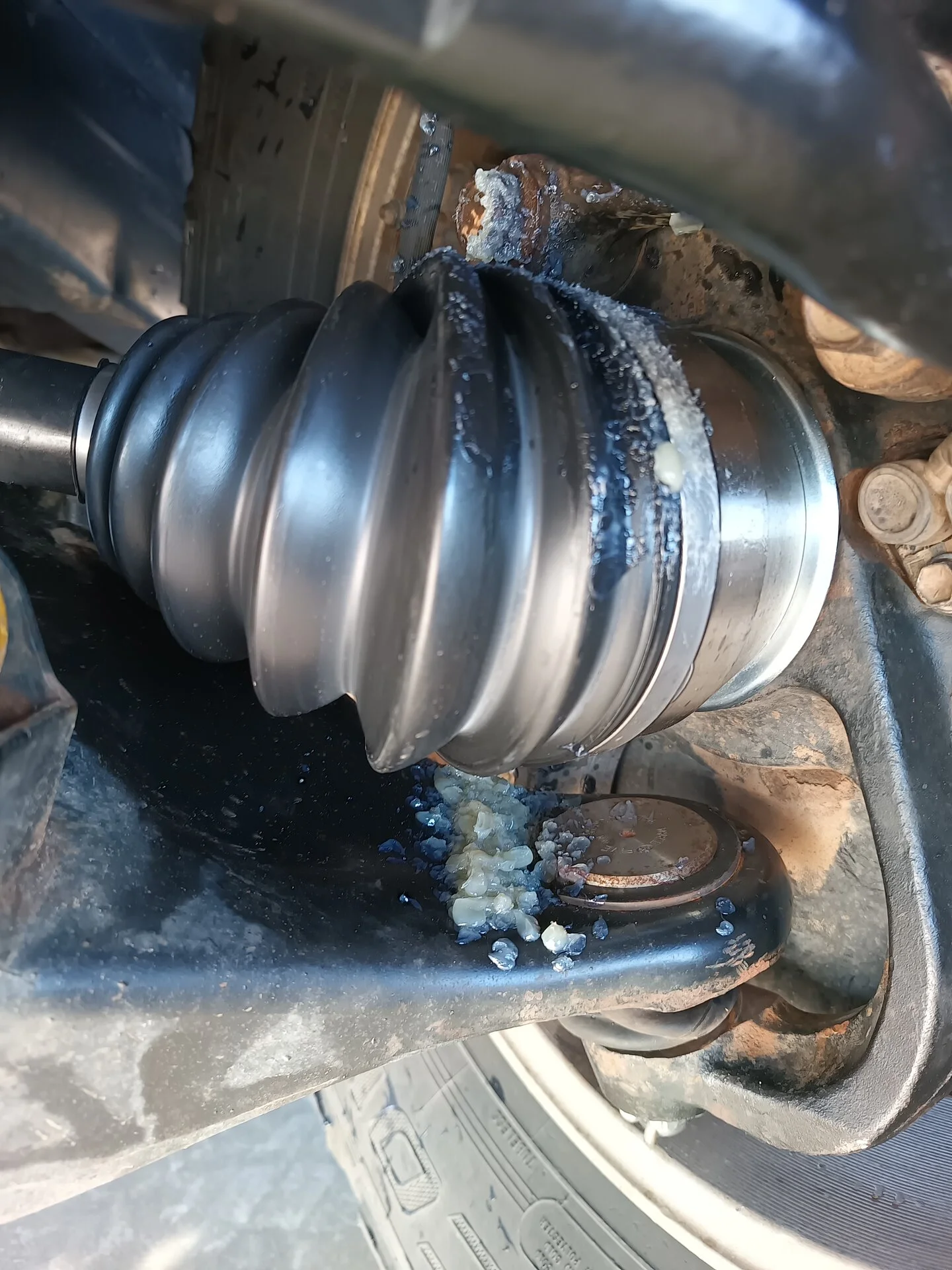

I'm sure this has been discussed before but right now I am extremely frustrated on this Christmas Day after installing my third CV axle in 3 months last night only to find out today when I arrived at my family's house for festivities I have checked out the install from last night and discovered the CV outer CV boot on the axle I literally installed last night has thrown out most all of its Grease.....
The first one I got from AutoZone was just a regular standard axle and the inner CV boot started leaking about 2 months after I got it I replaced it under their warranty program back in October the first weekend of December I went on a trip to Amarillo to do some light off-roading and on the way home discovered the inner CV boot had ripped again on the 2-month-old axle .... So I decided to spend some money and upgrade to the HD severe weather axle since it was only $40 more and literally less than 24 hours the outer CV boot on that one has emptied its guts.

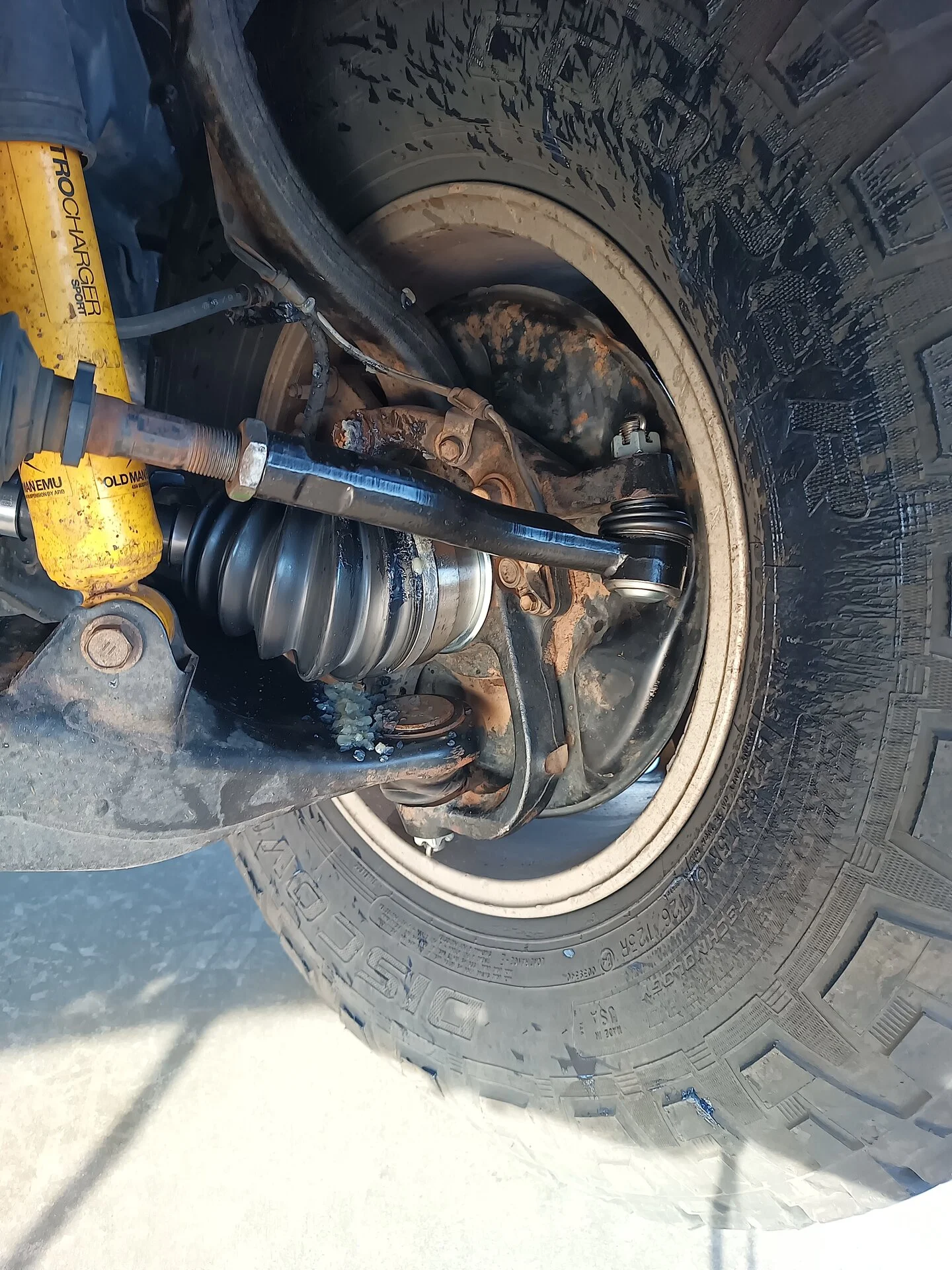

I have had this one on now for 20k miles and a lot off pretty hard trails and never had an issue. I would check the lift in the front of your car and make sure it's not too high up. Also do you have a diff drop?? Maybe a loose differential bushing that is causing play?

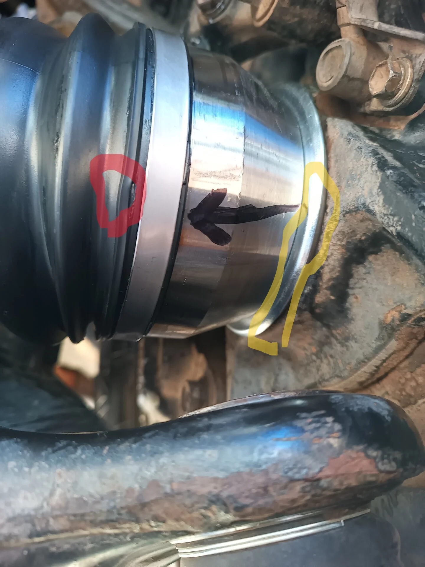

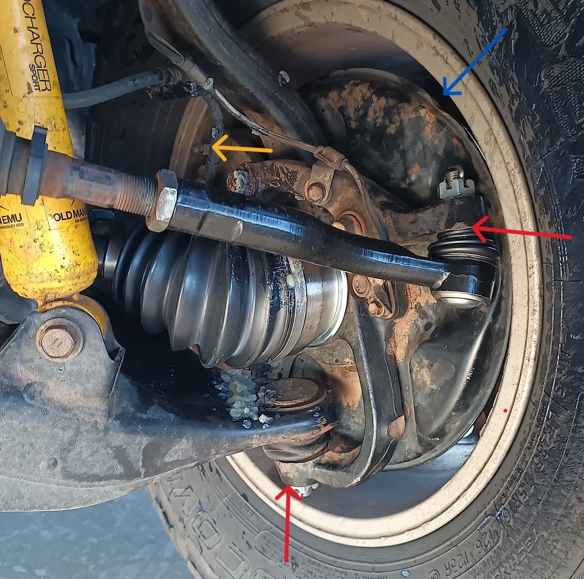

OEM considered best. But OEM or aftermarket. Care must be taken during shipping, storing and installing. Road hazard hits do happen, but not all that often.
If the rubber boot, bumps hard surfaces where metal of CV under rubber boot. They often get a hole in rubber.
A common install hit, is on LCA
This looks like a hole, classic to a hit. It also "looks" (may just be shadows), that metal rim of dust shield took a hit.
I do see other common issues.
Missing brake caliper bleeder cap. That's asking for frozen bleeds and damaged caliper. Especial if missing from rear brake calipers bleeders.
Brake rotor dust shield bent. Common from hanging wheel on it, during R&R of tire. Then poorly bending back to stop rub on rotor.
BFH marks on TRE bracket and steering knuckle at LBJ. Associated with removal of TRE and LBJ, using BFH. So often, results in damaged TRE & LBJ.
Caution, gorilla out work
A gorilla at work still gets the job done just as effective. Minor paint chips on the powder coating of those cast iron parts has no effect on drivability or service life. You make a fair point with the brake bleed but I can't fathom a dust cap missing would cause a caliper failure. Potentially it could get clogged with mud or road grime but two or three seconds with a metal pick can it alleviate that issue. I wouldn't say the bent best slash heat shield is a problem in any way. I have removed them from many many vehicles without any negative consequence.
You have to keep things in perspective if this was a brand new 300 series Land Cruiser or Lexus LX 600 of course this would not be acceptable but a 205,000 mi 1999 LC ... I would say this is actually pretty nice condition despite the cosmetic flaws
Interesting prospective. Gives me a prospective, on your "extremely frustrated"

I could listed 100's of instance of, "gorilla work". That has compromised reliability, safety and resulting in parts failure and in additional repair expenses. Which, I for years, did list a lot of in mud for anyone that cared to read. These days I mostly just expect and repair back to factory.
BTW: Bleeders rust inside cavity of caliper seat area. This rust, works into seat of the caliper, resulting in pits. Old or new bleeders no longer seat, if any pit along seat line/point. We then get a pressure/fluid weep. New caliper $250 plus labor or $1 bleeder cap. Prospective!
