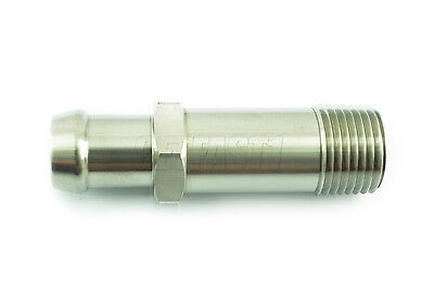

Well, I ordered one of these 1/2" NPT SS barbs to see how it works. Could be BSPT, but I held the Union pictured above next to a known 1/2" NPT and it looked identical, but we'll see -- As for the hose, I'll prolly just use straight hose if I can't find a comparable molded for the NLA OE hose.
It's hard to tell but anything on our trucks or out of Japan will be BSPT since that is the standard in Japan.
Used one of these as a block off. Seems to fit perfectly, will report if there is a problem once I wrap up the project and refill the system. (This is part of a radiator & all coolant lines replacement project... so the rear heater delete is, you know: while I'm in there...

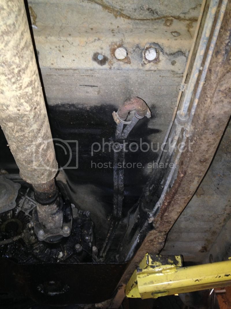

I’ve replaced a lot of the molded hoses on my 60 with regular 5/8” heater hose from a FLAPS. Never really had an issue. I need to replace all the hoses again as I have a good radiator cap and I found some leaks. Definitely have replaced that hose section from the driver side of the cylinder head to the heater valve with it. Believe that’s the part you speak of.
Found a pic of my motor and added an arrow with my iPhone. This one?
