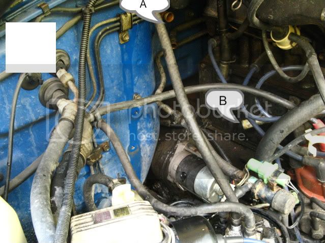

I removed the tee on the firewall, ran a straight hose past it and used a bspt pipe plug on the drivers side port on the motor.
As clean as I could make it. All found via stuff searched on here.
