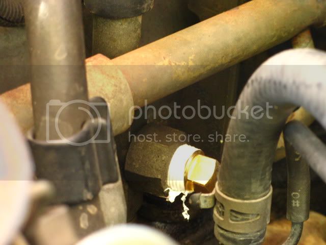

Today I attempted to remove a bypass of the rear heater line that runs behind the engine. The PO had installed a flush tee that was leaking and had to go.
Since most of the hoses needed to properly fix the system are NLA I just decided to remove the rear heater completely.
My question is if there is a specific hose I should get for the bypass. Is it standard 5/8" hose? Or something more specific. Any input appreciated.
The hose runs from point A to point B.

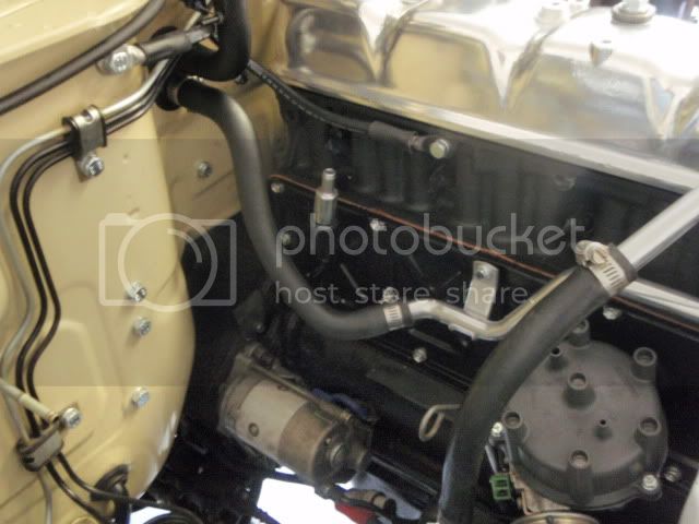

And hopefully will look like this when done (although not as clean).
I deleted my rear heat and got a hose from SOR that is molded to make those bends. As noted, regular hose would likely work but SOR has it.
Actually, it is a toyota hose but SOR bought all the stock when Toyota discontinued them. Mine still had factory decals.

Look at #15 below. Pretty sure that is it. I would definitely call and talk it through with them. They definitely have them and that is the hose Prowlerdriver installed on his 60 - the one in the pic in your original post. I think he got his from Toyota before they discontinued them.

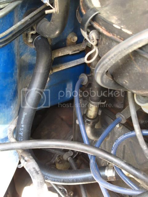

Well the fix was pretty easy. Just a 3/8" brass plug on the drivers side and a length of 5/8" hose for the bypass.

SOR has one that is molded to fit. It's the hose you can see in the picture on my previous post. Fits well. A straight hose won't work. I already tried that. Kinks.
It has some sort of number stamped on it. You can read them on the picture (or most of them). My cruiser isn't nearby at the moment.
