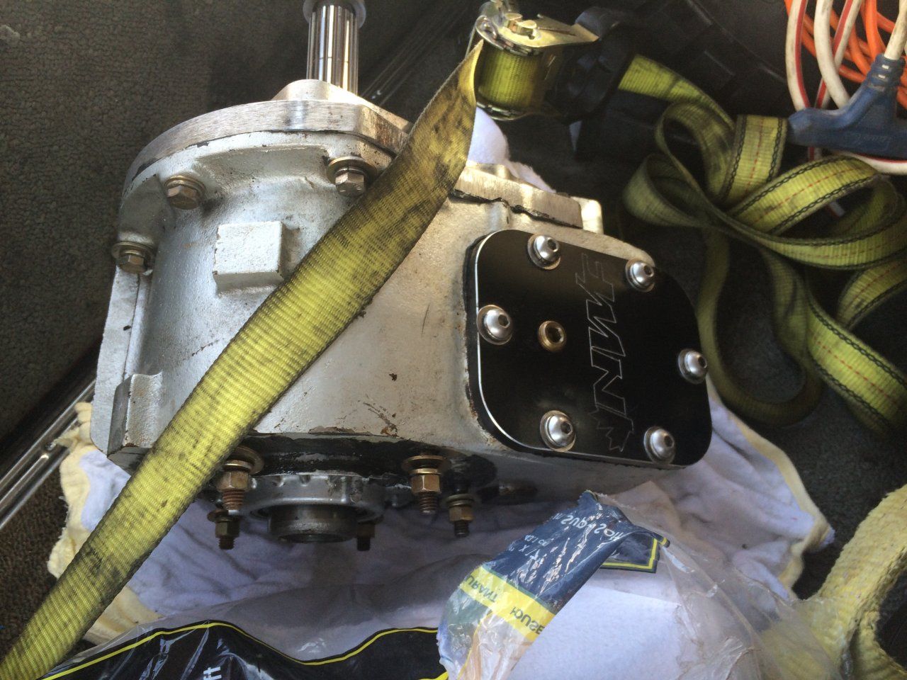

203 doubler with splitcase adapter out of @Lil'John 's FJ55 with showed up. Gaskets for the splitcase showed up from Georg @orangefj45 . Just need to buy an NV4500 mainshaft, a shifter, a few more small parts for the transfer case from Toyota, and metal for the crossmember. And a
twin-stick kit from Georg. And an FJ62 floor cover. And a 10.5" Chevy clutch disk along with conversion pilot bearing and input bearing retainer sleeve. $$$$$$
Goal is to begin disassembley April 1st. Bigger goal is to drive it to GSMTR with the new drivetrain. And keep my straight A's in school..... And job lol
Also picked up my NV4500, machine shop pulled the fifth gear off. Need to find out wether the GM 5th gear is compatible with the Dodge 23 spline mainshaft.
And I need to order parts to build the new exhaust....
And I still need to make my custom shoulder bots for bolting the Nv4500 to the AA adapter. 1/2" shoulder with 7/16" threads.
The holes in the NV4500 main case are 1/2". The bolts and holes in the AA adapter are 7/16", which is fine because the input bearing retainer indexes into the plate. However I'd still like a bit of extra "centering" force, so a 7/16" bolt with a 1/2" shoulder will work great. I have access to a lathe so it's no big deal.
The other idea was to drill out the holes in the main case to 9/16" and press a 1/8" wall sleeve in, making the holes 7/16".
The other idea was to drill out the holes in the main case to 9/16" and press a 1/16" wall sleeve in, making the holes 7/16".

As for you looking for a more concentric method of fastening, are you just missing dowel pin sleeves? I found mine at my local hardware store. I think I had to "machine" my sleeves down on the OD but they fit and did the job.

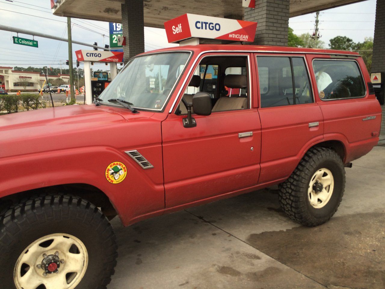

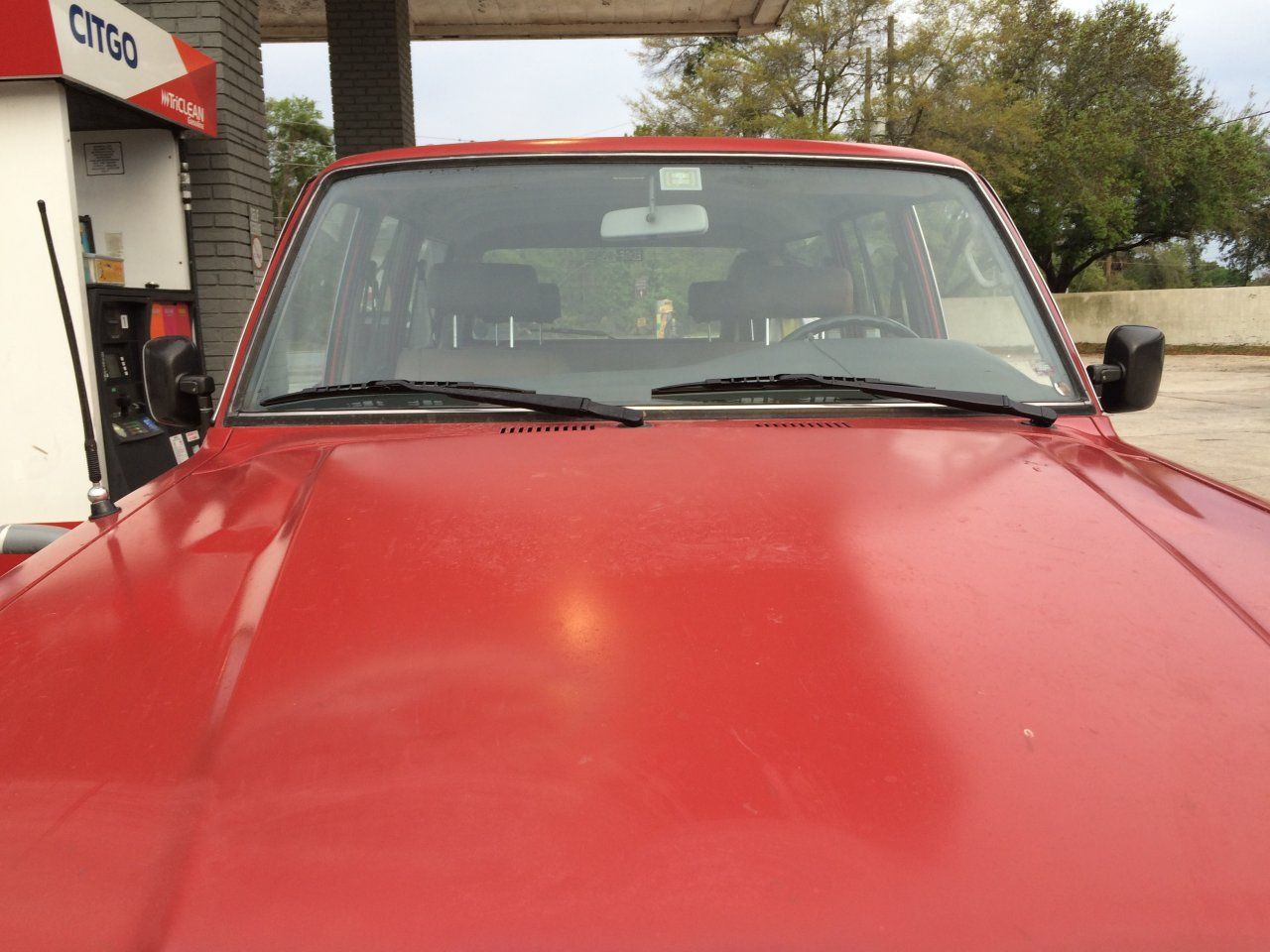

Apparently Euro mirrors are pretty expensive? I found these on my parts shelf, turns out they aren't regular FJ60 mirrors! :D:D:D
