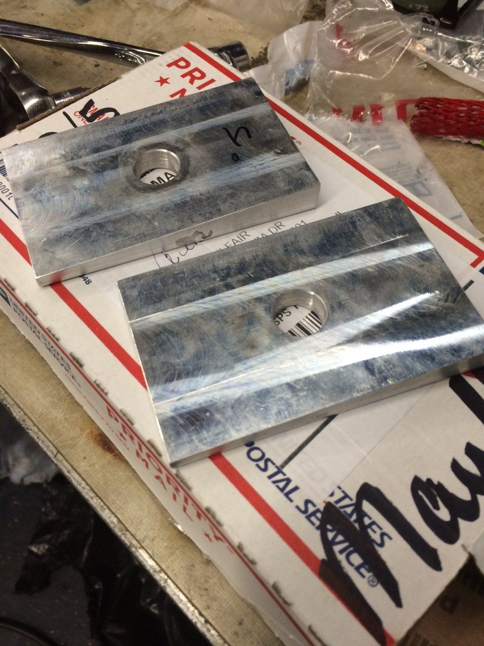

When aligning my spring perches I didn't account for spring and shackle flex, so my pinion was pointed 4 degrees down. I installed some Man-a-Fre shims that are intended for caster correction and the nasty vibration is mostly gone up to 75mph.. the rest I'll chalk up to 35" mud tires and the huge-ass driveshaft. I'm happy I can go back to the short FJ62 rear driveshaft with the NV4500/203 swap.
Make sure to clamp your springs before removing the center bolt!

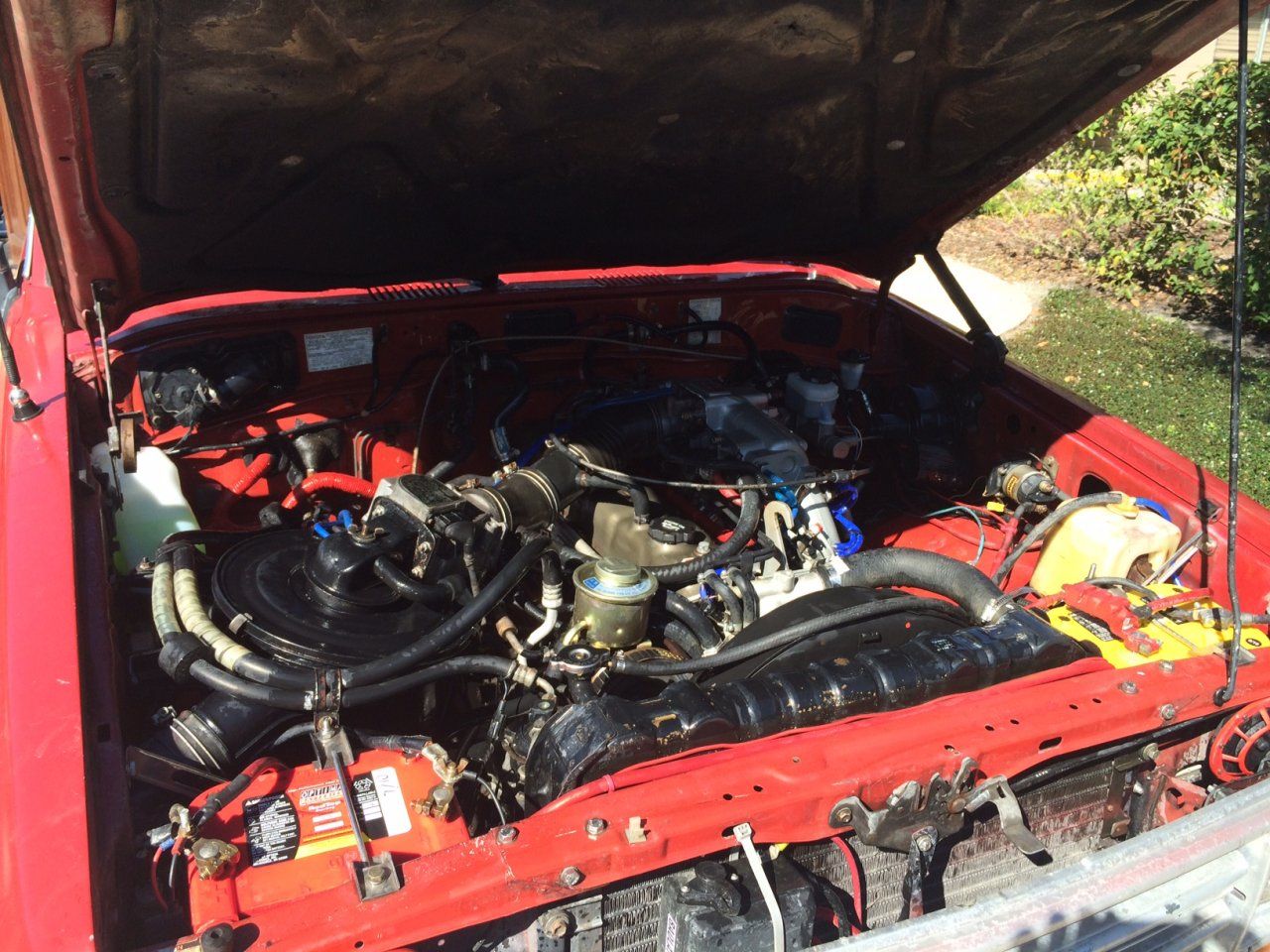

And I gave my engine bay a good scrub

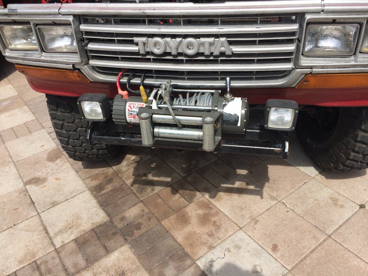

Pulled the ridiculous ARB safari roof rack
Got my spare rear axles cleaned and trail-prepped
Also wired the Hella lights I used to have facing rearward on the roof rack to the front

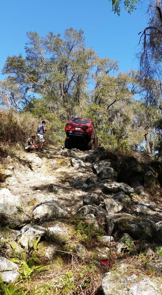

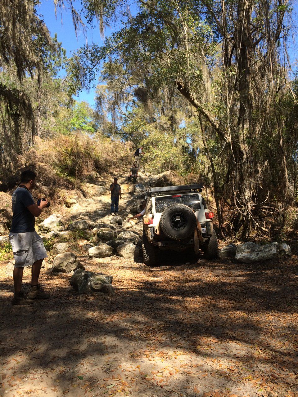

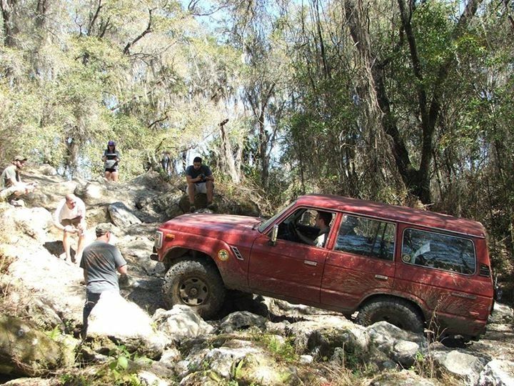

Then went on a wheeling/camping trip with the Florida FJ Cruiser club. We also had an 80 with us. My truck did awesome, runs good and does pretty well off road. Only got stuck twice, both times in mud , usually try to avoid that.
I was Mr. Old School the whole trip
Mostly red clay hill climbs and tight trails, there was this rock wall that only I and my crazy friend Scott with his white FJ went up. I made him go first lol
