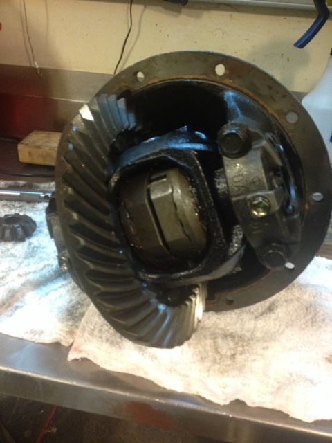

Also set up a Lockright in my spare diff. This is going in the front. Got an Aussie coming in the mail in a few days, that will go in the 80 series rear full-floater and under the car. Hopefully in the next two weeks.
Make sure that when you go around corners w/ the aussie in the rear that you don't hammer the gas. When I had on in the rear it was like riding a bucking bronco.
