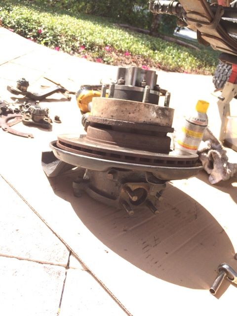

This is my first attempt at what is know as the "Camo" method of removing the wheel hub. It keeps the brake rotor and knuckle together so you don't have to reset the wheel bearing preload. Just remove the Aisin hub dial, outer snap ring, disconnect the tie rod from the steering knuckle, pull the upper steering arm and loosen the lower trunion bearing cap.

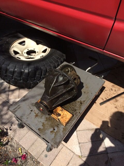

The "Hydraulic Table" from Harbor Freight fricken rocks. Raise it up to the height of the diff, slide the diff out of the housing on to it, lower it two inches and roll it out from under the car. I weigh 135 pounds, so maneuvering a 75 pound diff a foot off the ground while lying on my back isn't easy. I have done it that way however.
