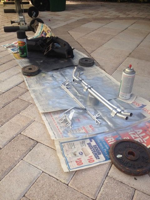

I've been painting everything with Rustoleum barbecue paint, comes out nice and dries super fast.

I just did my oil pan with the same paint in black. Worked pretty well.

Get the Rustoleum HIGH TEMP CLEAR and put at least one more coat on (I recommend 2 more)... it will make future clean up much easier.. The BBQ Paint HOLDS grease, mud and road salts and usually results in power washing OFF the paint to get it clean...
J
Thanks for the tip J, will do.
