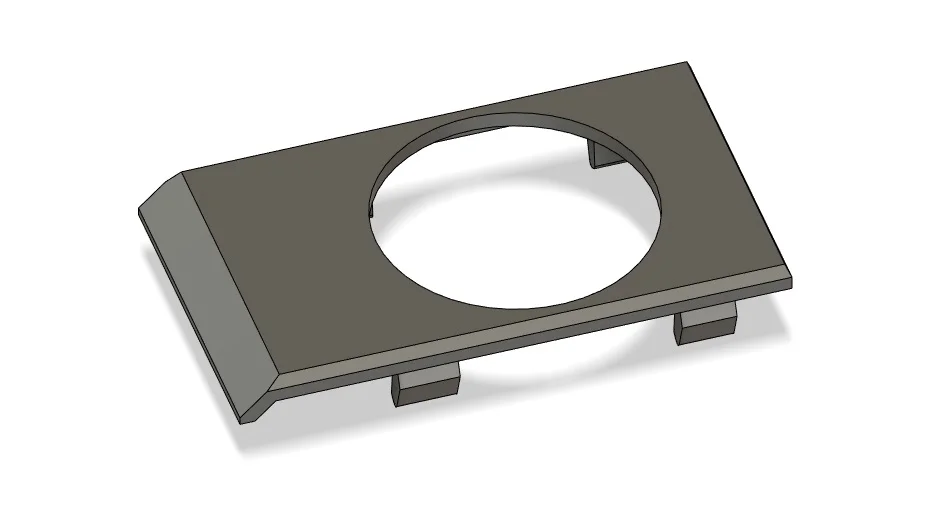

First of FJ62 Products. Switch insert that replaces your HVAC blank cover plate. Snaps right into place just like your cover, No additional hardware is required for this pieces. Sizes for aftermarket heater switches, Carling switches, Toyota Switches and a 2" gauge will be available very soon on my Etsy page! FJ60 Solutions by FJ60Solutions on Etsy - https://www.etsy.com/shop/FJ60Solutions
3D Printed in a UV resistant, Heat resistant, sanable paintable ASA plastic.
Switches are ressesed just like OEM to preserve that original look!

The Carling switches are either too tall or too thick for a smooth installation in the sandwich slot replacement panel, Currently hard flexing is required to install the instrument bezel which is not ideal for these brittle bezels. I'm working on a two piece version that will include x4 Toyota style screws in each corner for smooth installation and ease of removal of this new piece in order to prevent breaking any bezels.
Allowing the switch plate to be removed separately from the instrument panel will add some new benefits which include allowing the user to avoid removing the entire instrument panel to install new switches after initial installation, also It will allow the user to swap out the switch plate for one with more or less switch slots in the future easier to do.

Finally got it! install it once and never take out your instrument panel ever again! If you need to service or add wiring, simply remove the outer face and wallah! shouldnt be too much longer until its avalible, Just have to get hardware and yadda yadda bing bong.
Only question is should it have 4 screws or 2 screws? It will work fine with 2. But I think 4 looks better IMO

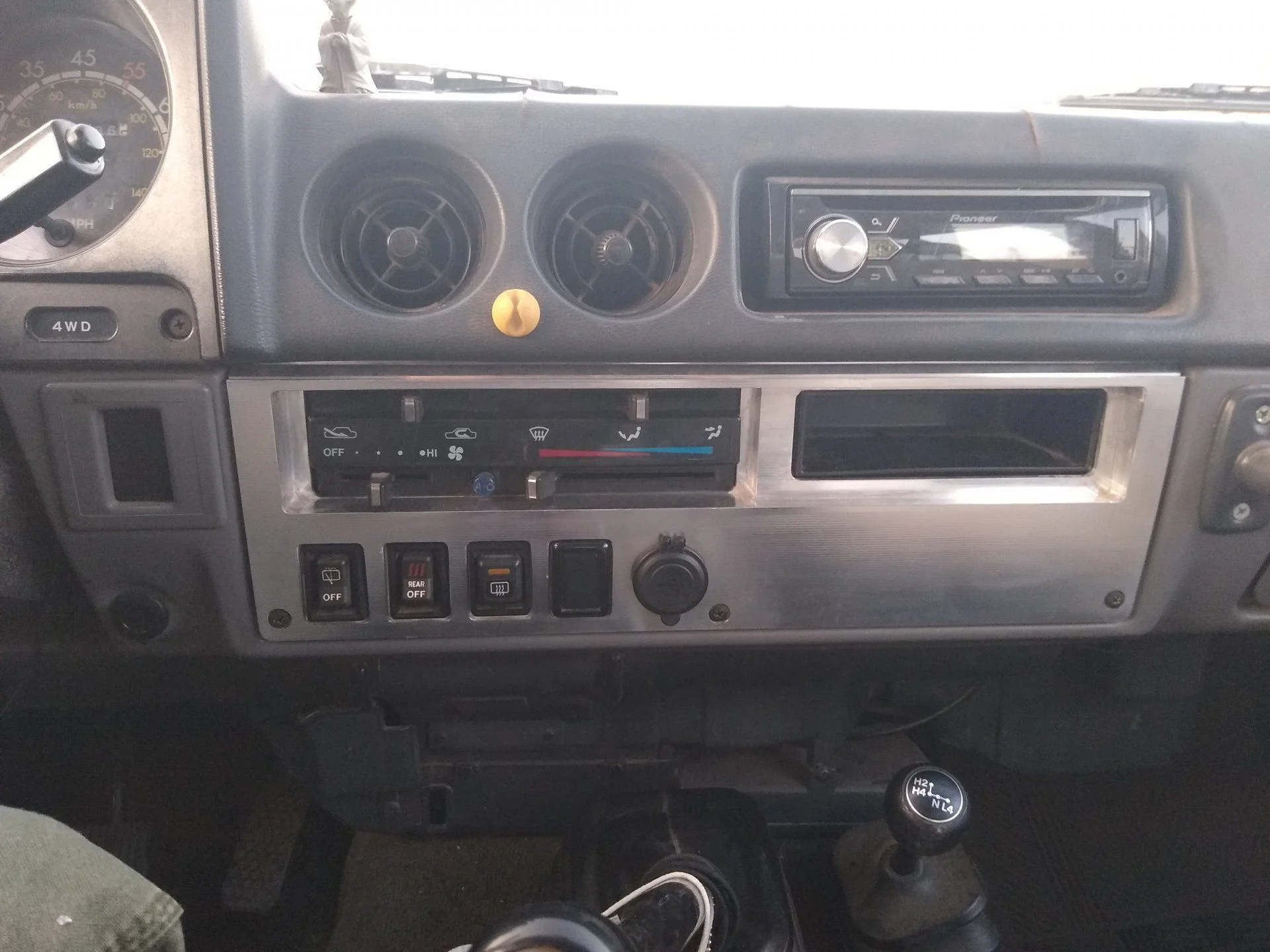

I found a late 70s Celica radio and it fits exactly into the empty sandwich slot, for what that’s worth. There may be other Toyota radios out there that are that size as well. Of course there are OEM inclinometers that are meant to fit in there as well. I bet the sandwich slot piece was fitted in there because the US wasn’t given the inclinometer as an option.
Otherwise - pretty useless, except for the party trick: put something in the sandwich slot and punch the gas pedal to watch it fly out and hit the center console. Works every time!
