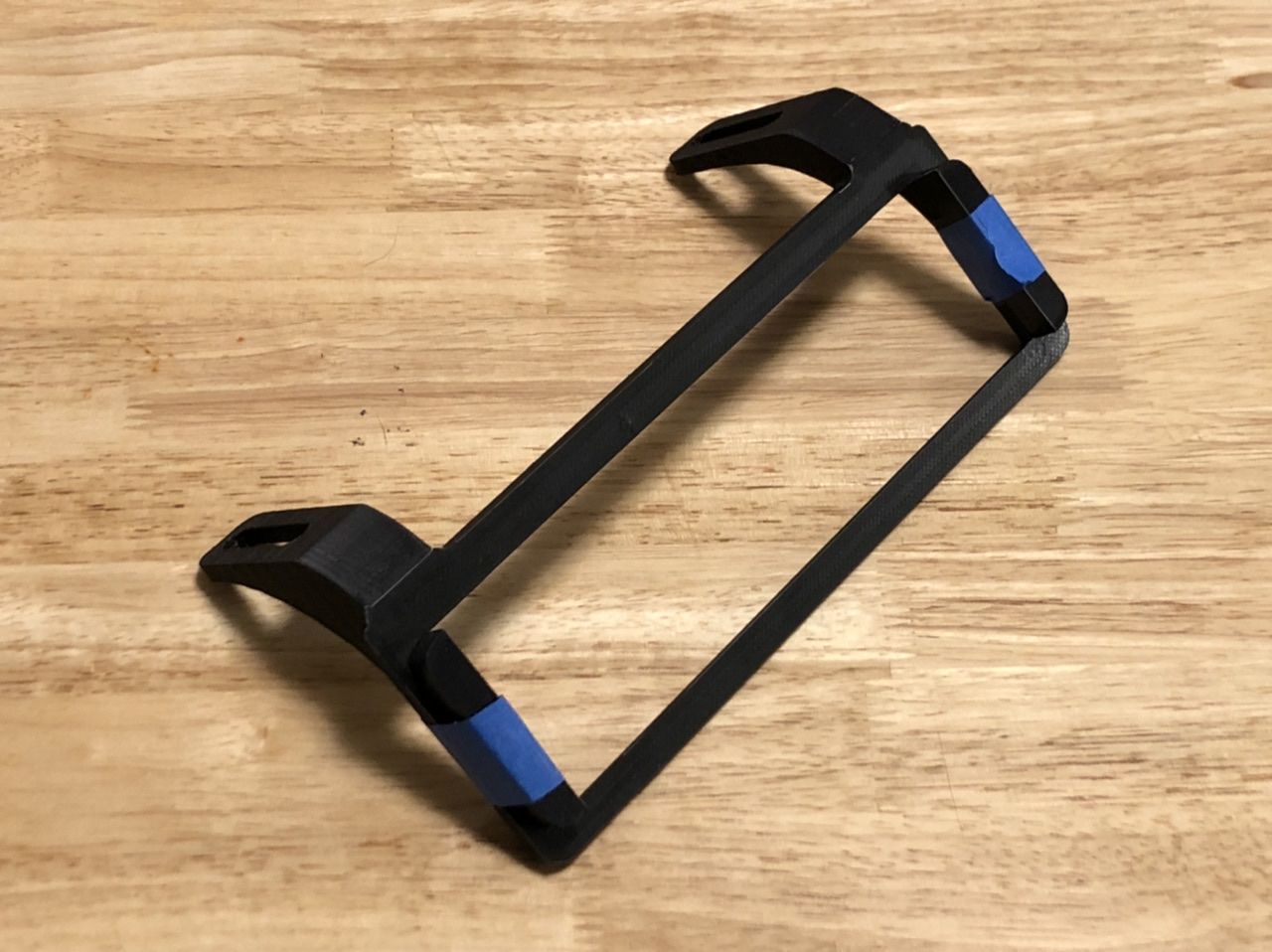

I just got my radio bracket today. It looks great and the instructions are a nice touch (although the instructions start with Step #3 for some reason). Thanks!
OOPS that's a typo. I copy and pasted these into two pages for ease of printing half sheet instructions, the numbering must have carried over wrong! Thanks for catching that!

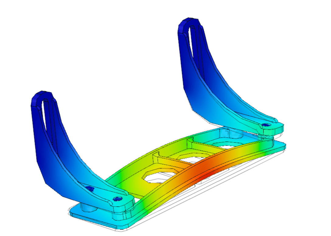

Thought id share the fun I'm having in my attempt to over-engineer this custom piece :)
I'm using Fusion 360's Static Stress analysis simulation to find and correct the weak, overly flexible and all other areas that are likely to fail from regular usage to make the strongest/material efficient product I can.
@buoytech this is your piece I'm testing, we're just waiting on hardware before its shipped to you.
In this image below the deformation is exaggerated so I can more easily find the areas of weakness.

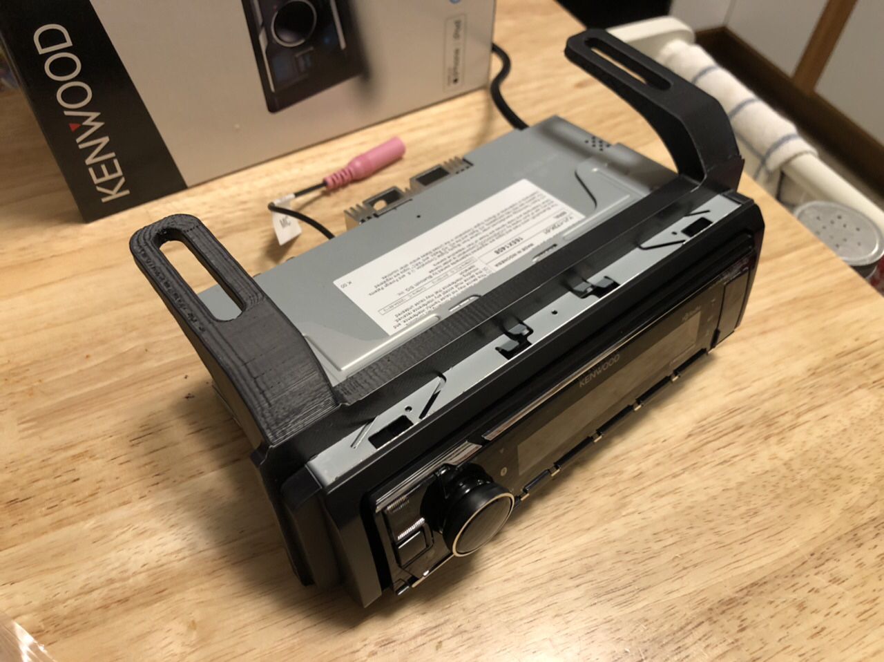

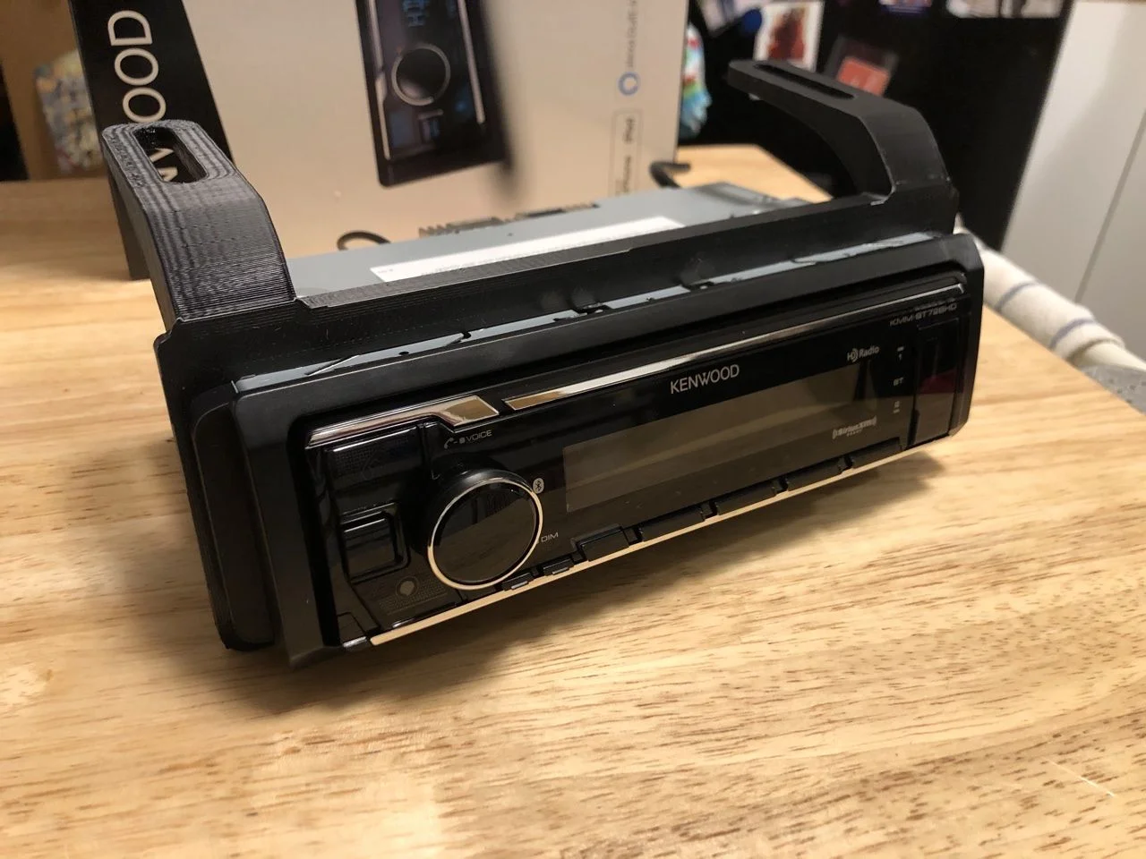

Got my radio and did a test fit. Impressive. The spacers are just there to bring it even further forward. They are installed in these photos just to show that. Radio is a Kenwood KMM-BT728HD. Digital media (No CD) for shallower depth.
Looks Great! Yeah the spacers help for accessibility and they allow the user to install the radios trim piece, the stock FJ60 radio slot concaves inward to where the radio trim wouldn't fit without spacers. Thanks for posting! let us know how the final fit is!:cheers:

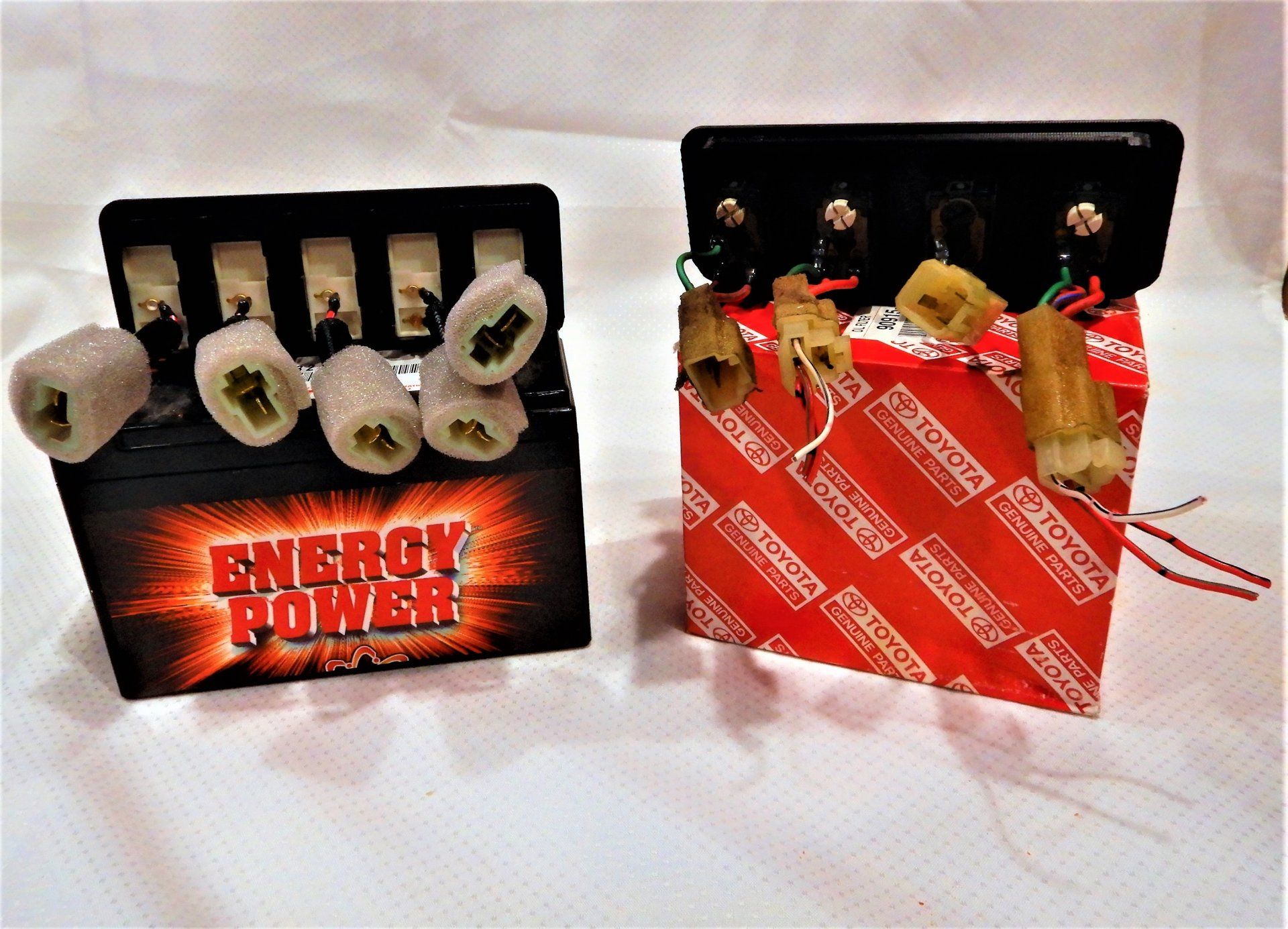

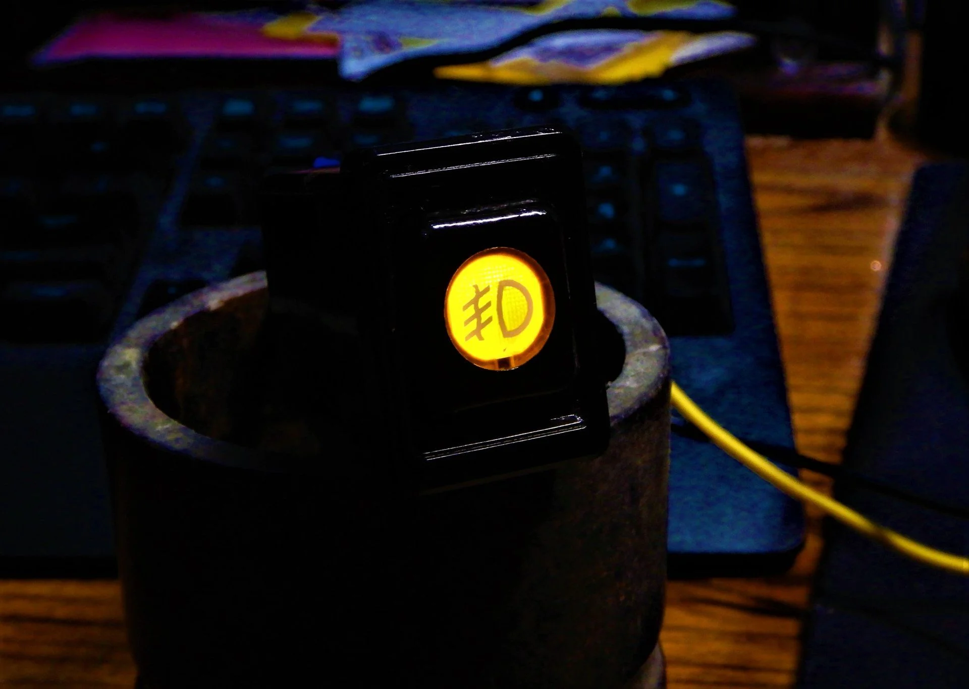

ok 8/80 - 9/87 60 series folks pay close attn. to this well deserved update here in @SgtChase 's FJ60 Solutions thread ....
this is sweeter then sweet , better then good , and well impresses the hell out of me personally so much i asked him if i could
have the privilege of taking some of the tri-pod digital photos for TOYOTA 4WD Owners Magazine article here in a
near future issue coming up ...... :)
so after he said OK , nature took its own path in my personal TEq world ..........:beer: :idea:
note:
to be krystal Klear this is ALL @SgtChase 's 3D digital art work , i only mounted the rockers switches and took photos , for any further info. or to pickup one of these PIPE DREAMS Turned Reality , please Contact via PM @SgtChase ...thanks !
