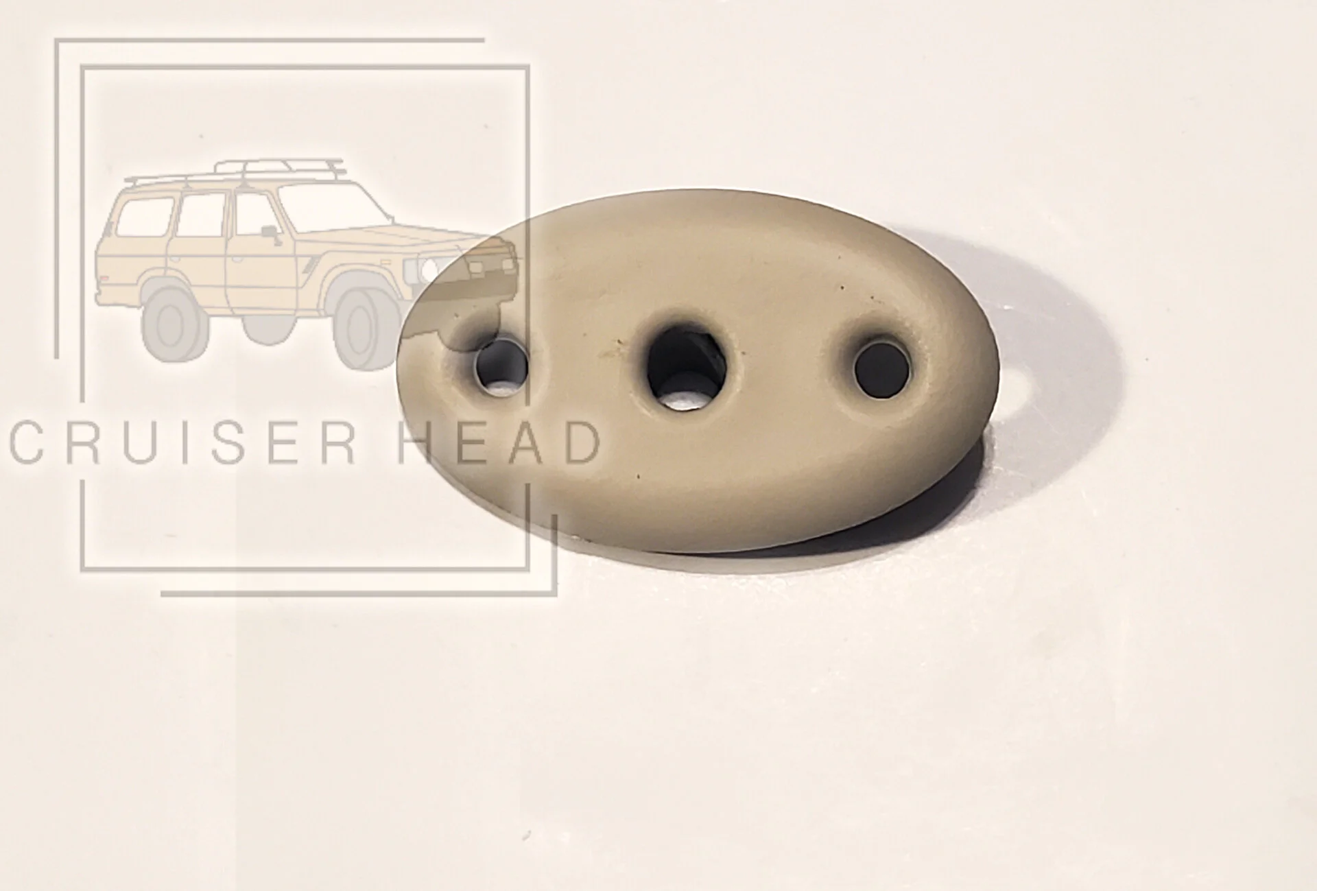

On the top left is a New hook from Toyota in black,
Top right is the same hook but painted to match the OEM color in the FJ60 as they dont come in the beige color anymore.
Bottom left is the OEM sun visor swivel base.
Bottom Right is my Reproduction swivel base.
I have the driver side swivel bases ready to go, Probably tomorrow the passenger side swivel bases will be done and ready to go as-well.

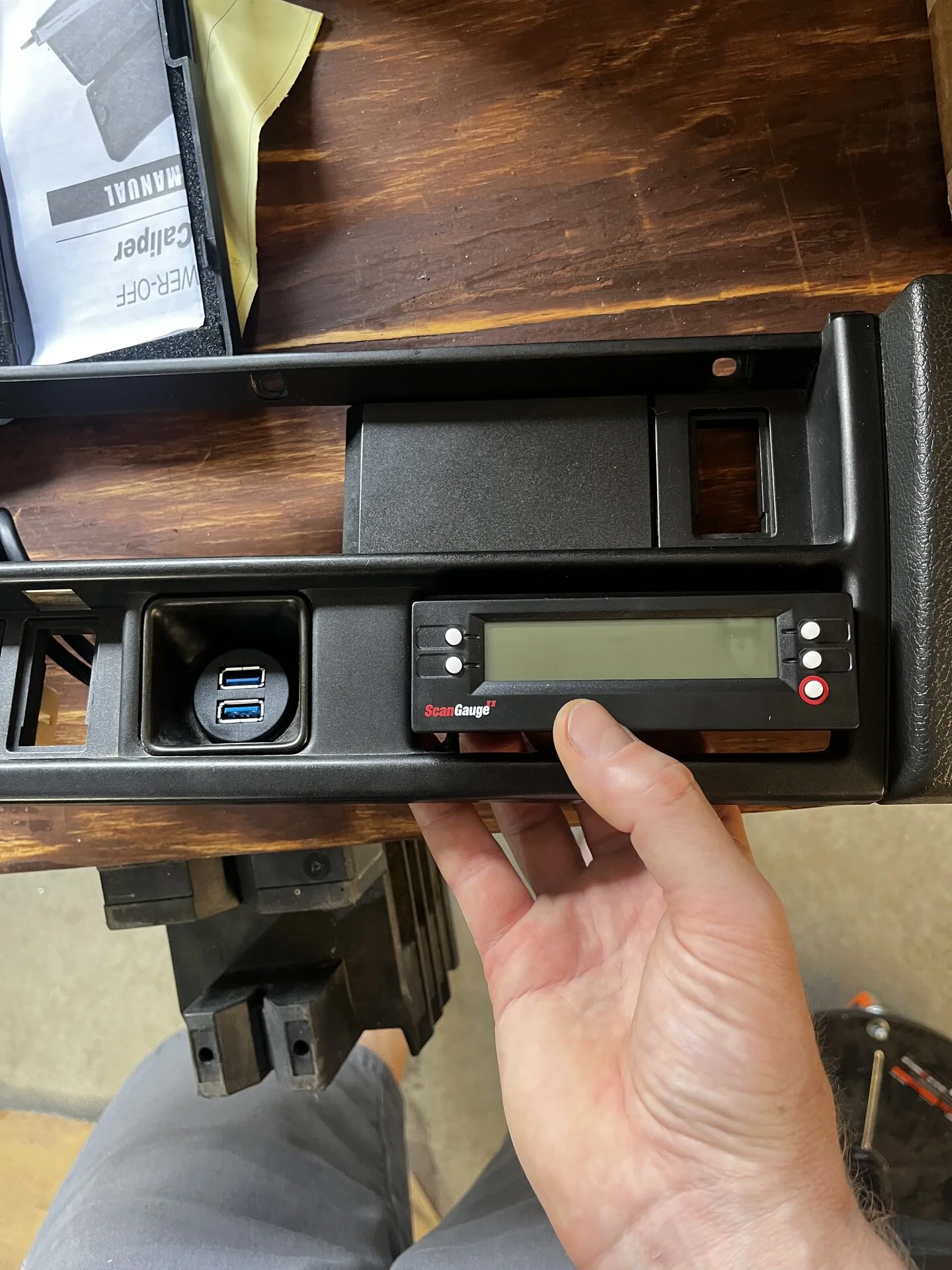

@ChaserFJ60 Have you ever looked into scangauge mounting solutions? I was looking at my never-to-be-used ashtray and thinking that might be a good spot. Fit is very close on my 62 dash. Happy to fund the design.

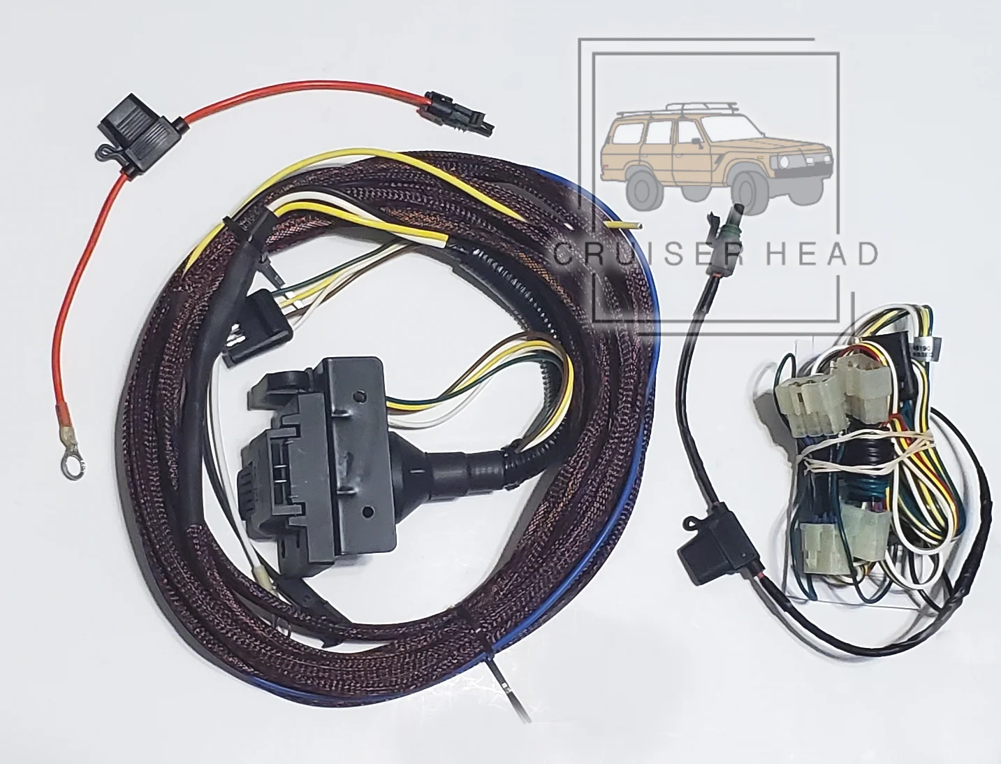

Ive been getting requests for more trailer harness's so here we go. I'm reordering supply's now to make more kits. All orders will be on back order while I collect the supply.
Claim your spot in line here!
This is a 100% plug and play system that plugs directly into your battery, It includes accommodations for trailer braking systems and circuit protection. Using only high temp GXL engine bay wire this heavy duty harness is easy to install, made for the DIY'er.

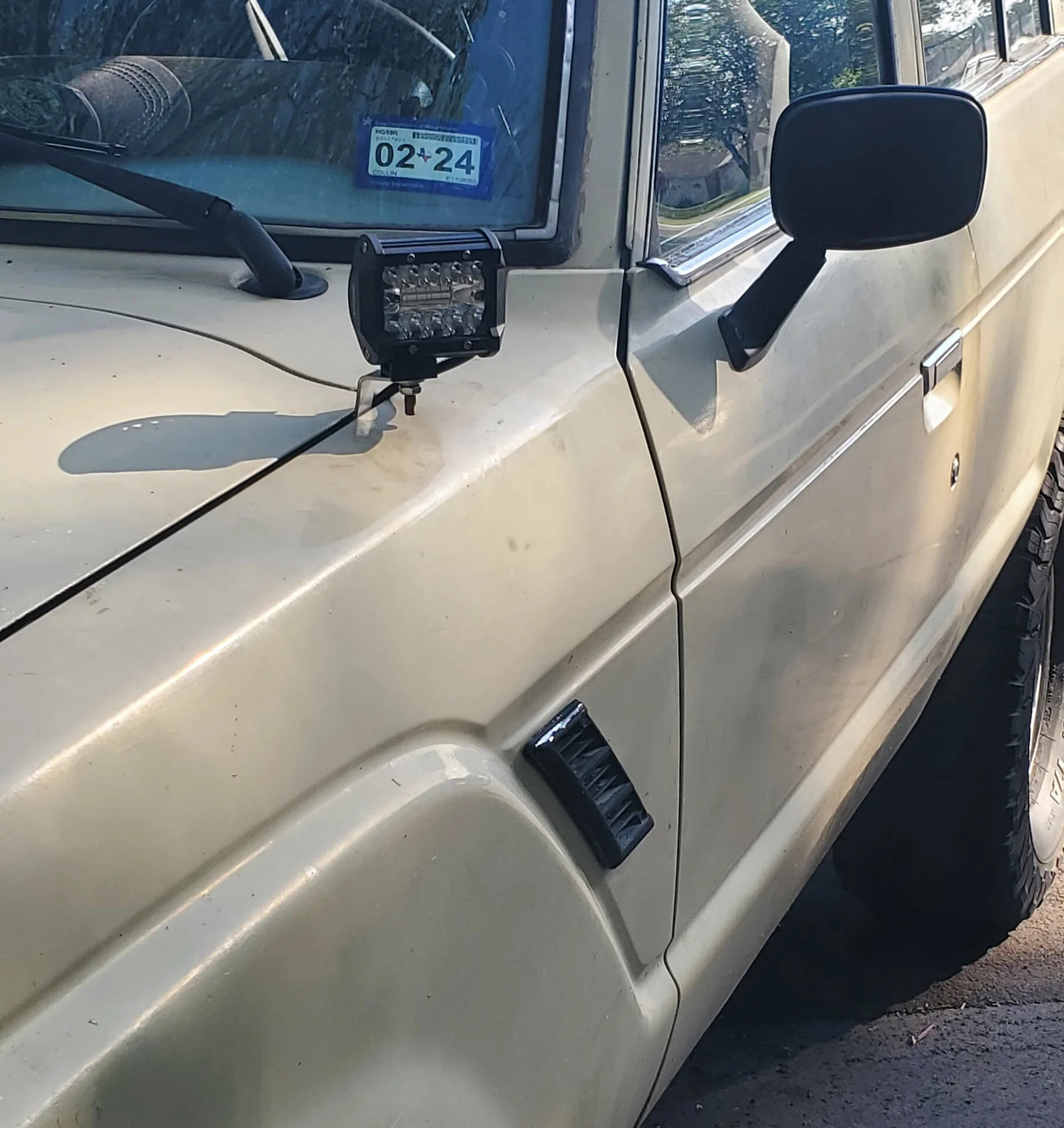

For those who dont follow my Instagram, Ive posted about these hood Light mounts. Well I finally go the first batch in today, and well every single bend is wrong.....
Here's a demo of what it will be. Eventually

For those who dont follow my Instagram, Ive posted about these hood Light mounts. Well I finally go the first batch in today, and well every single bend is wrong..... Trying to work with my metal supplier into getting this sorted out.

Maybe this time I will have to take the blame as I may have missed a small little detail in the fine print in my CAD design.... :flush: But I think they used a die with a larger bend radius, I think this was a multi person error. We'll see haha, its no big deal as this was just a small sample batch I ordered for fitment verification
@ChaserFJ60 the first batch of brackets I had fabbed for my fusible link replacement kit were very, very wrong, and I’m the one to blame. I know the feeling. I accounted for bend radius but totally biffed it on clearance for a hidden bolt head. That’s the way “R&D” goes though. “Why does your product cost what it does??” “Because I spent a ton of money before even getting to production!”
Anyway, those light brackets for new 4Runners, Jeeps, 200s, etc all sell like hotcakes. Every one of the new “overlandy” trucks in my neighborhood has those lights. I don’t see why you wouldn’t sell like 1000 of them if they’re production ready.

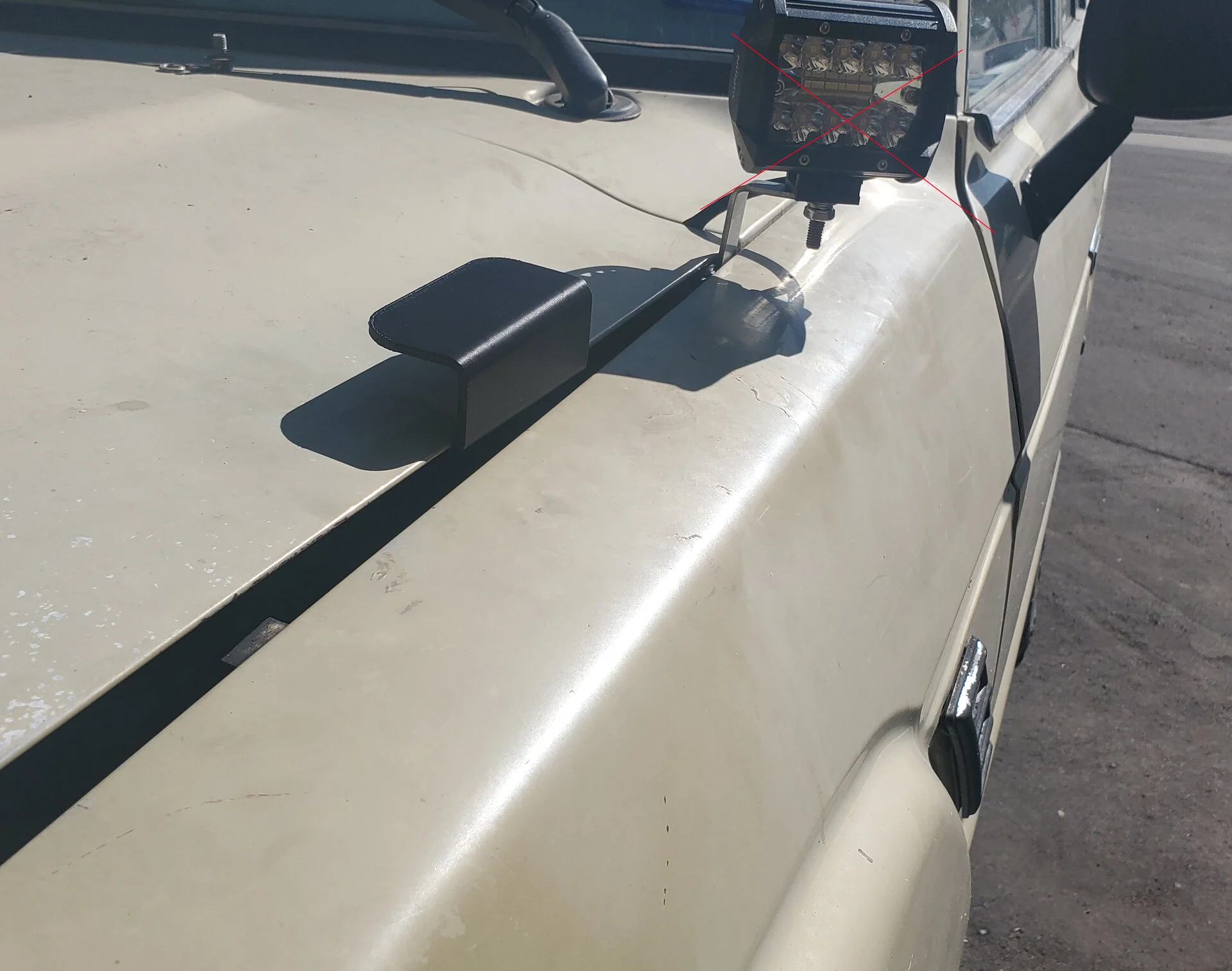

I'm test fitting a new bracket, It sits a bit forward on the hood but will move hood, allowing for larger lights to be mounted. Curious on anyones thoughts on a more forward mounted light, I know the popular option is to tuck it right into the A pillar but Thats not an obvious option for the FJ60. Hood gaps are tight and space is very limited. Is it a deal breaker? It sits directly forward of the radio antenna.
I'm stuck on two versions, One that mounts to the hood hinge, and the other option mounts to the hood support spring. The hood support spring mount may be blocked by the antenna and be too far forward for some peoples liking, The hinge mount so far seems to be okay, It will require that you readjust your hood and that the hood gaps are even on both sides... Anyone have any thoughts on this?
I would lean towards the hood hinge to keep the lights closer to the windshield. I’m pumped you’re making these, I’ve been hoping someone would make these for a while!

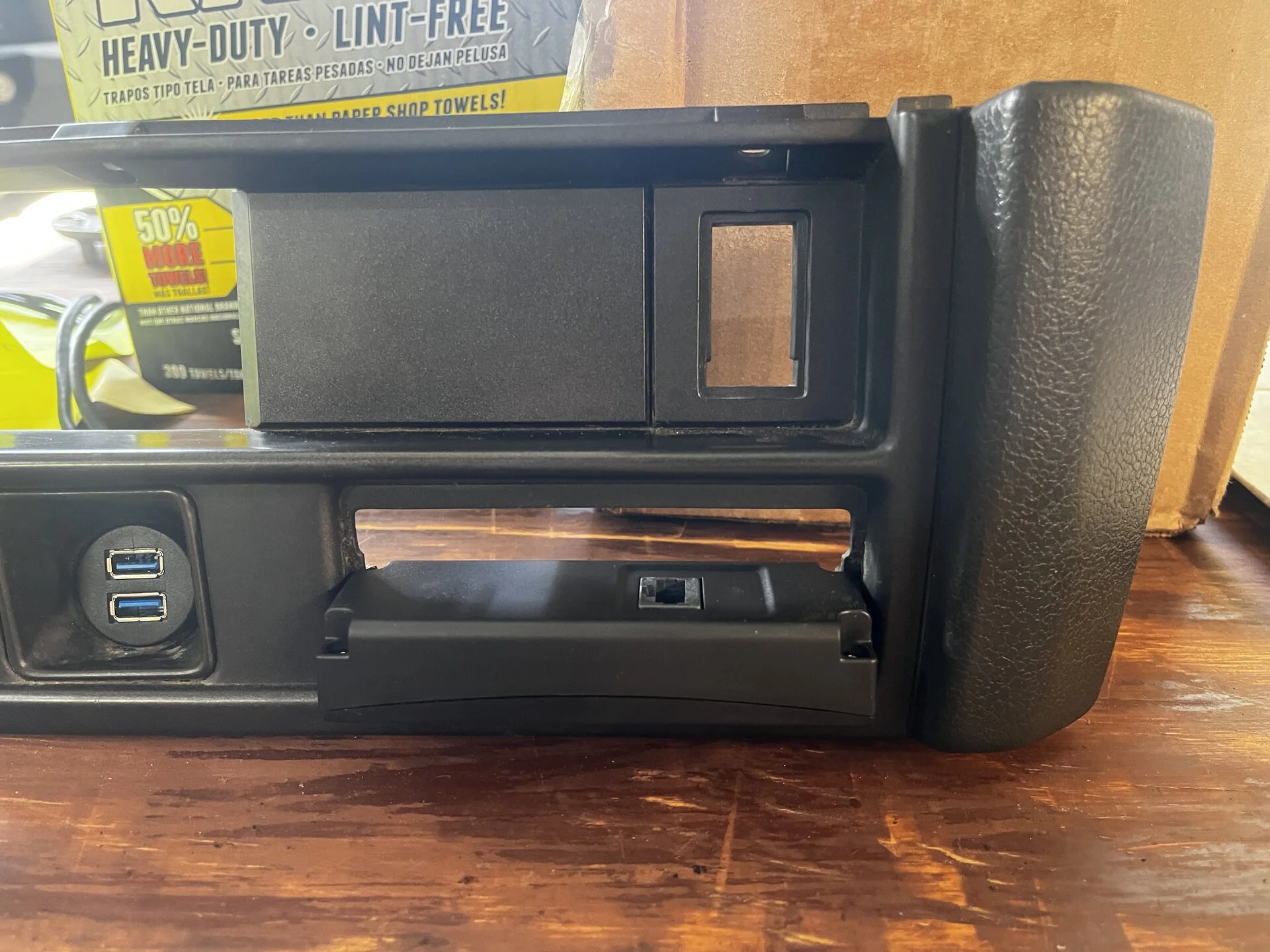

Its been a busy week, For some reason Ive decided to tackle 3 separate projects at once, Anyway here's the 3rd project, Dash pockets.
